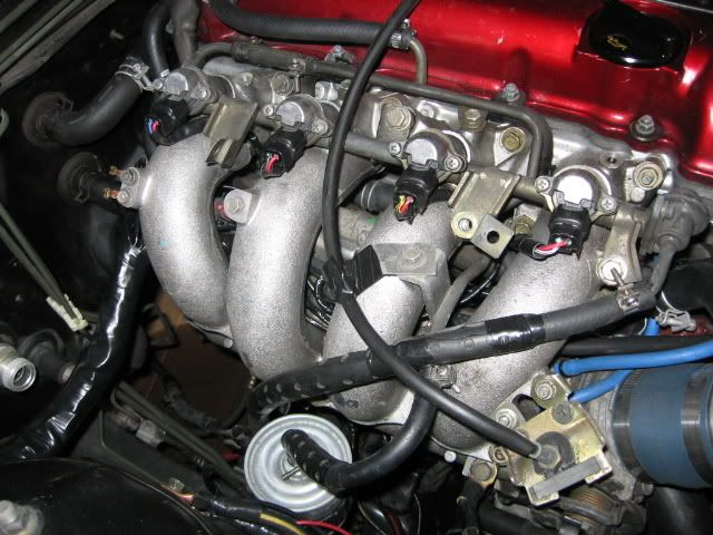

About the fuel lines in this pic he has the fuel pump hooked in the back and the other fuel line going to the front of the engine. Do you know if that is right? I got mine going the other way. How bad is it if it is hooked up backwards?

im new at this and i dont know how to put pics up. this is the website http://forums.nicoclub.com/zerothread/228716. it is in the middle of the page. there talkin about something totally different but it has a pic of his fuel lines.

Look at the pix. The supply line goes from the filter into the fuel raile like you see there. The fuel pressure regulator is the cylindrical looking thing on the fuel rail towards the front of the car.
The return line goes from the FPR to the return line on the chassis.
If you mix up these 2 lines it will not run.
