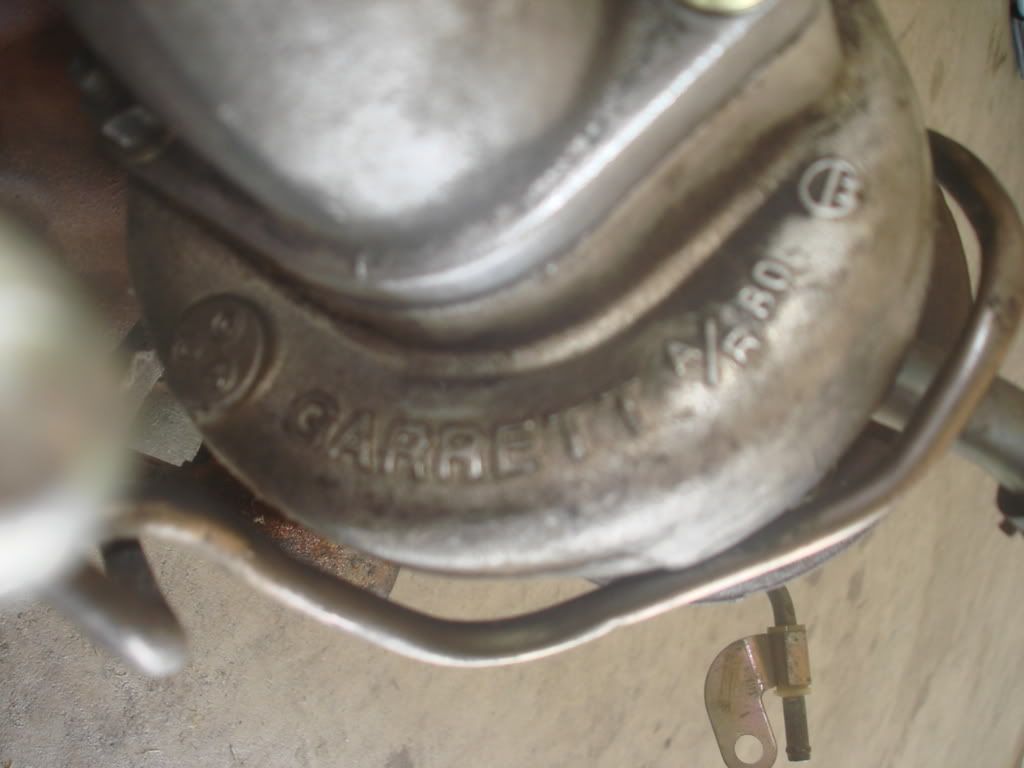

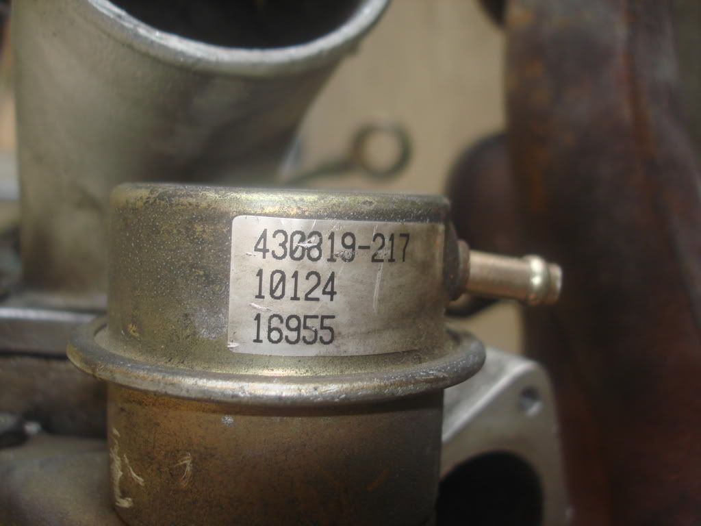

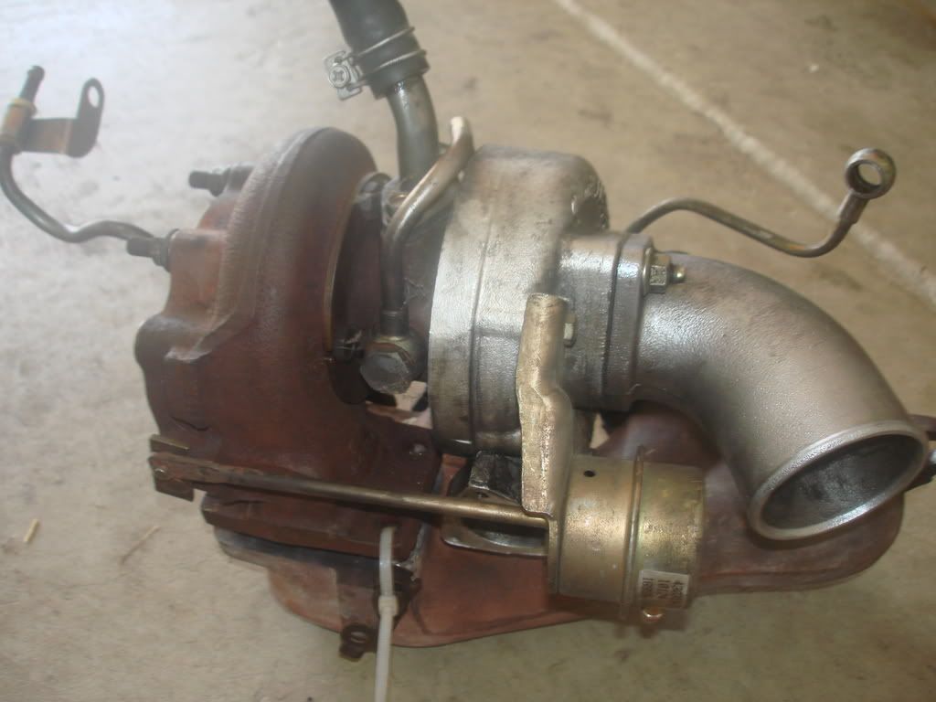

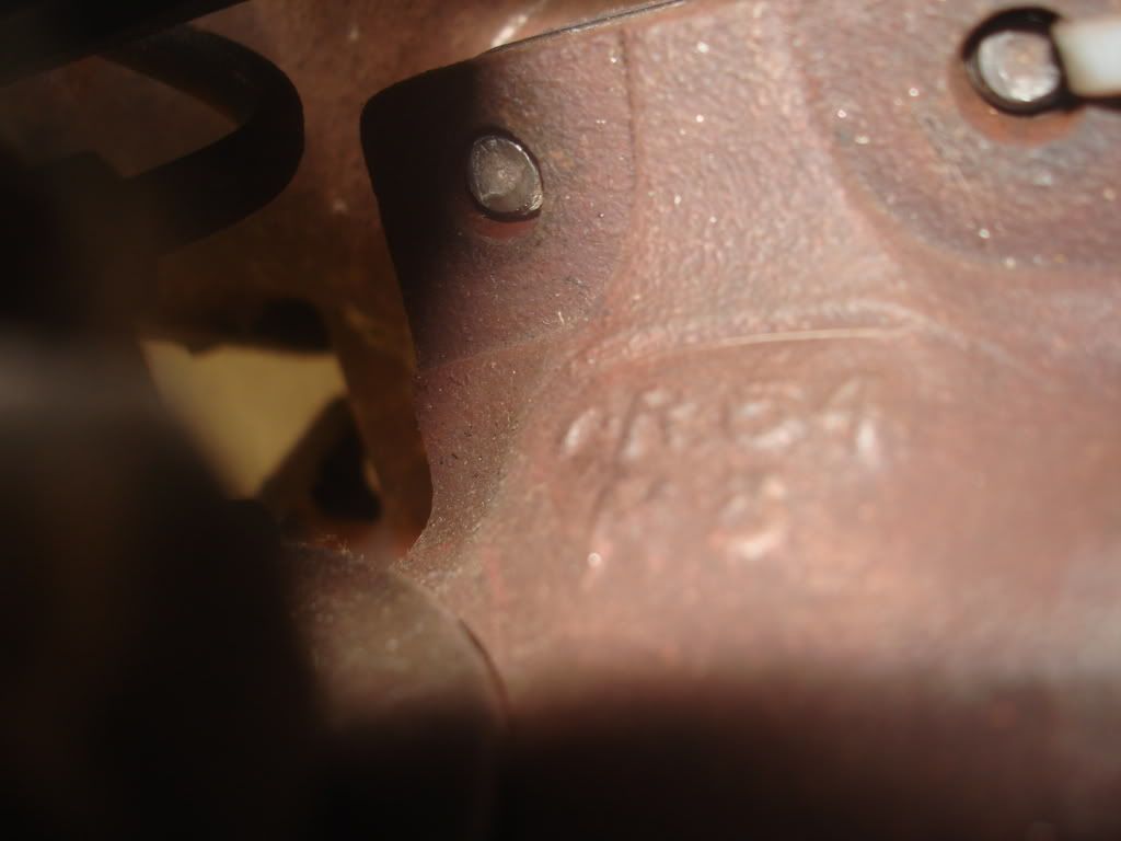

hey guys i bought an s14 sr20det and it came with the full swap incuding the turbo, i asked the guy what size of turbo is it and he said he had no idea but i asked some of my friends and they said that its a t3 turbo from a ford which is they said is smaller than t25 or t28 which i didnt believe coz it fits perfectly on the stock s14 turbo mani so im confused.. it says a/r.80 on the compressor housing and ar.64 on the turbine.. please help me guys here are the pics of my turbo:

A T25? The housing for the intake doesn't look clocked differently. anybody else want to chime in?

looks like the s13 sr20 t-25.

its a gtir t28. same one im running my car, its junk tho.....

does it also say .80 on the compressor and .64 on the turbine? you have any pics of your gtir t28?

looks just like my t25, nice and small..

T28 is bigger S14/15 T28 = .64 A/R turbine housing .60 A/R T04B compressor housing
T25 is what that is, why must you ask? T25 = .64 A/R turbine housing .80 A/R compressor housing.

You can tell it's a T25 off a S13 SR by the oil/water lines.
