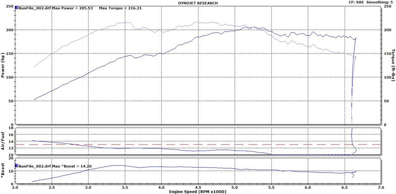

I have a Turbo XS dual stage MBC, and it can only hold about 8psi to redline. At the time of the dyno graph, I had it set at 14psi.

i have Turbo XS dual stage MBC. You think thats the reason im not able to hold boost? Sosideways my graph is similar to yours. Gotta find it.
