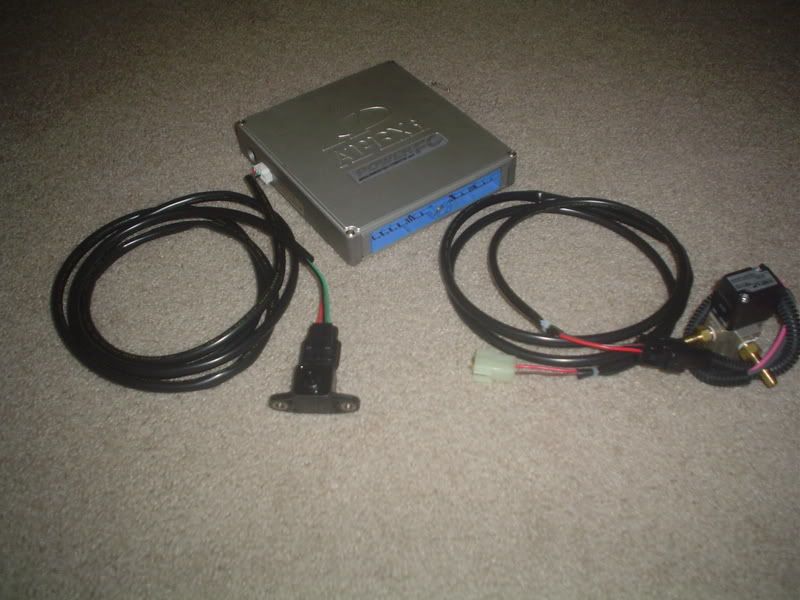

i'm trying to install a djetro power fc with the optional boost controller kit. the only problem is i don't know how to hook up the wiring for the boost controller since it doesn't plug directly into the power fc (i'm guessing the plug the solenoid came with was meant for the avc-r?). i've been coming up dry on all my searches so i figured i should post it. i have the version with the 5 prong plug from the pressure sensor with the extra two holes. i heard you stick the boost wires into those holes, but which one goes where? and the parts apex supplied me with doesn't seem to fit on the prongs on the computer. i'm so lost.

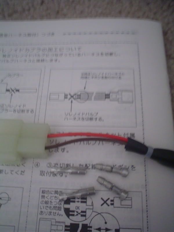

Instructions are vague they tell me to connect this shit but they dont really tell me how to wire it. It tells me I have to cut the Solenoid valve harness and insert some QD's but I dont understand why i have to do that.
Its kinda sounds like I have to splice in another connector but Its a "KIT" it should come with everything, why would I have to buy some other shit?

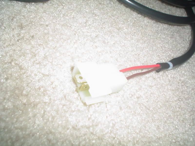

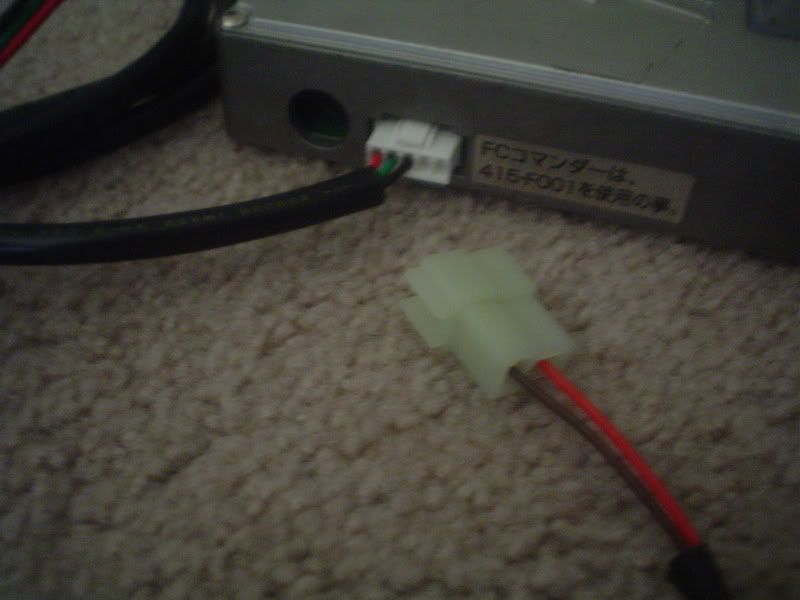

Solenoid Harness Connector (Where the hell does this go?)
It would make sense to wire in to the pressure sensor connector but they dont give me any connectors to install in to this plug
Why the hell do I have to do that??? (It says it doesnt matter which way the wires go)

Ok Well I just had an Epiphany after reading a thread on The Nissan Forum's.
Do i splice the Apexi Solenoid Harness in the Engines Stock Waste Gate Solenoid wire Harness???
Make sense seeing that we still use the OEM engine harness....

That picture on the top is definately telling you to cut the connector off, and the bottom one is showing that the polarity doesnt matter when you splice to the new connector (which im sure is explained in japanese there)
have you called apexi? they are pretty helpful.
It is, My wife read me the whole book.
They dont come out and say splice this in to the Stock Engine harness.
