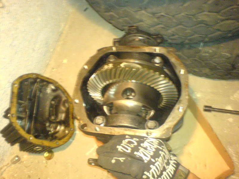

hey i have a 1997 240sx shell and i wanted to know if the diff is vlsd or how you can tell. its an SE model if that helps but i want to know if i should pull it for my s13 or just bail it if its open diff. any info helps, thanks!!

To be 100% sure crack open the cover and see if this is inside

YOU SEARCH... Just kidding lol. Do a burnout and see if it leaves two lines, jack up the rear and spin one tire if the other tire is spinning the same way its LSD. Easiest ways

NOT all SE had VLSD or moonroof.
Simple way to check if the pumpkin is VLSD.
Turn the output shafts, see if the other side turns in the opposite direction, it's VLSD.
If you turn one and it spins freely and the other side is stationary, then it is open.
