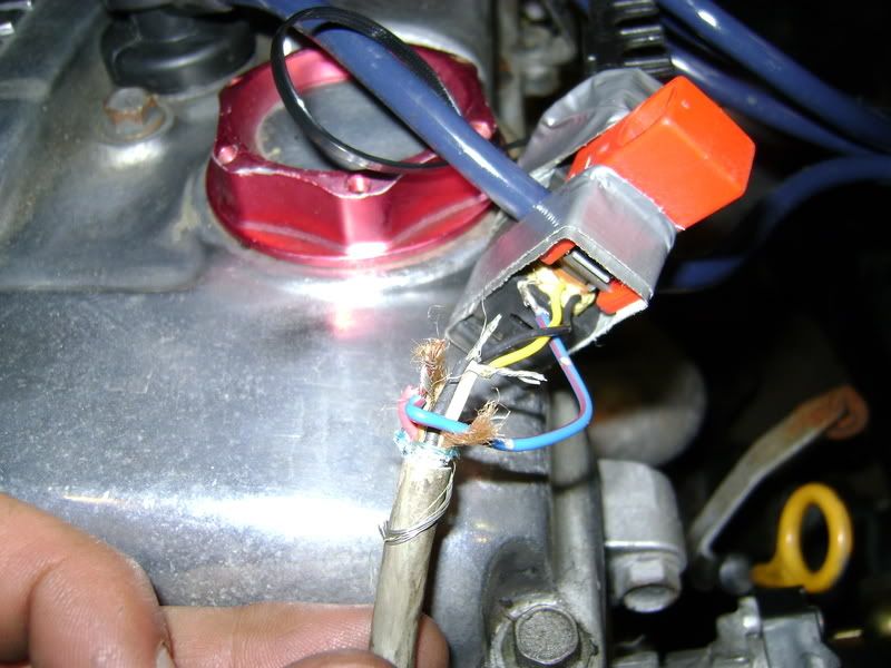

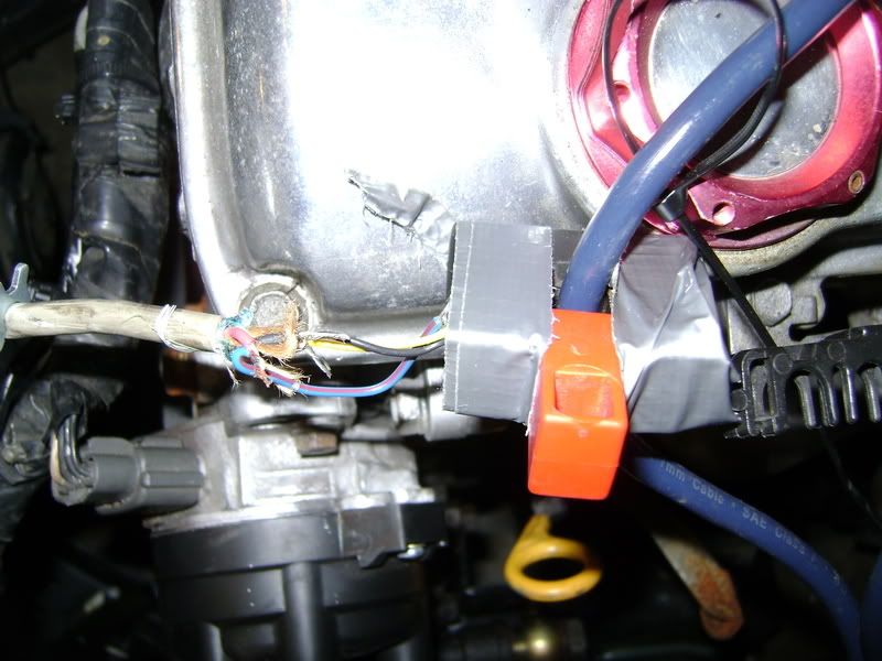

So I am trying to time it today and first of all the timing gun was broken, looked fucking sabotaged after my buddy nick opened the end that goes around the wire, so we did a quick fix lol:
but the idle wouldnt stay down and we were still off although we got it to rev smooth and shit, under load it had nothing.

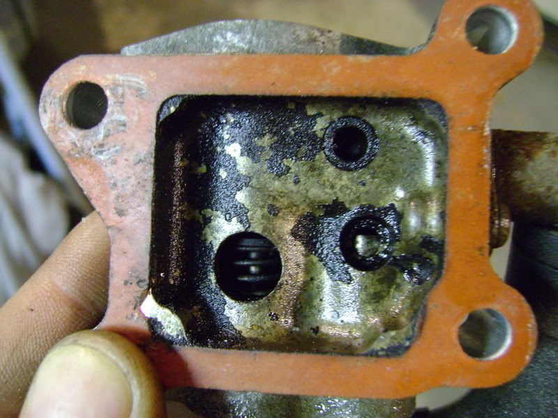

Started to pull the AICV, looks fucking nasty, its soaking right now, but the solenoids were good:

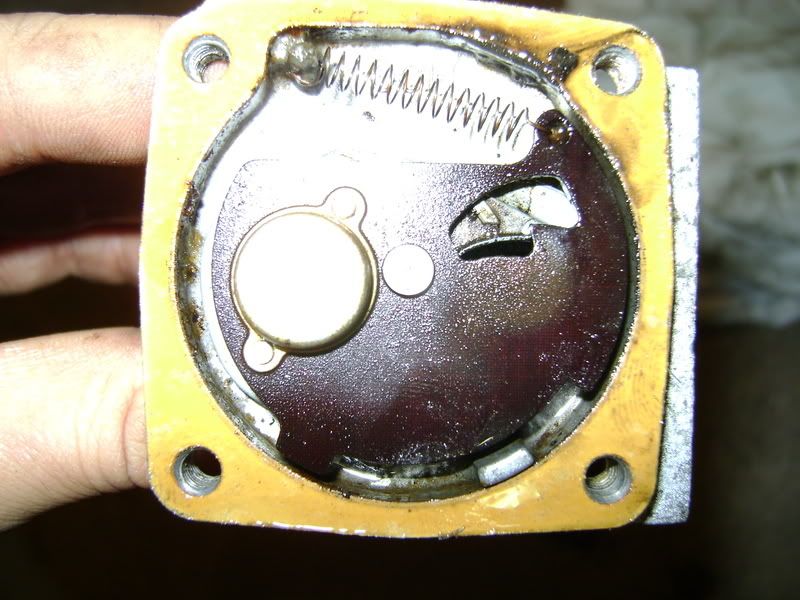

Pulled the air regulator, opened it, checking it out, wondering if maybe this spring is shot and its no longer holding this flap well enough, decided to test the solenoid, and lo and behold hte fucker was no good. I hate this thing:

So I am going to get a new one tommorow and hopefully put it together and be good to go tommorow night. I see one in Hawaii on ebay for $30, he says the dealer price is $81, im hoping my hookup at napa can get me this thing for cheap.
