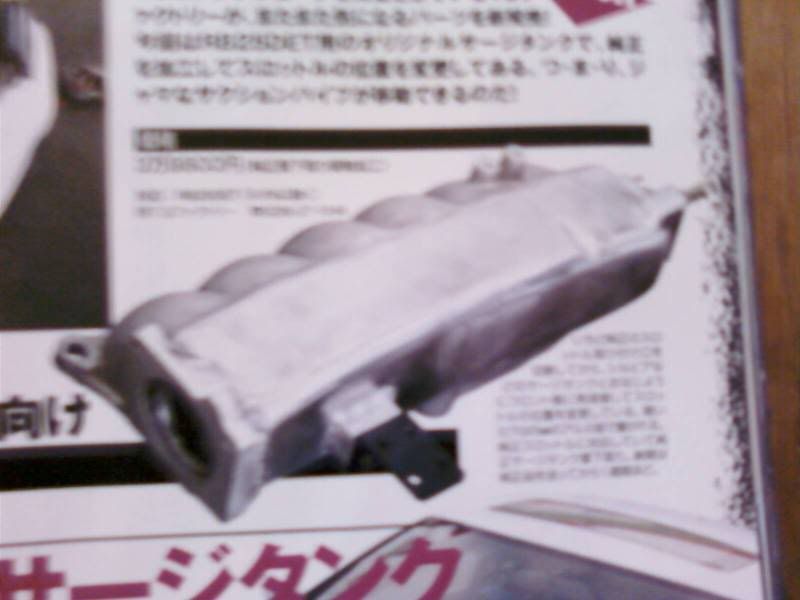

Well for those of you who dont like the cross over style of the RB intake Mani.
I found a cool little artical in one of my Option Mags
Sorry i dont have a scanner lol
Definatly cleans up the engine bay real nice

so whats the price? who makes it?
it looks like the stock one was just modified.. cut and weld. pretty good stuff though.

Seems to me like the stock setup would distribute the intake air more evenly across all cylinders.

I would be concerned about air flow to the back cyl. The design of the manifold is to distribute air evenly. People running this would find their back two cyls probably running lean, possibly even the 1st cyl.
I mean, if you are really concerned about just having a cleaner engine bay. :shrug:

should be fine. thats a good idea. if you were really worried about it you could always put a taper on the back of the manifold by the back 2-3 cylinders.
if i had an rb i would do this without any worries for sure.

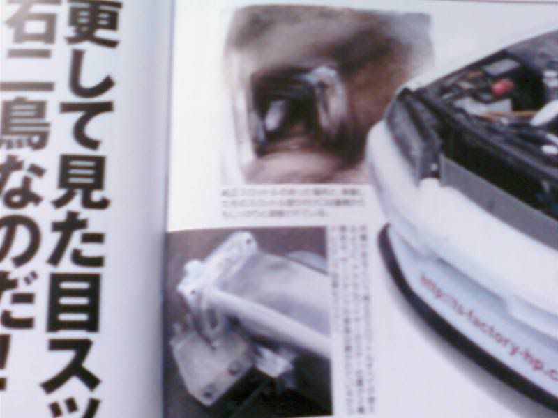

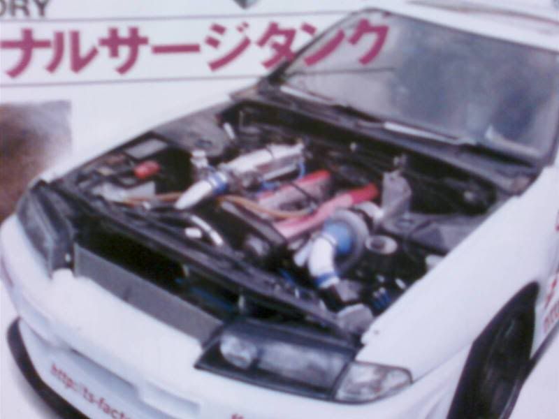

the back is tapered. look at the 2nd and 3rd pics.

Well, it could and most likely would. As it will create a turbulant pocket of air that will create a lack of flow into the last 2 cyl. and it's possible the 1st cyl will see most flow blast right past it.
The amount of work done to creat this manifold (cutting, new material, welding, etc) you could create a properly designed one as well.
There is no taper in the pictures.
Here is essentially what this manifold aims. There are no velocity stacks in the RB20 Manifold, and it has 2 extra cyl. however the principles are the same.
With just a bit of taper you see improved results here.
And the best results when angling the TB placement.
and

It's not, i've owned a few RB25. The lower section has different length foward and aft runners to merge neatly at the upper manifold.
