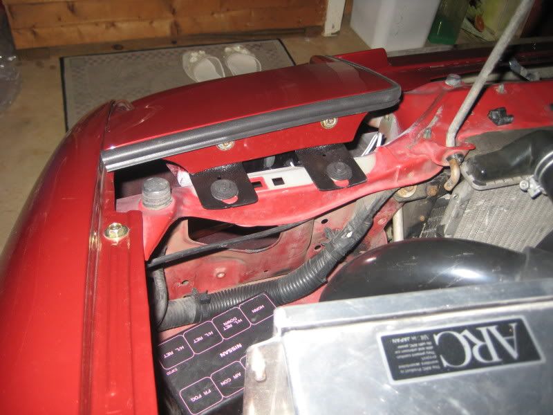

Okay,
I've tried different methods on how to mount these things lol. So far, i've done epoxy and two metal bars to hold them up. So far so good, but the epoxy just gives after a while.
Anybody else have these installed or can point me in the right direction on how to properly mount these so they dont move please.
Thanks.

I just took some pictures. Hopefully they'll help you out

Thats funny because i was going to message you as i saw your thread hmm..
and thats all you did?
and is that like weather strip or?

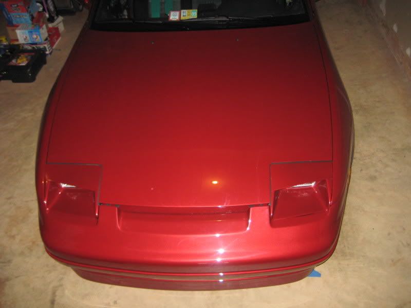

That looks amazing, I like that weatherstripping thingamajig you did too.... awesome I want some now lol! Are these FRP?

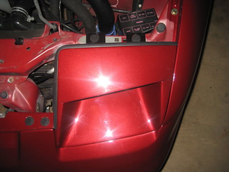

Yep thats the only thing I did. Keep the holes on the brackets slotted to allow for adjustability.
Yeah its weather stripping. It allows for a water tight seal:

moar pics from the front

on the first pic, whats the two bolts hold on the left of the light...
