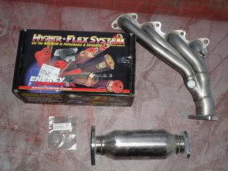

s14 headers
will they fit my s13 ka24de ? my homie is giving me his

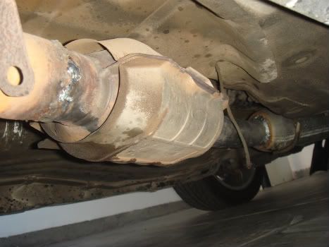

and also i was gonna buy my homies hks catback but this is what i found under my car
rusted and welded from the headers down to the tip =[

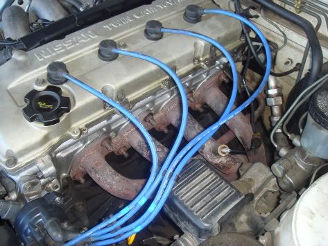

heres how bad my headers are
am i losing any power from this setup ?

No it won't work. What you pictured is just a collector. It mates up to the stock downpipe, or whatever. Being you don't have it, it won't work. Also, being that the OEM piece is tiny, it would produce no gains whatsoever. Furthermore, if memory serves me right, the S13 and S14 downpipes are slightly different in length. Last, your S13 has the AIV system, and S14 does not. This also presents a problem.
Get a real header. I have a DC, and I love it. A friend of mine has a newer Megan Racing header, and his sounds really good. I like it better than my DC in terms of sound
