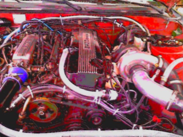

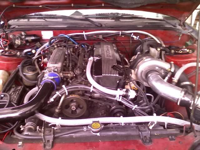

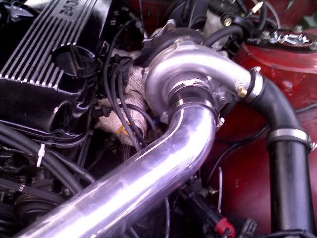

hey this is my FIRST TURBO build. its a very mild build but i came into some trouble.to make things short and cut to the point i need some help to finish my ka24et. sohc. im in the end process of it and just need help tuning etc. my hp goals are 200-250.
mods are.
t3/t4 turbo
external wastegate
log manifold
2.5 downpipe
stock ecu,injectors,maf
2.5 intercooler piping

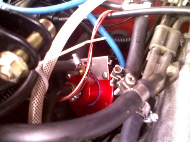

12:1 FMU
Walbro 255lph fuel pump
greddy type blov
ebay fmic
egr removed.(not all emissions removed b/c i live in cali)
ngk spark plugs
stanza electric fans

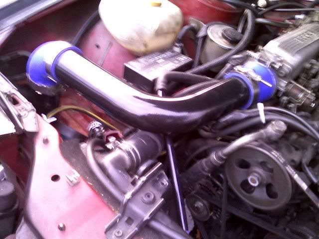

now i need to change my base timing a few degrees. and find out why when i press the brake pedal my engine sounds starved. i have the boost gauge and bov in the brake booster vac line.i idle about 750rpms and my boost gauge reads 20hg.when i press down the pedal it spongy and goes all the way down. it sounds like my engine is about to die and sometimes it does when not warmed up. i also want to know what is the procedure to change base timing on a sohc. i've search and no results. im not experience in tuning and would like to know if anyone can help me out. anyone here local enough with good turbo knowledge please help me out. any other comments on build if constructive is nice too. thanks all. excuse the ugly phone pics.

Agreed. Upgrade the injectors please, you'll run out of fuel way before you can really hit boost.
As far as the engine stalling, you should NOT be pulling vacuum from the brake booster line. There's a check valve in it that won't allow bypass air to travel back through to the intake.
Use one of the spare ports from the EGR to tap vacuum signal, you want it as close to the throttle body or after (but not on the booster). There's a couple small ports for the charcoal canister too that will work fine.

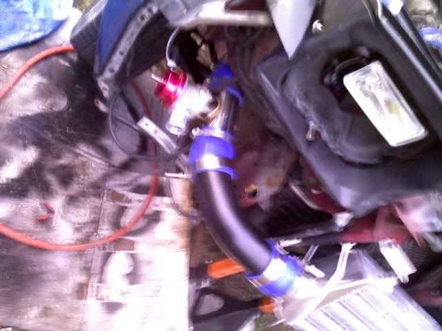

Also your blow off valve is not recirculated, therefore because KA motors run off a MAF ( Mass Air Flow Sensor ) all air that enters the intake system is metered. When you do not recirculate the blow off valve the air that gets released when you let your foot of the pedal causes the car to stall and or hesitate because the ECU thinks the car got a certain amount of air, when in fact it got less. Unless you compensate for the lost air due to the blow off valve you will have constant stalling and hesitation issues. An SAFC can compensate somewhat for such a loss using decel settings, however no tune will be able to fully tune it out and as a result you will always have slight issues in such a system.
For further help with tuning and setup I recommend checking out: www.ka-t.org as they have extensive experience and lots of users running similar setups.

heres a video of my problem. bov recirculated. and i searched on ka-t.org and they say its fine to get vacuum from my brake booster.

take the bov and boost gauge off the brake booster vaccum line and see if that works. that seems like the first thing you should do.

No matter what someone else said, it's apparent the brake booster source is your problem if it's stalling when you brake. Think about it logically.

stock injectors with FMU = ticking time bomb.
that FMU will push 12 psi of fuel pressure for every pound of boost.
If you think of it mathematically...less than a Bar of boost, you can be "trying" to push over 100 psi.
There is psi from the OE Fuel pressure regulator as well. I would say like 6 or 7 psi would easily be over 100 psi.
*tick tick tick tick tick

He doesn't need injectors or a tune lol. Running FMU and stock injectors is plenty safe and good for a first project. There isn't room for expansion, but it will run fine.
Don't listen to them. But I would agree with the others about your vacuum source. Trying to switch it to a different spot can't hurt.
