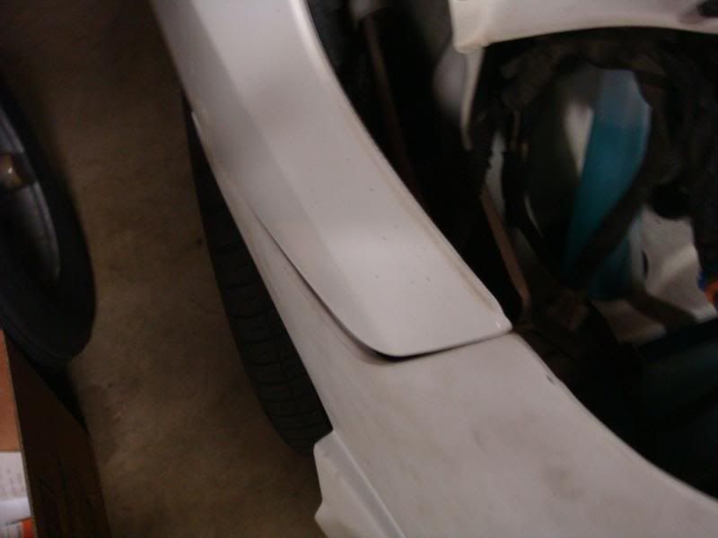

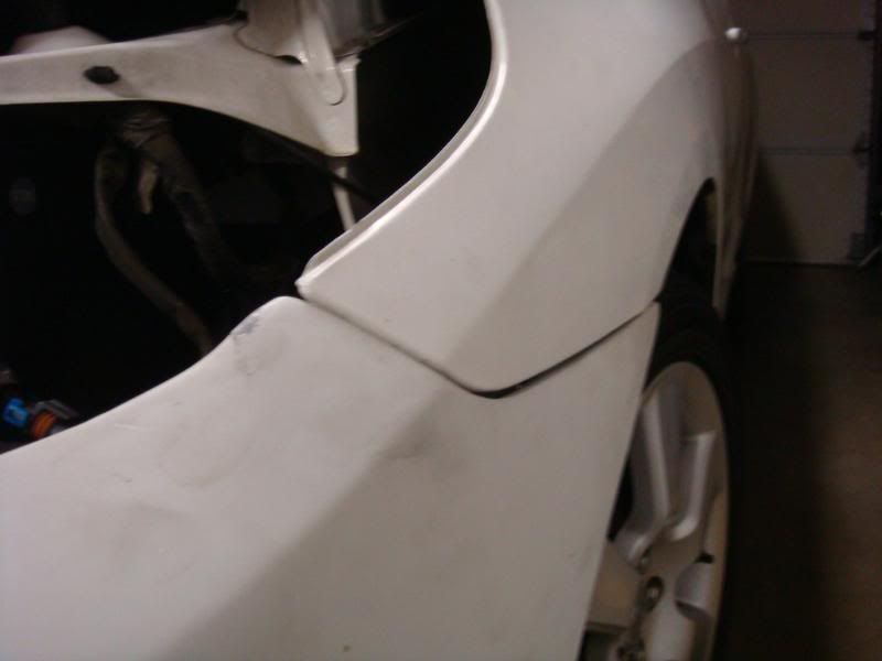

Before
The bumper had several issues.

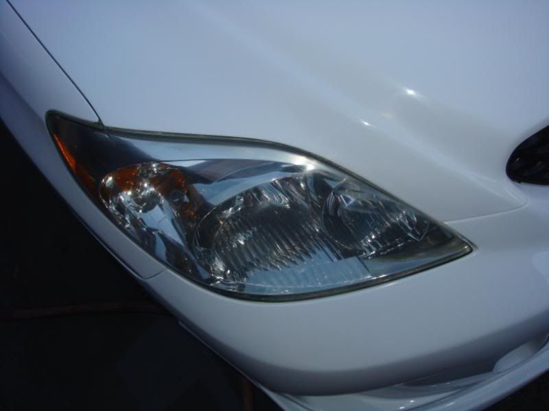

1. The edges where the bumper meets the fender did not line up poperly
2. The bumper was made to wide for the car.

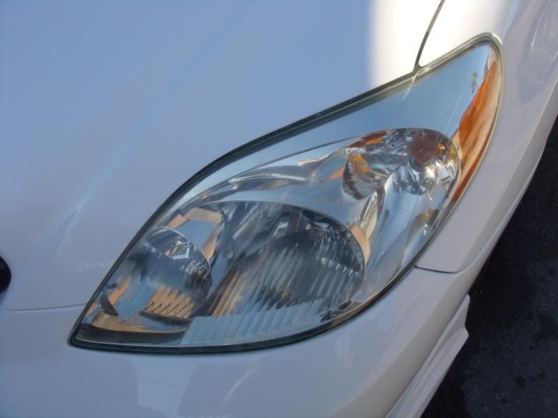

3. Area around the headlamp were uneven with huge gaps

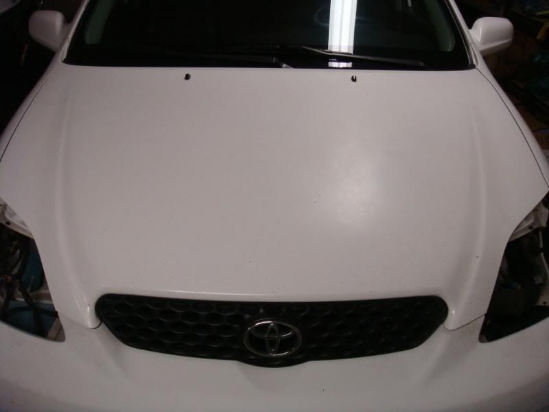

4. the area around the grill was uneven with huge gaps
5. The finished surface of the part look like a ocean (waves)

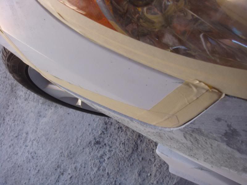

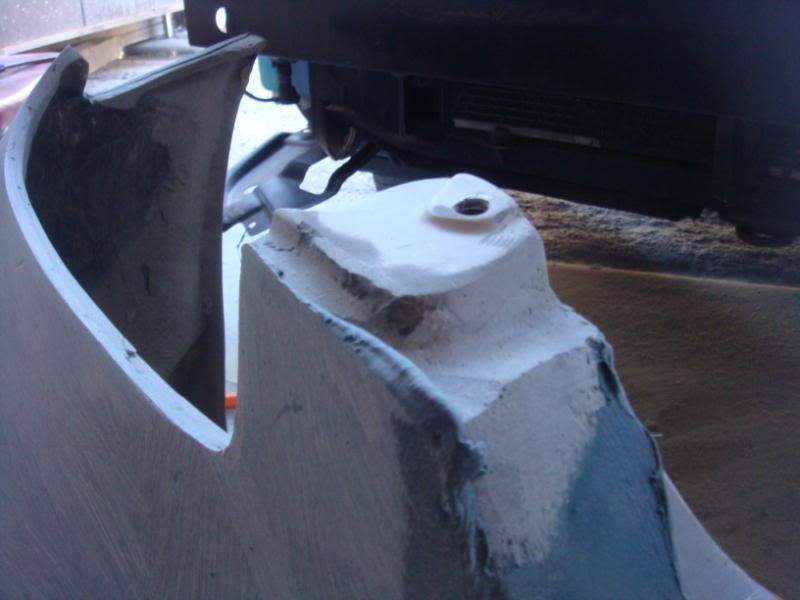

Tape up the adjacent areas of the bumper to body to protect the paint, I used 4-5 layers of masking tape. If you are not used to doing this type of work it is advised to make the tape lines higher.
Apply some wax to the tape and all areas that will need to be filled. This will make the filler release easily from the car.

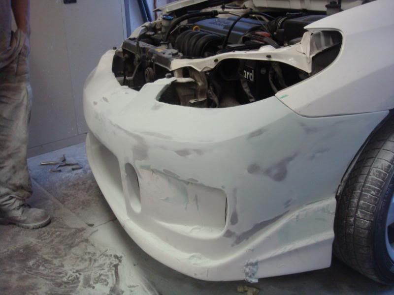

Put the bumper on close to factory fitment as possible. Secure it in place using bolts. You will be sanding on the bumper so make it sturdy as possible. At this point make necessary cuts, and breaks to make the bumper fit.
After the bumper is on the car sand all of the gelcoat down to the fiberglass in the areas that needs to be filled. Go about 3-4 inches past the immediate area of the filler. Use 40 grit or lower sandpaper

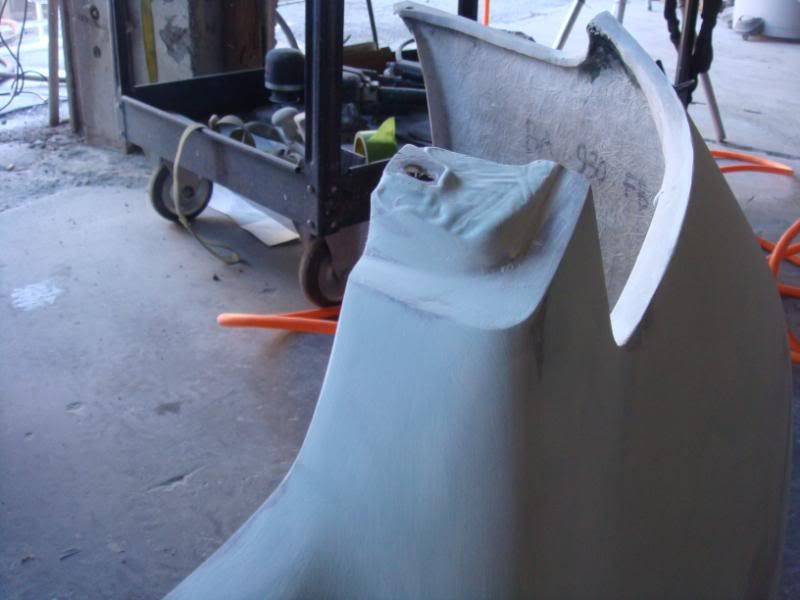

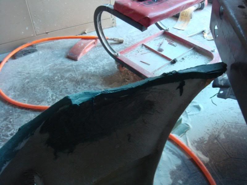

For gaps bigger then 1/8 of an inch use course fiberglass filler such as tiger hair of kitty hair.
For areas less then 1/8 use a high grade reinforced fine filler such as fibertech.
First squeeze the kitty hair in to the big gaps. Try to get it flush to the adjoining surface as possible. Let this dry about 2-3 mins and while the kitty hair is still soft rough shape with 40 grit sand paper.
After the kitty hair has dried use the reinforced filler to fill in the small gaps.
Let it dry untill tacky and sand to shape flush with the car.
After all outer surfaces are done remove the bumper.
It will be stuck to the car and will need some muscle to get it off.
after the bumper is off the car sand down the remaining filler to shape.
Repeat above process until you are happy with the fit.
If you have cracks from flexing the bumper or making major adjustments to it shape, look at my other post to see how to repair the broken areas.
http://zilvia.net/f/premium-members/...er-repair.html

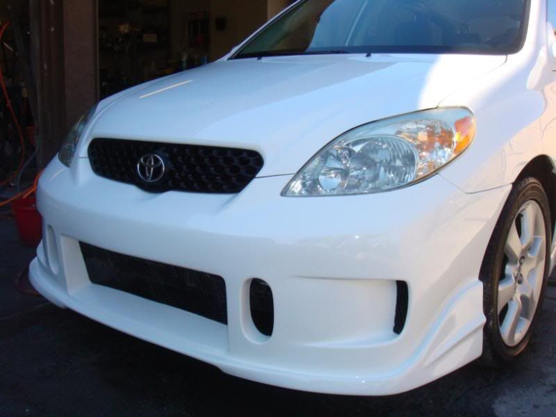

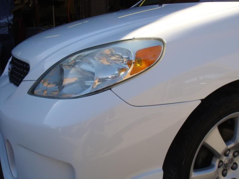

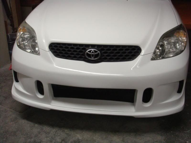

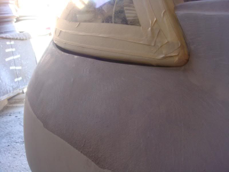

Last step is to apply plastic filler over the entire area and sand to shape.
Using some sanding block work the entire bumper starting at 40grit up to 150 grit

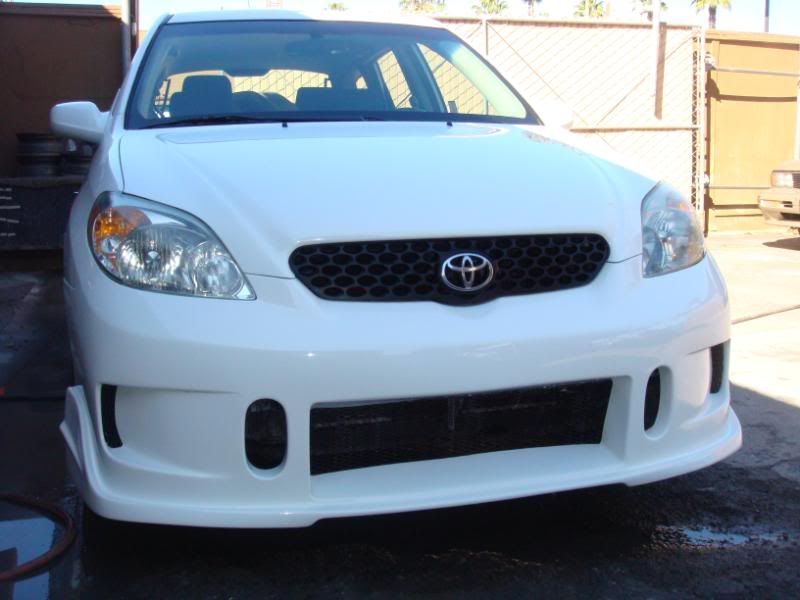

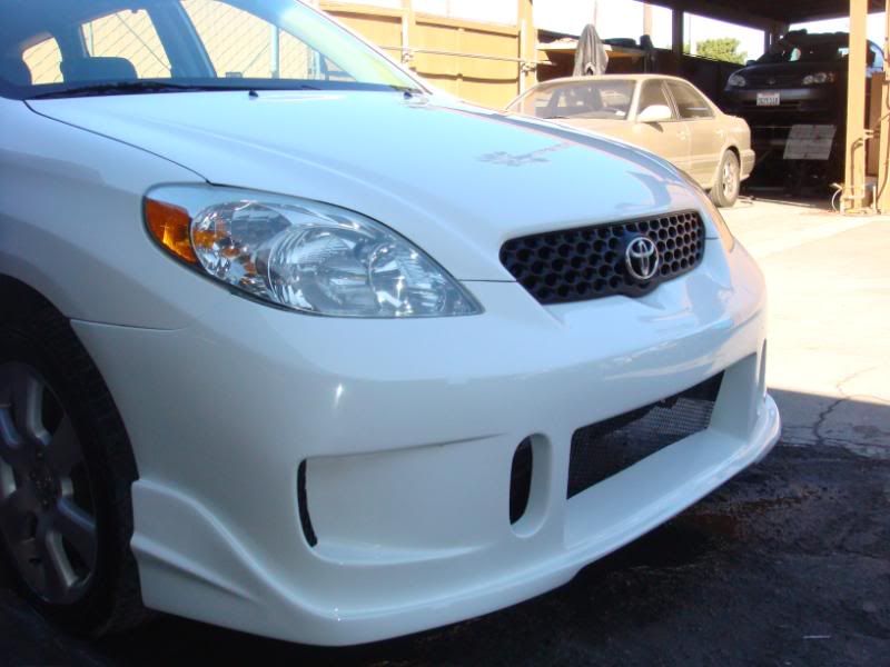

Remount everything back on the car for final fitment before primering

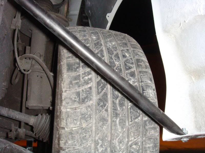

Optional make some braces to support the ends of the bumper
and done
