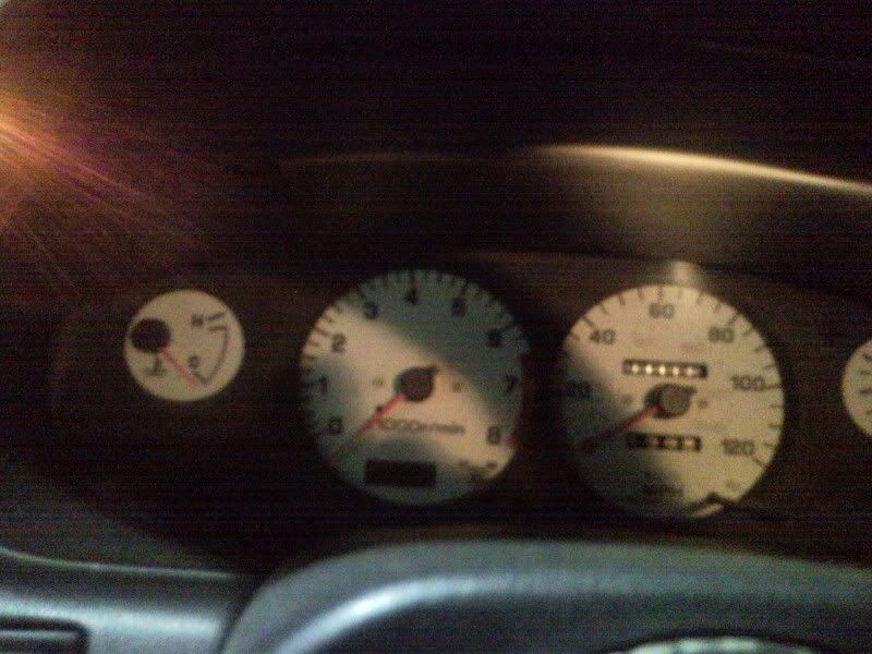

So i still have the "5k" rev limit after checking the 4th and 5th gear sensors, swapping out my MAF and my ECU (to get rid of CEl for auto tranny). Now after watching some zenki S14 vids on youtube i noticed that they have different gauge clusters than i do..... Now going by the gauge clusters ive seen then i am not hitting 5k im actually hitting the 6.5k to 7k rev limit.
What do you guys think?

try a new gauge i had the same problem give it a try

That's a Kouki(97-98) SE gauge cluster.

nice thx alot guys im gonna grab a zenki cluster

You can also rent/buy/borrow a dwell meter and see if it sweeps the same as the tach when you rev the car. If you rev the car to 3k and the dwell meter goes to 4k...

ahh ok ill try that. thx.
