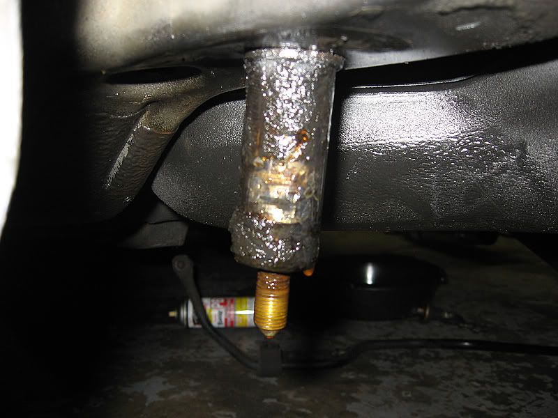

Originally Posted by EDacIouSX View Post
thats some super gappage. no idea if that is bad or whatever but it must be putting a lot of extra stress on the bolt since your subframes slapping around....
It will and does, I just replaced my worn out bushings with SPL's. I literary pulled the center section out with my fingers.
The driver front however, Binded the metal insert to the subframe stud. Not only that, From it slapping around for about a year bent the shit out of it. I had a REAL fun time fixing that.
So you litterally bent the stud, or sheetmetal around the stud? fuck!

Originally Posted by Bigsyke View Post
No crap, this is what im worried about, all 4 of my subframe bushings are just like the OP's
This...
That's the metal insert from the factory bushings, Its seized to the stud. Also notice the end of the stud, It was pretty bent. If your subframe bushings are shot and it clunks around, Replace the bushings or prepare to replace subframe studs.
This...
my god that stud is totally bent!!!!! seriously I think this is how mine is, i just ordered some solids so ill know next week.
Yes the casing is siezed on mine, I got it loose with some heat and pblaster..
this is my worst fear right now!!
thanks for the pic bro + rep!
