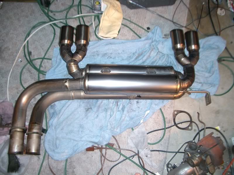

JIC,Trust, and Fujitsubo all use mandrel bending for their Ti exhuast today.
More of smaller priviate shops still do the pie-cuts. And since no-one really makes large bore Ti piping most just start with a big flat sheet, roll it to their desired dia' and start from their.
Here's a few i've had,
Mandrel:
Pie-cut
Back to the topic, I'd be very interested to see what you come up with, having tried several Ti-setup's out their It would be great to get something local. I personally would love to get a Quiet Ti exhuast. Somthing with a oval can, just different from the run of the mill like i had before.
Keep us posted.

You are actually able to bend Ti quite well, just no tight bends. Here's an example of my late M3s exhaust...
Goes into a couple of nice bends, then the rest are pie cuts...

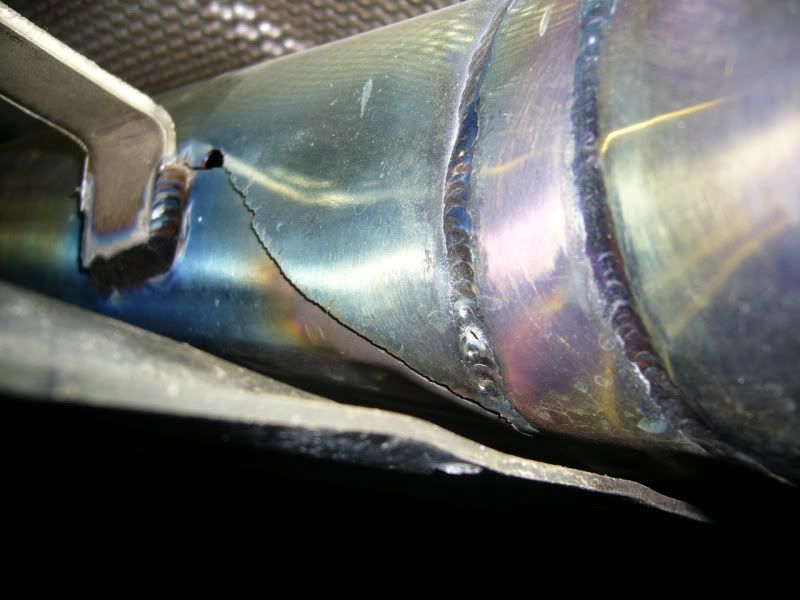

Pic of Ti Mid-pipe on M3. Ti is strong but brittle. Mounts were a little off and Ti just CRACKED under the stress and heat. Sucked

S13SilviaE46M3, yeah ti can be brittle. the mounts will be different than the ones in your picture.
