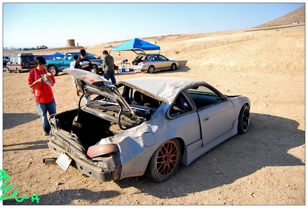

[quote=karl wasabi;2616415]a Cusco will work because the Japanese are awesome and don't care about bends in the cage.quote]
Save your money and avoid cusco. Their cages are a joke. The huge S-bends in the a-pillar bars completely neagate the point of even having a-pillar bars, and their clevis style bolt thrus for tube attachments are questionable at best. Not to mention they have ZERO triangulation, and no harness bar. Basically they're a piece of collapsible scaffolding that you can crush you skull on seconds before it impales you.

Originally Posted by Baxter View Post
First post and already talking like you know your shit.
A cusco cage WILL hold up in a rollover...

regardless of the fact that it held up in that specific incident, you can't refute that their "cages" are a horrible design. It's not approved to be used by any sanctioned road racing body.
