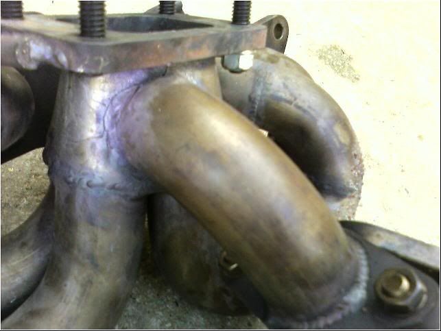

Turbo/Exhaust
GT28R From a s15 dual BB turbo
SSAC Manifold (Cracked)-getting a JGY.CC one next

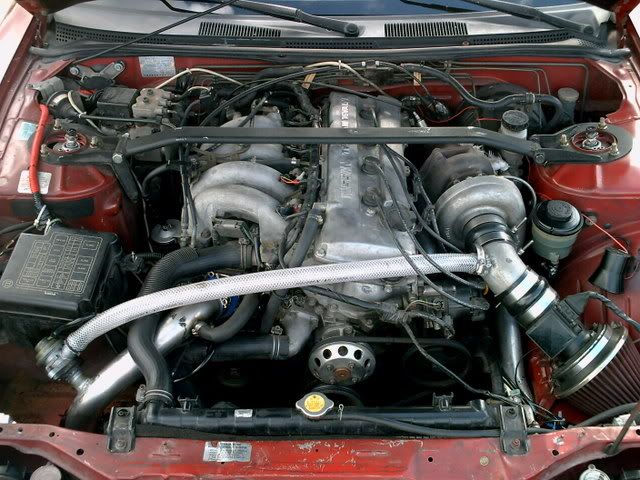

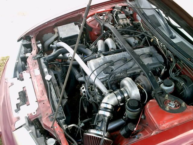

1. Bo0st Design's old turbo kit(bought from a friend), t3/to4e garret .57trim 60a/r(something like that)
2.25" fmic piping(bo0st designs) piping with greddy core
tial 38mm wg with 8lb spring
safc2(street tuned using zeitronix wideband/datalogger)
retarded base timing 16*
walbro 255lph
deatschwerks 480cc injectors
1g dsm bov recirctulated
z32 maf
z32 fuel filter
Ebay xtd stage 3 clutch
2. 28k mile motor was installed summer of 06, then the turbo went on Dec of 06. Still running strong with no problems...
3. dynoed when the mainfold had 2 cracks, i made 217whp and 235trq
4. no explosion
5. love the power, feel, handle, and outcome...cant complain
6. pics are always welcome
^^crack 1^^
^^crack 2^^ thankgod i got them welded...feels so0 much better!
^^pic from dec 06^^ still looks the same...besides the added koyo and a yr's worth of dirt
