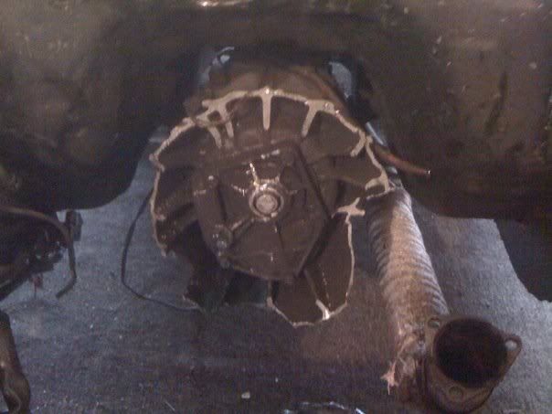

s13 Blew my clutch to pieces....HUGE FAIL! Lots of carnage

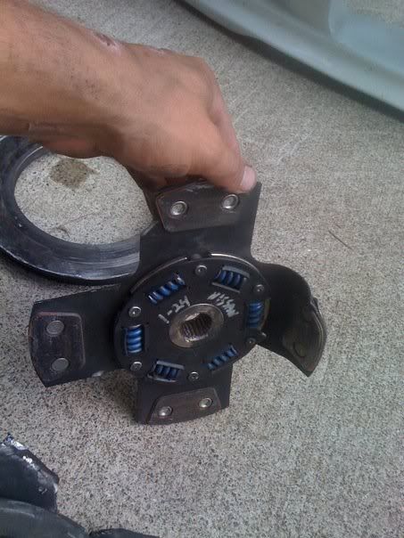

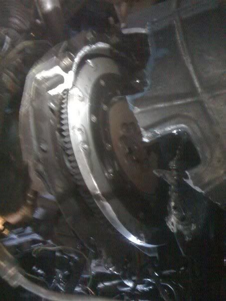

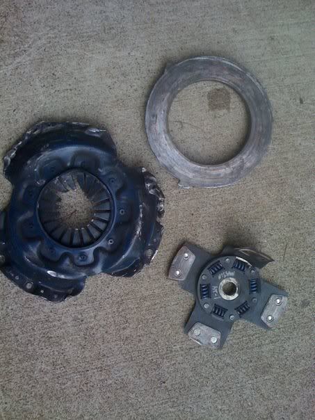

I was doing a pull and when i shifted to grab 4th My pressure plate seared off my flywheel breaking my input shaft to the tranny and then causing all of it to shoot through my bell housing.
My whole bell housing is shattered into pieces.
My pressure plate is stuck in between my cylinder head and the fire wall..... and I cant get it out.
My clutch put a divot in a concrete road about 3"x4"x1" deep.

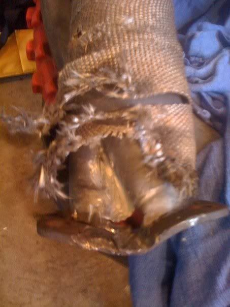

i have a hole in my down pipe the size of a 50 cent piece.
there is a hole in my center council about the size of a quarter.
This is a quick pic of what i took from underneath it.
Very shitty pic but you get the point.

Looks like the 4-puck Spec Stage 3. Did you torque everything right? Did you break it in properly? That shit's crazy.

yea good thing u didnt get hurt.
and pls let us know what kind of clutch is that.
and how much hp u were pulling.

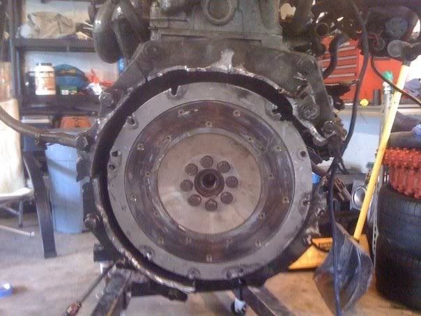

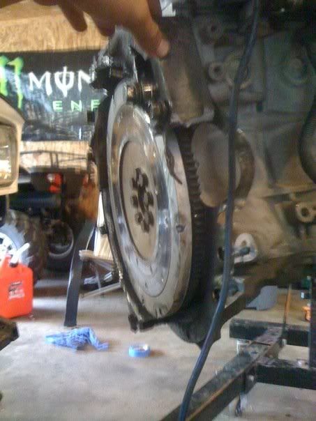

from the pic of the flywheel, the bolts sheared off from the mounting point.
thats crazy. update us!

from the looks of it the back side of the block is cracked so all of it is probably going to the dump anyways.

Originally Posted by xpertsnowcarver View Post
HOLY SHIT!!! That's a first for me!
So what threw a wrench in your dryer man!? The pressure plate broke off?? Lucky the bellhousing dampened the force of all those flying parts. If it wasn't for that, all those parts would have gone through your chassis and into your face!
Yeah there is a hole about the size of a dime on my center council next to my shifter.
Originally Posted by chibo View Post
Holy fucking shit. What brand are those?
Fidanzza aluminum flywheel, and Competition clutch and pressure plate.
Yes everything was installed correct. This is my second season on this setup.
From the looks of it the pressure plate ripped out of the aluminum flywheel.
I am going to contact Fidanzza and see what they have to say about it.
Originally Posted by z2roll4life7 View Post
Dang that some carnage Bro dam man what now?
Buy a bell houseing input shaft, fix my block and a twin disc and let er buck!
NISNPWR is offline   Reply With Quote
oh and more thing
u need to inspect all the moving parts from crankshaft to camshaft.
that is a serious damage.
It is a Competition clutch. On high boost I dynoed 578whp and 444tq.
The night it happend I was only on 20psi which is about 525whp for me.
The flywheel bolts ripped right out of the flywheel
Yeah the block will be fully disasembled and gone through.
Yes, Cracked and it has 2 of the bell housing bolts ripped right out so all the threads are junk, plus the started got ripped off so the two bolts that hold it on broke the block.

yeah steel or chromolly flywheels for that kind of power please, I would NEVER run an aluminum flywheel with that kind of power, you are lucky to not be hurt, I'm running a JUN Chromolly Flywheel, with an RPS Clutch, good for 728ftlbs of torque. never had a problem i absolutely love the set up.

Oh man. Fidanza you say?
With that power you should be running one of those nice twin disc units like OS Giken or something.

^^^ You don't need Twin Disk set ups, he just needs a good pressure plate and flywheel, with the correct clutch material it will hold, my clutch is a sinlge disk, no clutch chatter or idle noise, and will hold one hell of a llot of torque.
I Would Strongly Recomend this Clutch it's what I have and I Absolutely Love it
http://www.specialtyz.com/rps240.htm (last one on the bottom)

the problem could have started with 2 or 3 pressure plate bolts working themselves loose which eventually puts more sterss on the other bolts.
