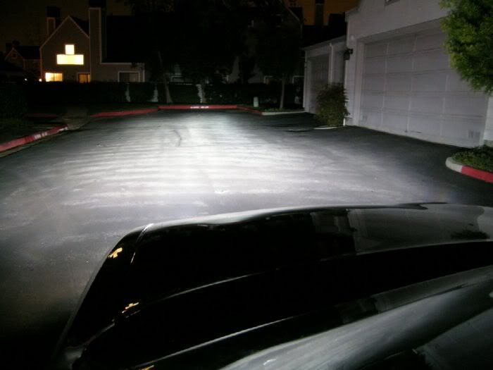

but the result IS so much better. here's a comparo for you.
Zenki S14 w/6000k drop in kit.
My retro'd zenki with stock lenses, will be even better w/ clear ones.
The color is not as yellow on my car, but the light output is representative. Look at the difference in foreground lighting, reach, and evenness of the spread.

Whatever dude, I could care less about the justification/excuses you come up with.
You said only thing different was cutoff, and I gave PROOF with pics that a retro DOES give better output.
Oh and BTW my whole retro cost me ~$375. Any hid kit worth it's weight in salt (not many) will be at least that much.

Originally Posted by MrSkinny
Perfect example of why drop-in kits are so F*CKING obnoxious!
that's enough glare to kill a horse! Geez.
Not to mention that all of that light is not being directed at the road, making visability worse than it should be.
Originally Posted by dct223
Note that if my pic was against a white wall, a ton more light would show up in the pic that the brown wall is absorbing. So yeah.
RBS14 is offline   Reply With Quote

That doesn't look like an issue with the HID kit, it looks like an issue with the digital camera used, and purple fringing.
There is a very important distinction between drop-in kit and a retro fit. The ONLY difference is that in a retrofit, you are using a different lens - the OEM projector. I've sold a set of 6500K (purple) bulbs to someone with a 350z. He retained the razor sharp cutoffs, and gained purple lights. The bulb will have very little result on glare/light. It's 98% the lenses.
S13 owners that switch to a $19 ebay-special H4 conversion have godaweful output. I've seen it. A local kid's HID lit up ~10 feet in front of him, and blinded me while I stood at a 135* angle to the light source. But when springing $80 for any ECE conversion kit, the cutoff is so much better, the light projects down the road, and there isn't dangerous glare.
On a zenki, there is a bit more glare than most other cars that accept drop-ins because of the flutes on the lenses. Koukis, however, look very good, and don't blind me as I drive in front of them. Good projectors. And nobody has complained about my gf's cougar's stock projectors with the HID kit.
Razor sharp cutoffs look good. Amazing. I want them. But not having them doesn't make you Satan Incarnate. If anything, lower the headlights to remove glare from drivers. There is a way to spend a couple hundred bucks and 5 minutes to double or triple your light output. Not everyone needs to spend many hundreds of dollars and hours sourcing/fabricating/installing a retro fit.
Again, I'm not taking anything away from retrofitters. Their stuff looks good. But - you guys ripping on kit owners is like Clearcorners ripping on you for not buying their $1800 HID retrofit. Apparently, theirs is the only DOT approved HID conversion. Retrofits and kits are both illegal. But the two cars I have with HIDs, and my friend's kouki and other friend's s14.5 .. none have been bothered by cops at all.
