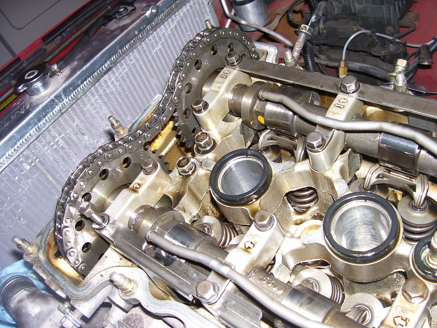

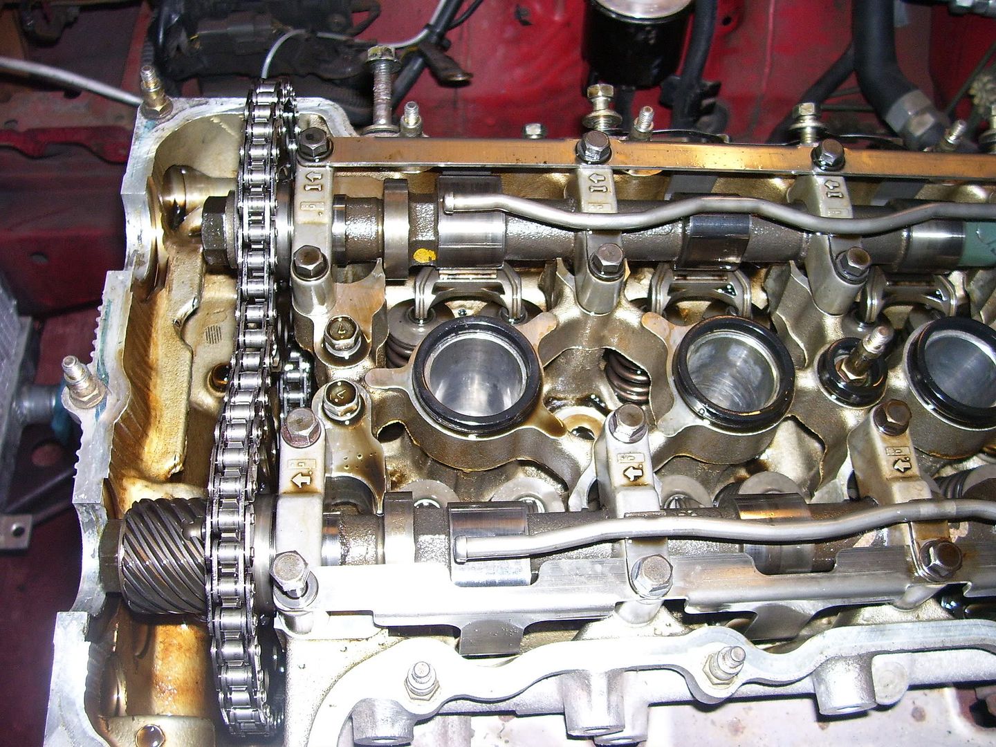

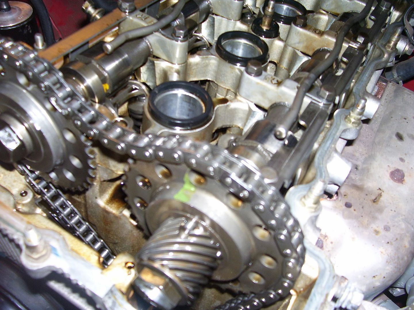

Been following that manual on sr20's up to this point. It says to use a socket on the sprocket and an open end wrench on the hexagon shaped thing on the cam. I dont see where this thing is. How do I remove the sprockets ?
http://i288.photobucket.com/albums/l...x/100_1254.jpg
http://i288.photobucket.com/albums/l...x/100_1255.jpg
http://i288.photobucket.com/albums/l...x/100_1256.jpg

its DIRECTLY in front of the #1 cylinder cam lobe
you can do that or throw a breaker bar on the crank and hold it that way also.

Thanks, I thought that it was supposed to stick out like the lobe does. I cant fit my open end wrench in there because its too thick. About the whole breaker bar on the crank can I do that without the belt being tensioned?

Well that didnt work. The chain ended up jumping like 5 links.
