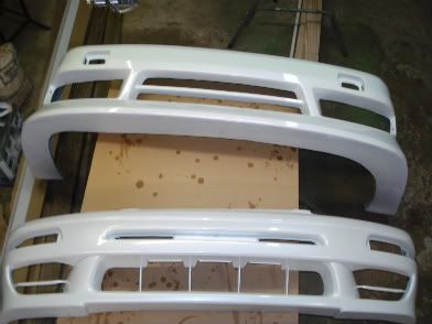

Preping my car for paint w/Pictures. Could use some painters advice =)
So this sounds stupid but I have a $300 budget. That's it. I need to paint my front bumper and sideskirts (Fiberglass), fenders and headlight covers (Metal).
Here is what I'm working with:
Long story short: My friend was going to do the whole thing himself and teach me but he bailed and I have no idea what he did besides some filler. All I know is that I sanded some of the paint off the fenders, and fit everything together haha.
So now I have this and I haven't the first clue about painting. But after many many hours of videos and reading this thread through a few times
http://zilvia.net/f/tech-talk/199733...asy-steps.html
I think I have a general idea.
All of my sanding will be by hand with a sanding block.
So far my plan consists of:
1. Take some 180 grit and sand down the rest of the headlight covers, all of the sideskirts, and the front bumper. Then again with 320, then finally with 600.
2. Buy this stuff:
Because I can't afford this stuff:
nor do I have the money for a gun =/
and just spray 3-4 coats of it on all the white stuff to turn it whatever color the primer is. Then use a different color primer lightly as a guide to know when to stop wet sanding.
3. Get some warm soapy water and use 400 grit sandpaper on the primer until it looks smooth. Then after that hit it again with some 800.
4. Drive it down to
Car Painting | Earl Scheib - Paint Services
and get a probably silver, but hopefully platinum crap paint job.
Extra stuff:
What is a sealer and why do I need it?
Can anybody chime in on the steps I might be missing or have better advice than what I put up there?
Do I really the platinum service or can I paint can clear coat it when I get home?
Do you think I will need any filler for this work? and if so, is it as easy as putting some on, scrapping it off, then after drying, sand it smooth?
I greatly appreciate any help or comments

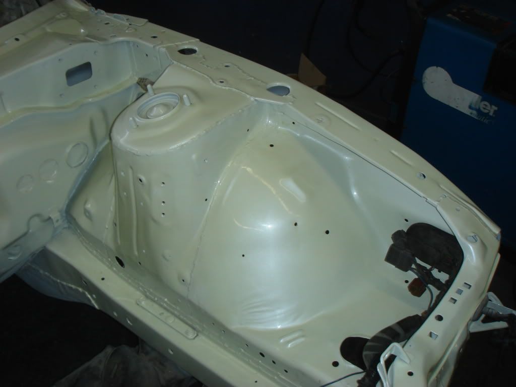

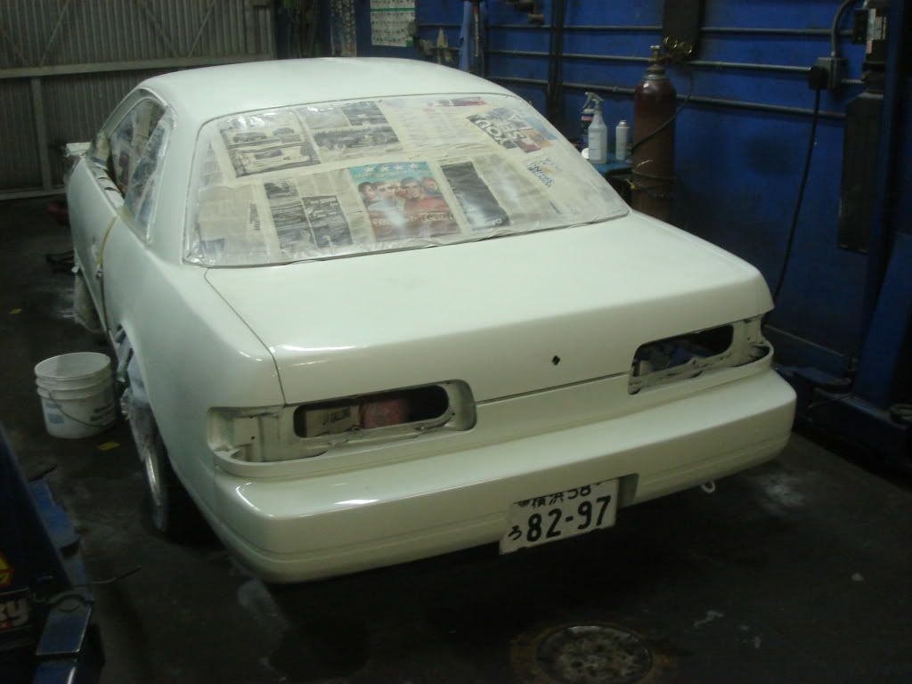

You could definitely do it yourself for under $300 if you can somehow borrow a compressor. Don't worry too much about a sealer as it is mostly used when changing a car's color. You basically use a sealer primer to apply a coat over the old paint so that you won't need to use too much base in order to get good coverage.
You only need one gun with one tip. I painted an entire car with my Sata gun with a 1.5mm tip. Just make sure to clean the gun well in between coats. Two quarts of paint will be enough because most base coats need to be reduced by 50% so you will have a gallon of sprayable paint. Also, make sure you get the correct temp. hardener for the clear in order to help with dry times and to avoid runs. If you do get runs, make sure to wet sand them before topcoating.
The most difficult part is applying the clear. If it's your first time painting, you are bound to either get runs, or really nasty orange peel. Try to lay down even coats of clear in order to avoid orange peel. If it looks like you are getting orange peel, make sure you lay down a few coats so that you can wet sand. If you get runs in the clear, wetsand with 1000 grit sandpaper. Wet sand all the finished panels with 1500, then 2000 and buff with a good rubbing compound.
The best advice I can give you to avoid runs is to paint on a hot day, and remove all the panels and put them on a table. it is much more difficult to make paint run when you're painting on a horizontal surface.
Here are some pics of the first car I painted. I did it in our muffler shop in somewhat dusty conditions. I just sprayed the floor with water to make sure I don't kick up any dust with the paint gun:
