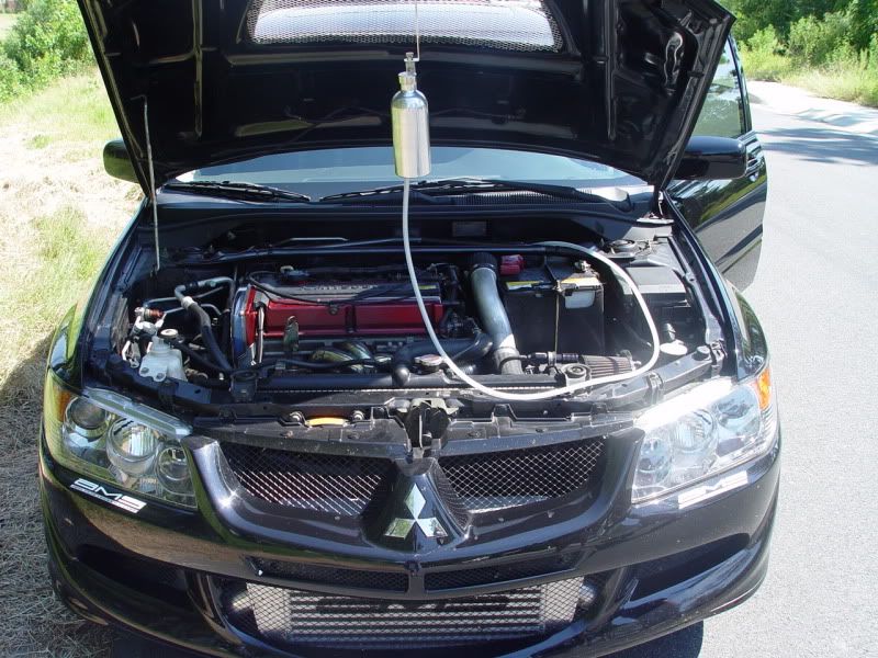

If you're going to use Seafoam, such as through a vacuum hose, I recommend using something to regulate the amount it sucks in. The problem lies when people let the engine suck too much product causing the engine to flood.
This is the proper inexpensive way to do it.
