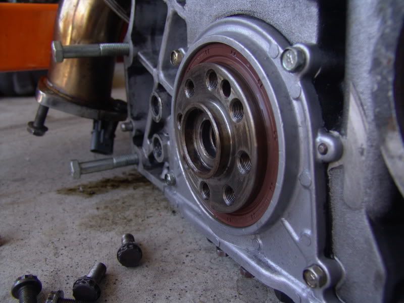

i must of lubed up my rear main oil seal too well? i tapped it in and it all of a sudden slid in, is this ok?
As long as the seal didn't go into the rear main housing beyond the stops in the cast piece, you're ok. You just want it to seal against the end of the crank that's the main thing, so as long as it's still in the housing you're ok
