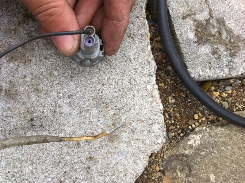

my KNOCK sensor reads 1.7v or something like that, but in the process of findgin out, i accidentally yanked the white wire out, am i able to just push it back in ? and is it normal for the black wire to just end in the middle?
also checked my TPS, 0.7closed 4.3 WOT
unplugged my CAS, and i heard something shut off, i think it was the injectors, so i know that works..
THEN i checked my maf, its getting no power at all, the middle wire is a ground right? white is signal, and what is black white? either way it has to be my wiring to my maf, no power what so ever.

trace your wiring back until you find where your not getting power at, also make sure its not wired backwards

fixed the revving problem!! started the car up today, it reved nicely, and idled really good, a/f was also perfect.
the thing is.. the maf issue didn't fix my starting problem, after i shut off the car, i tried to start it again... and it didn't start.... sound like an ignitor to you guys? i mean, the car was running perfect!

the b/w wire to the maf was disconnected about in the middle, so i just re-soldered it..
