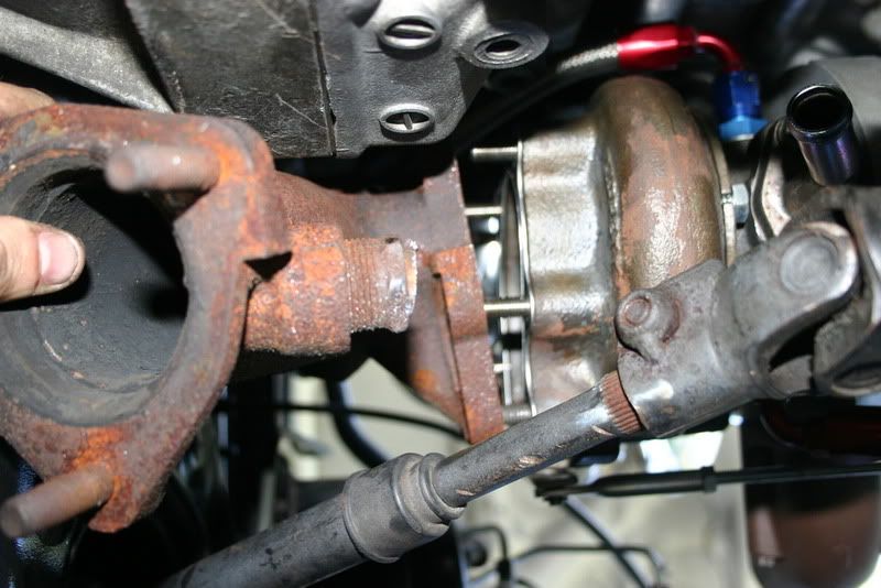

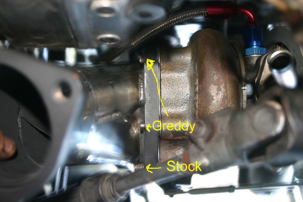

Tried installing my PBM downpipe today but a no go. Pipe is hitting bell housing and bottom of car. So I tried putting on the greddy... no good either... stock unit didnt fit either. All 3 were hitting the bellhousing. Thinking that the FP manifold doesnt put the turbo in stock location and needs to be spaced out about half inch or so. Took some measurements from block and firewall. Could somebody measure the location of stock turbo with stock manifold, that would be nice. Took some pics.

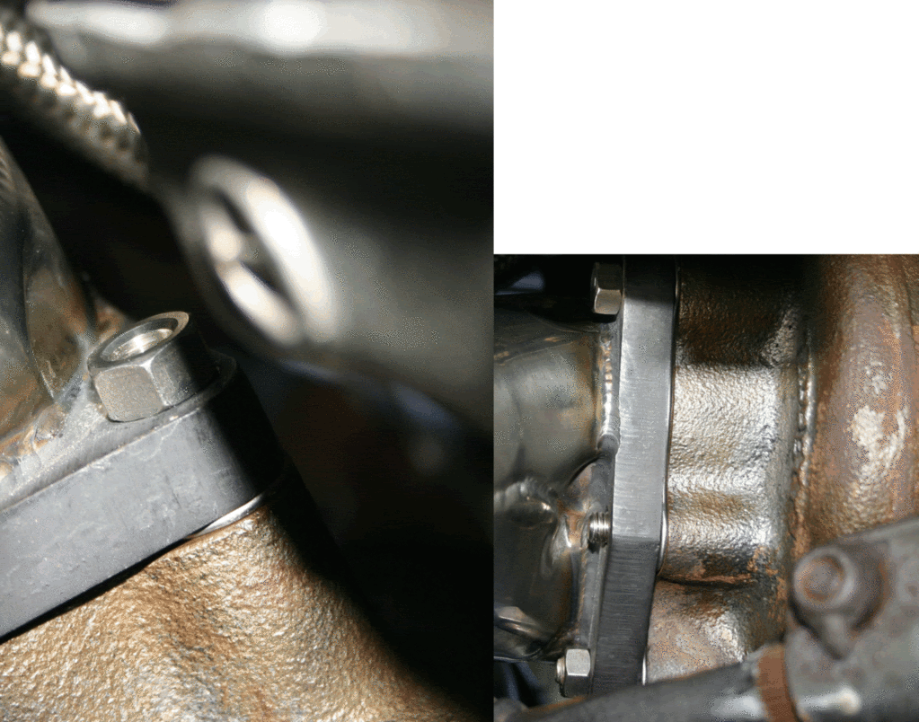

Thanks for the boost... ended up running three factory studs and two bolts. Using the stock manifold. Everything fits like a glove now. Post pics later.

The thing that bothers me is that not only did the PBM not fit but either did the Greddy elbow or stock unit. Gonna contact Forced Performance today. Hopefully they can shed some light on the situation. Hopefully all is needed is a spacer on the manifold off the head spacing it out or between the T25 inlet and manifold spacing it down.
Good idea on bolting the stock manni on. Might try this after work. I could compare turbo locations and measurements by doing that. Why didnt I think of that.

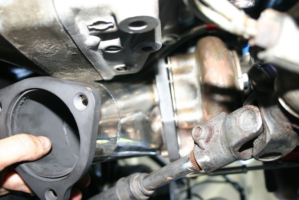

put on stock manni
Put on the stock manifold and all three downpipes bolted right up. Stock manifold sits lower and out from engine more.
Finally spoke with Forced Performance and they said that no one has called them about having issues with the turbo manifold, granted they've only sold 47 of them since 2006. Find it hard to believe that I would be the only one that had an issue and called them about it. Gonna do some measuring and see if I feel like running a spacer on the head and in between manifold and turbo inlet flange. But if what yall say is true about the stock manifold I might just run it... but its so damned ugly.

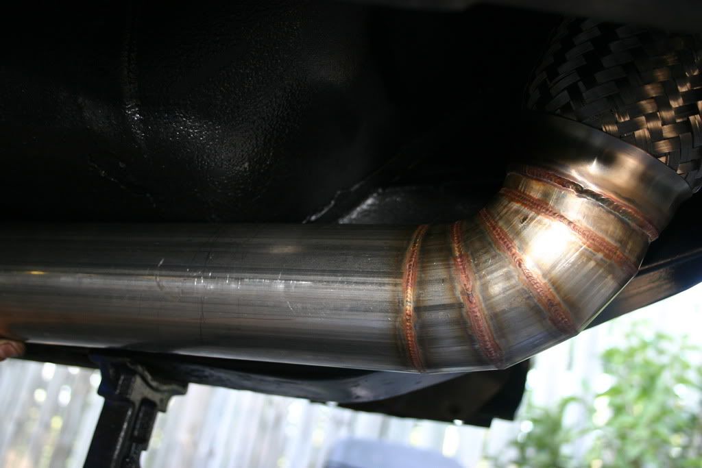

which part of the downpipe hits the bellhousing can you take a pic?
Well i have a 95 240 and i like my cars low... But my parents don't like my wheels tilted

downpipe hitting bellhousing
If you take a look in the first pic of the first post the PBM is hitting the bellhousing right before the flex part, exact location as the Greddy in the 2nd pic. Say its about midway on the housing right above where the 4 inch flat section is. Kinda hard to take a good pic under car or in the engine bay. Has anyone run this manifold? or know of anybody who has successfully?

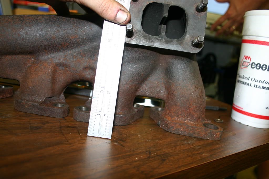

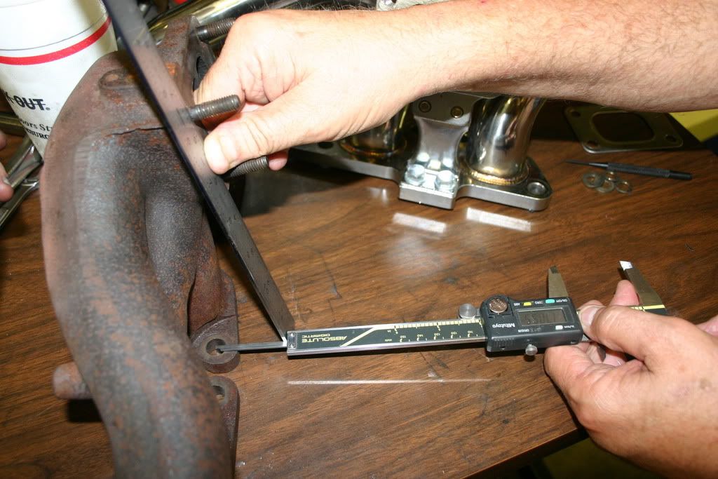

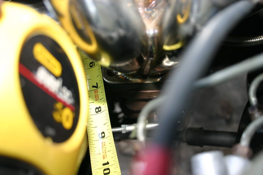

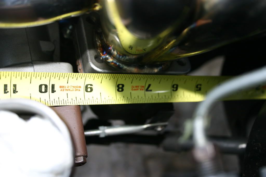

Measurements
Compared FP to the stocker manni and took some measurements. Distance from the exhaust flange to the inlet flange on the stock was 4.25", FP 4.75". Put manifold exhaust flange down on table, used a straight edge on flat surface of inlet flange. Then measured distance from straight edge on table to exhaust flange mounting hole. Stock was 1.7055", FP 1.459".
With the FP manifold the turbo was sitting half inch closer to the engine and a quarter inch higher. No wonder the PBM was hitting the bellhousing and underside of car.
On a side note. Does Greddy actually think u can run their turbo studs and get a lock washer and nut to fit?!? I'm not comfortable with only 1.5 threads holding my turbo elbow on.

You could use some locking tabs, didn't they come on the turbos from the factory?
Or you could use bolts and do this:
Drilled through the bolts, tied with steel wire, so they don't come loose.
Or if you're baller, use jetnuts!
