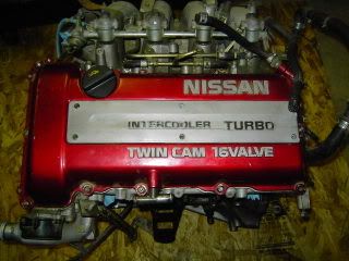

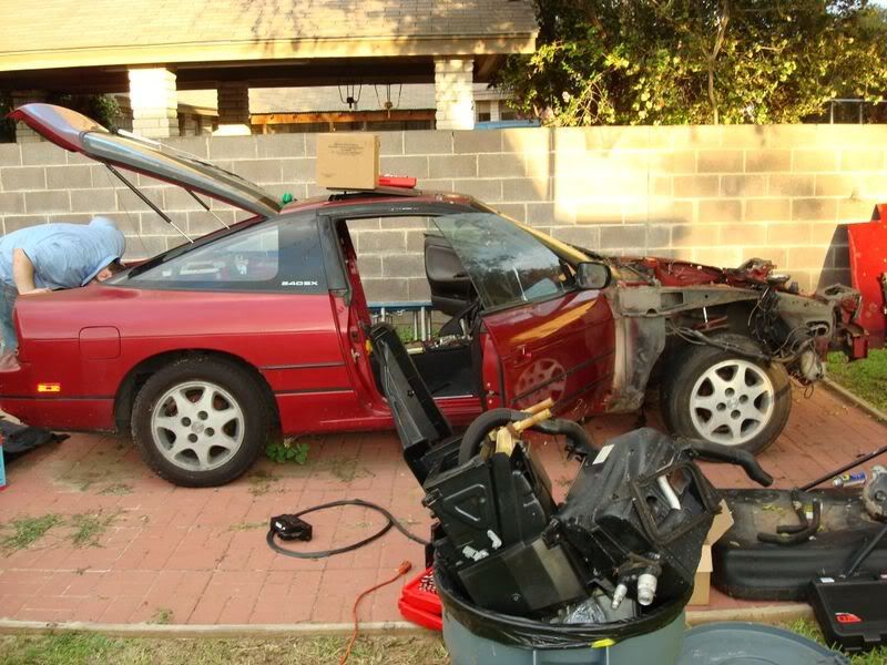

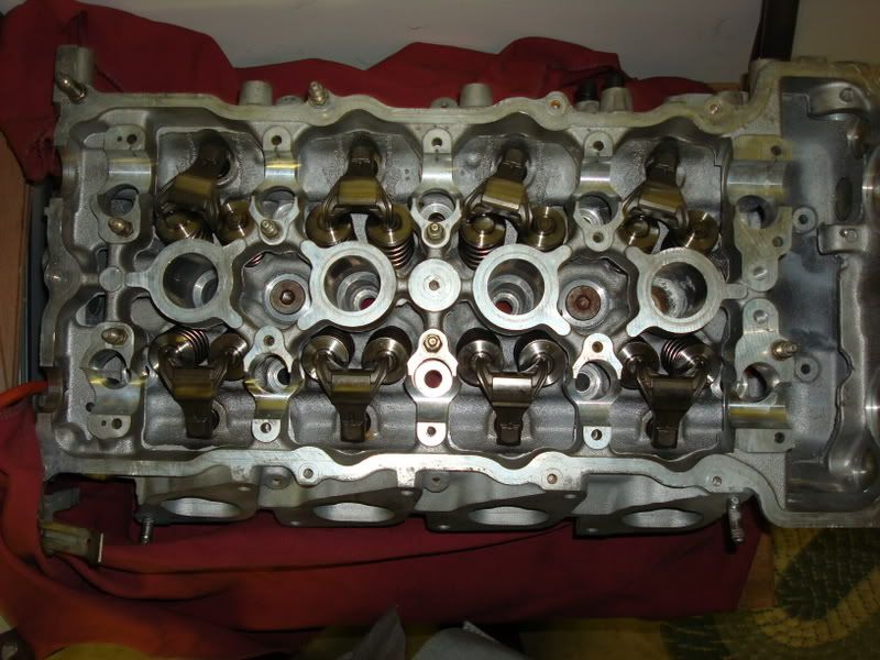

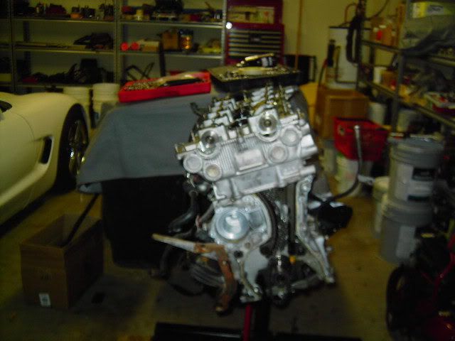

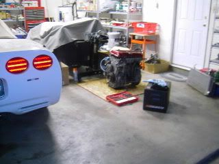

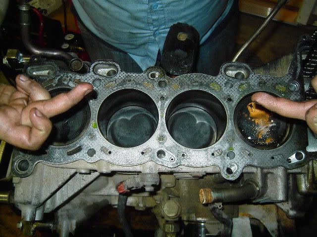

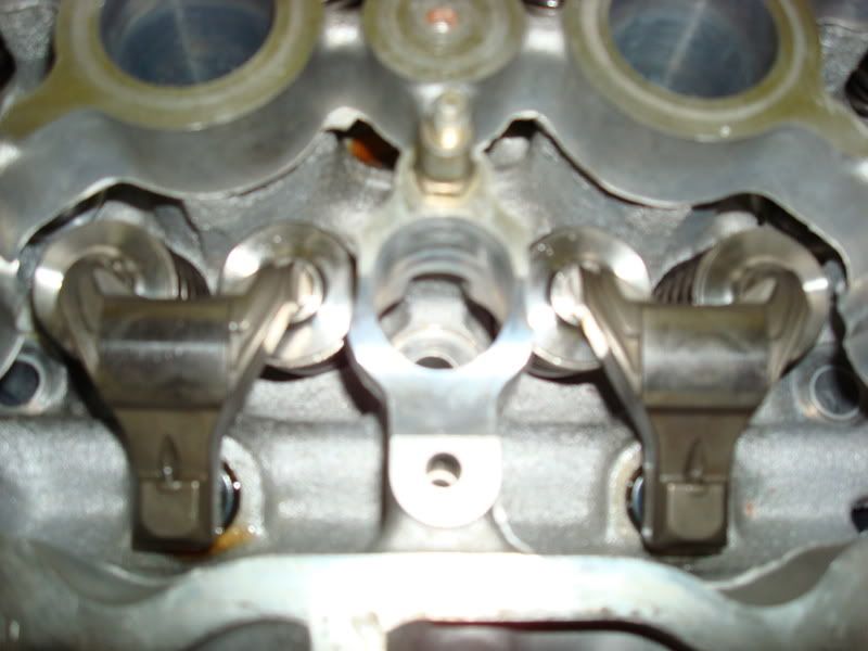

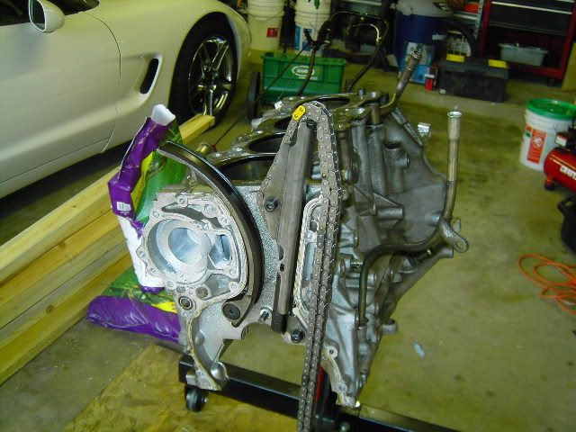

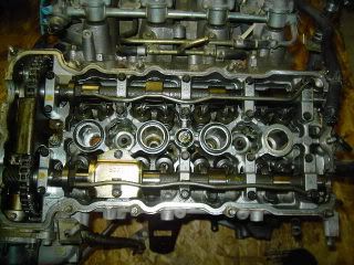

i wanted to see whats inside got me engine stand and tore it down
at the end i just knew i wouldn't be happy if i dropped it in like this
since its been in the hands of the locales and god knows how many jdm ppl ran hard as shit.

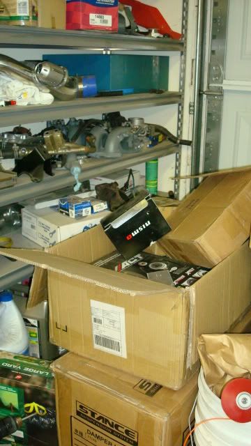

well i ordered bunch of stuff

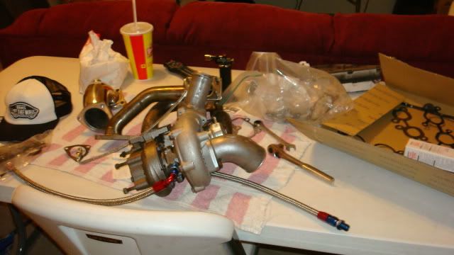

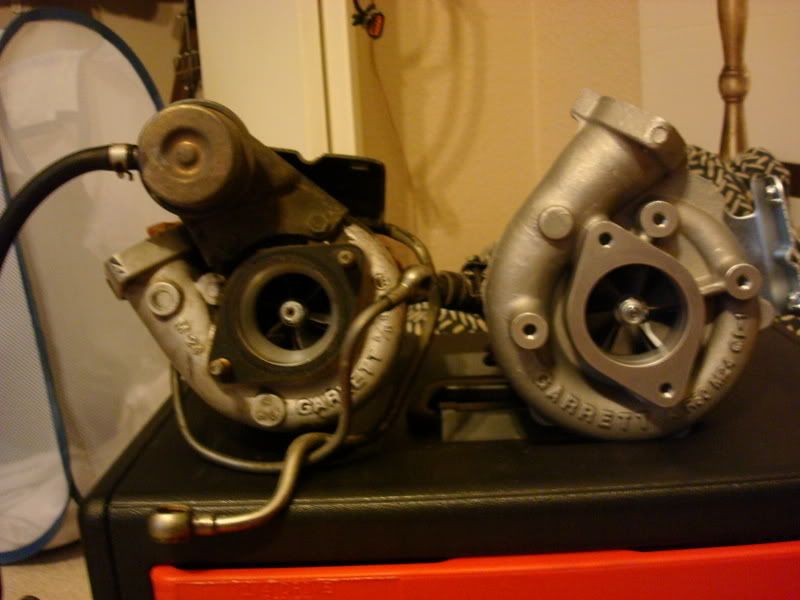

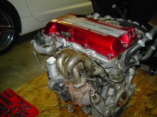

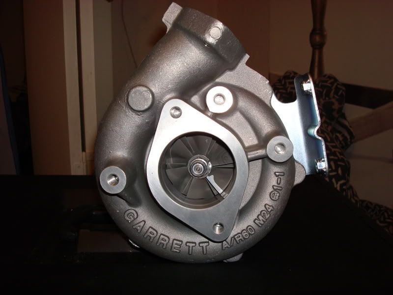

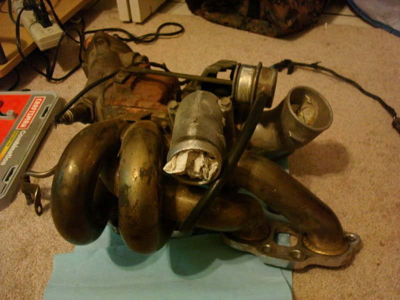

i got a better look of my turbo set up looked good
but since i was going this far might as well upgrade

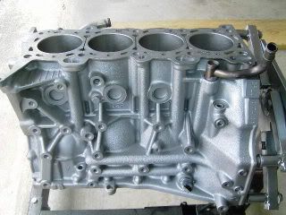

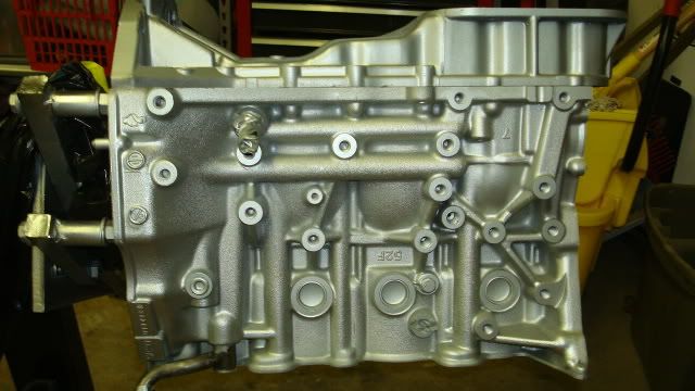

later on my buddy scuba was like "when the fuck are you taking the block to the machine shop buay"

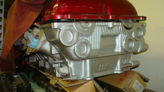

i took the parts to Adrian's Automotive Machine Shop
Work done by Adrian's Automotive Machine Shop
clean block
chock &hone cly block
pressure test head
valve job
intall all head componits
clean, cheak &polish crankshaft
couldn't be happier

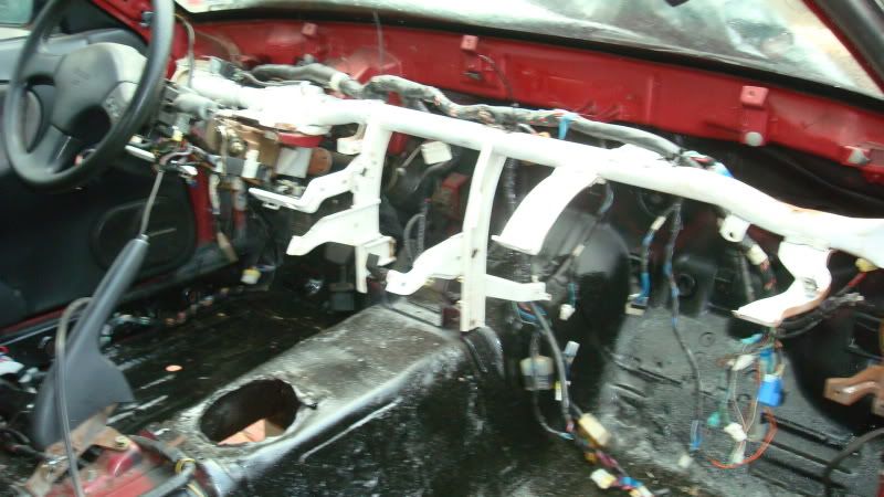

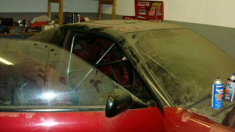

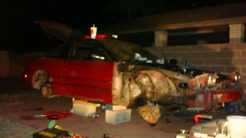

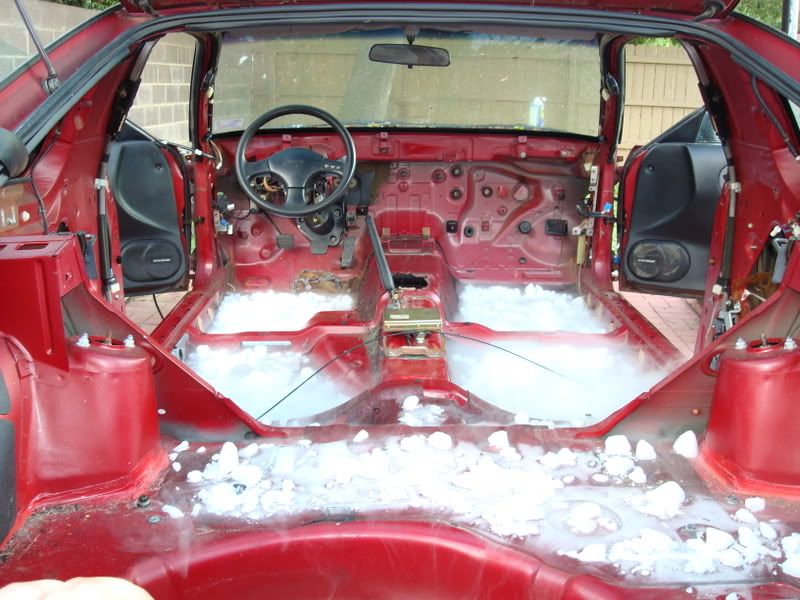

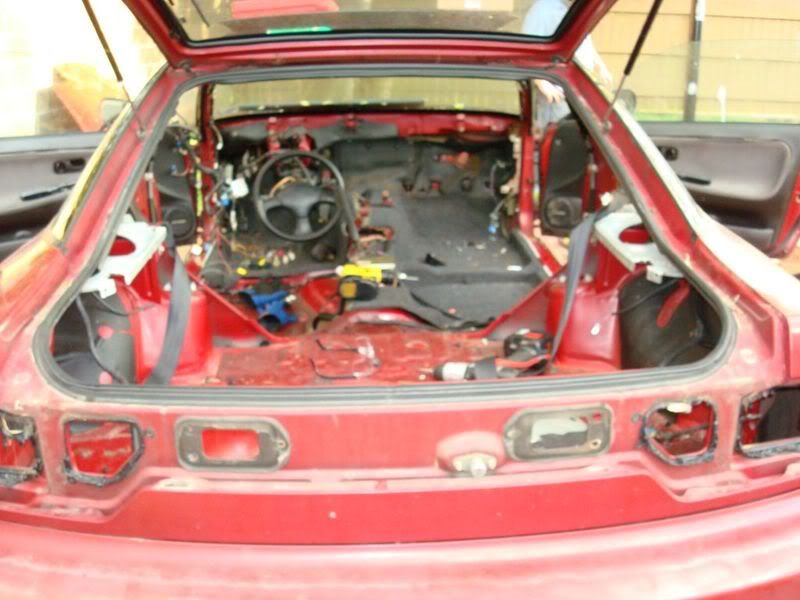

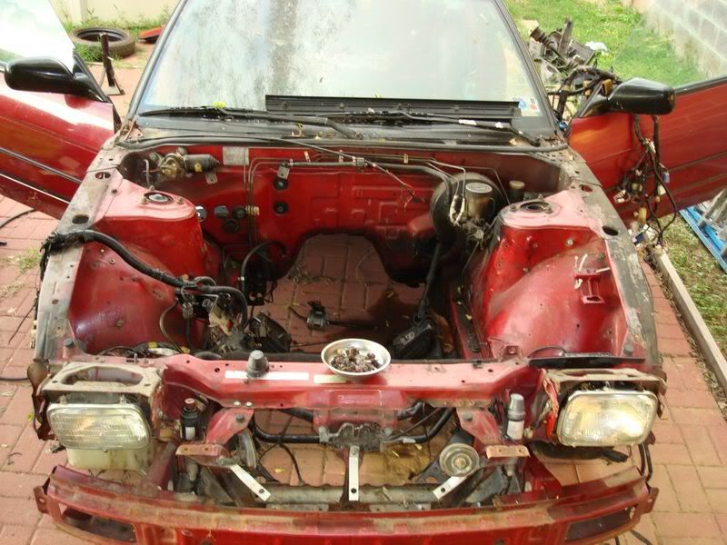

later on i found this gem 1989 240sx
we ended up tearing down the car as well
dry iced it to take off all the under layers
surge s14 is offline   Reply With Quote

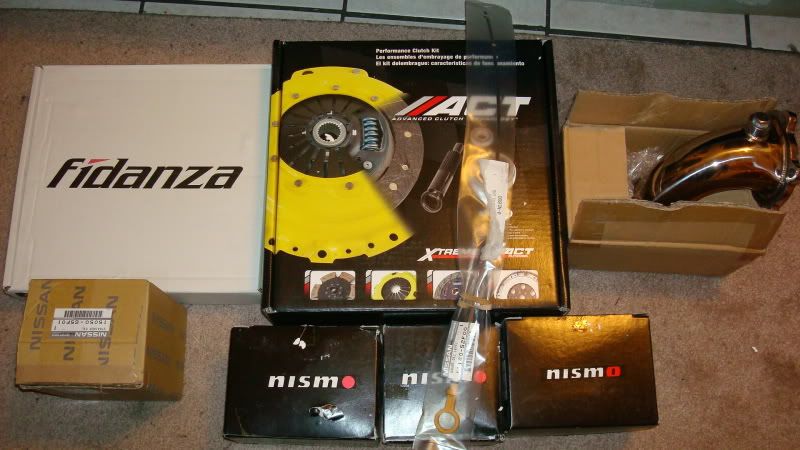

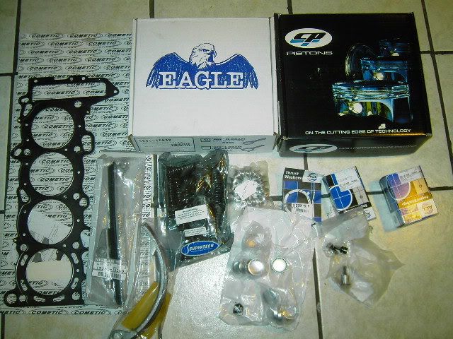

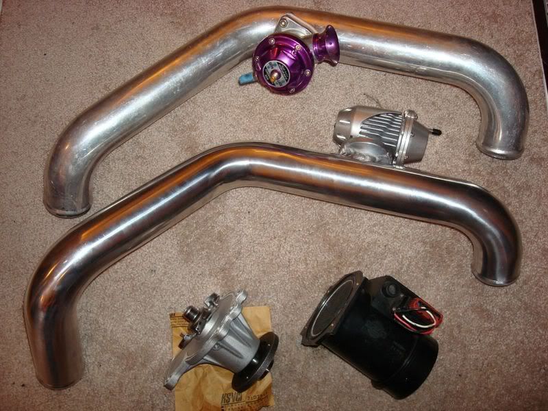

i ordered some more stuff
at this point this is the mod list
cp pistons 86mm 9.0:1
eagle rods
supertech valve springs
supertech retainers
supertech valve guides
oem timing guides
acl bearings
megan mani
brand new gt287r .64
taka lines

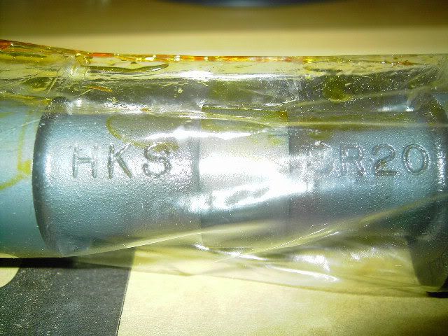

hks bov ver.2/hot pipe
hks cams 264/264 (step 1)
Tomei 740cc
z32 maf
New oem water pump
complete gasket set
Cometic head gasket 88.5 mls .040
god speed fmic
couple of weeks ago i started preping the car for Guerros shop

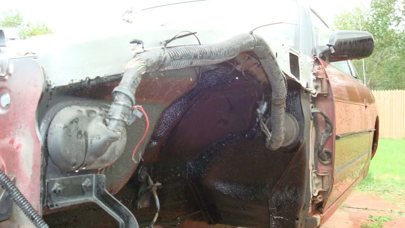

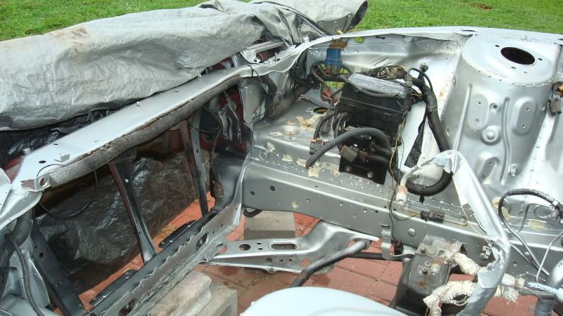

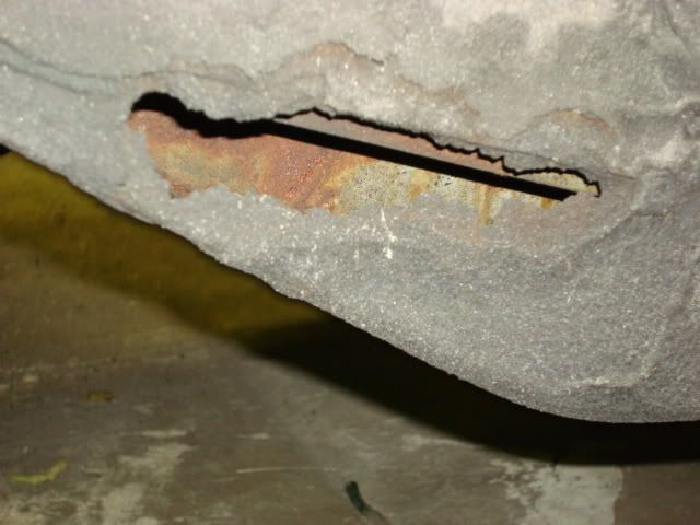

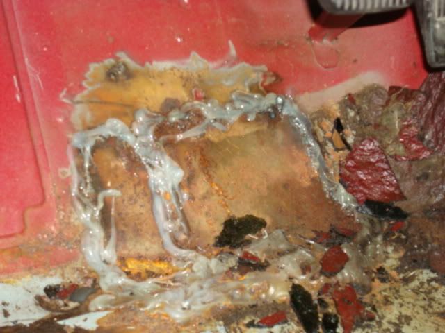

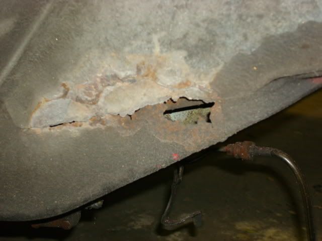

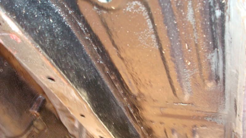

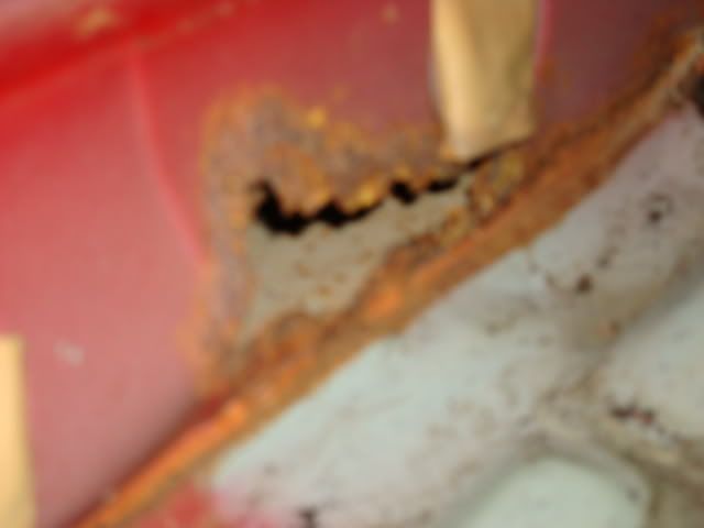

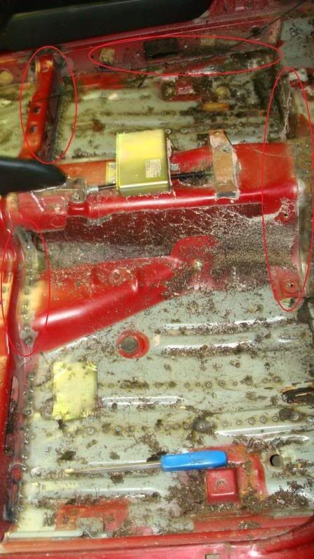

a closer inspection of the car i found some disturbing news i have large rust holes along the chassy rails
this is the biggest one i can fit my whole hand thou it
this one on the inside of the car
and of coarse no 240sx is complete with out ghettoizing something
this is a huge peace of metal rusting away with some kind of epoxy

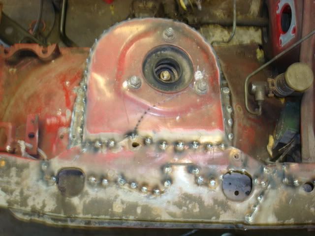

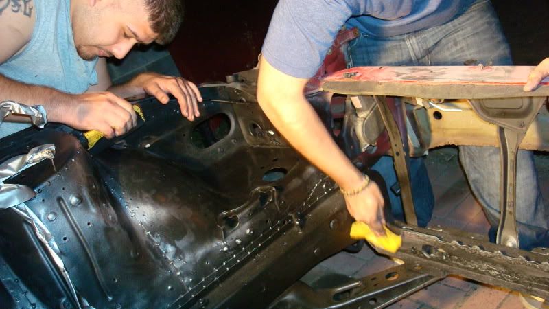

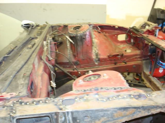

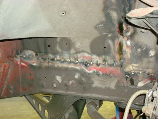

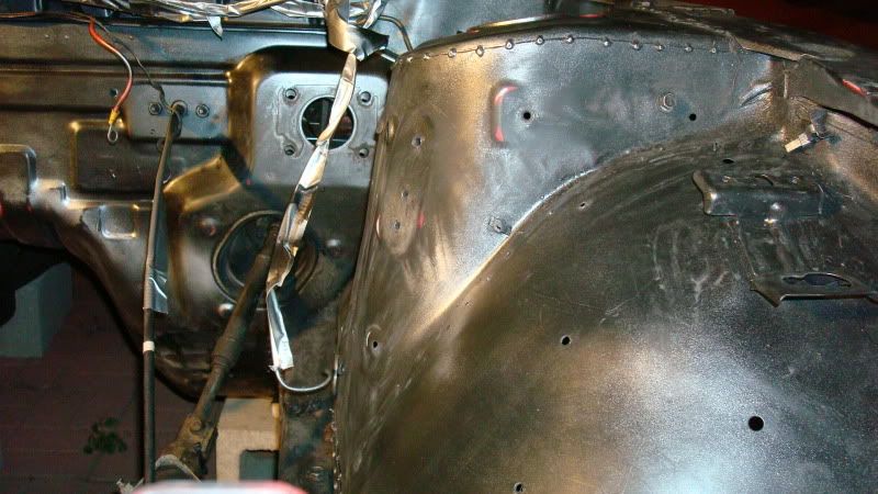

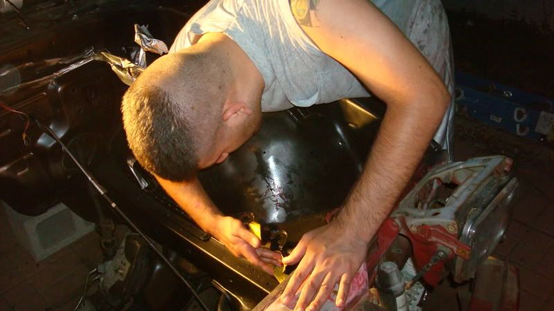

the latest thing is the car is being handled by Guerro at his shop
he is stiffing up the car by spot welding the car at ever few points or more flex areas
he had only been working on the car for 2 hours at this point and already iam most impressed

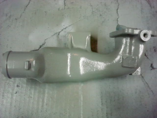

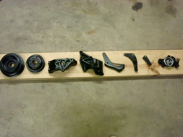

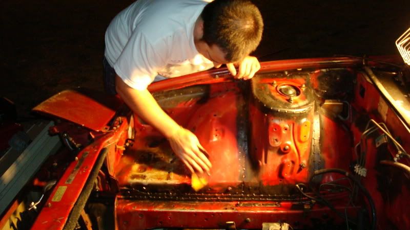

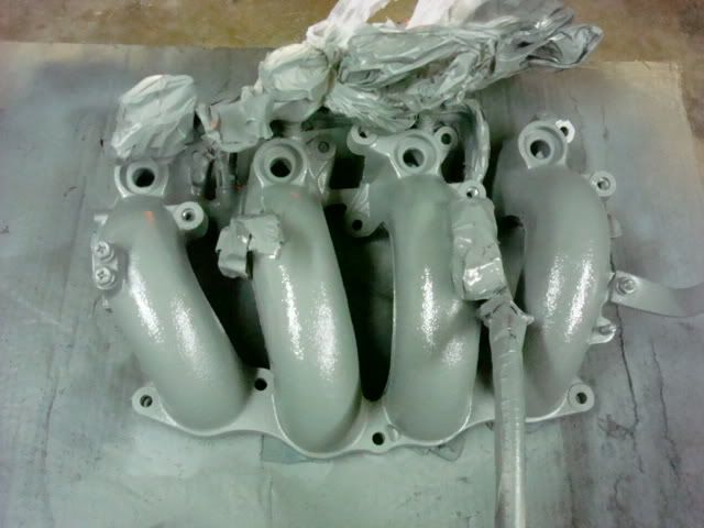

since there wasn't anything to do i decided its time to do all the little thing i wanted to do. like clean up and re-paint all my accessories
here are some i did last night i forgot my cam so i don't have any before and after pics but trust me they were rusty as hell
now there nice clean
here kinda the process what i did

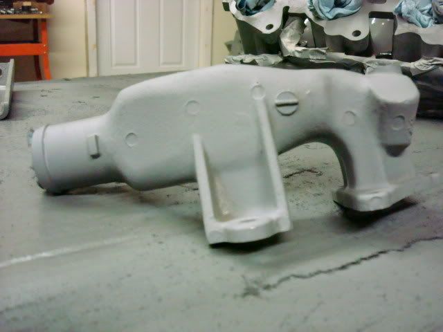

i went to vatozone to pick up some of that 500 degrees motor paint eer whatever ive tried this stuff before and its ok but sticks better with primer thats is designed for this time of usage
this is the high temp primer looks like when its sprayed on
i let is sit for about an hour till it dryed and sprayed the actual high temp paint added about three cotes looks much better in person and feels so smooth
i also did my intake manifold

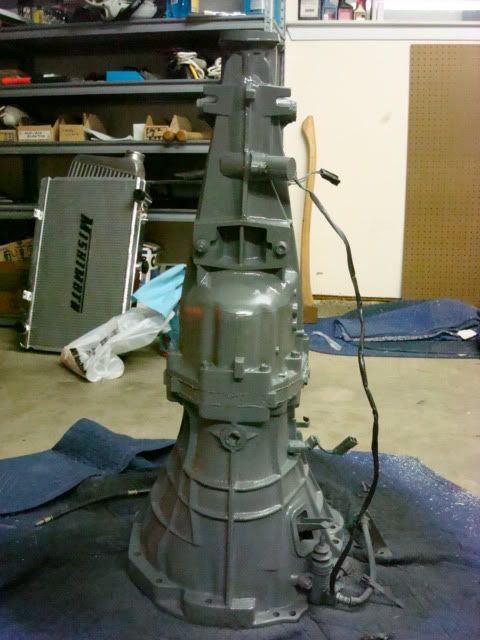

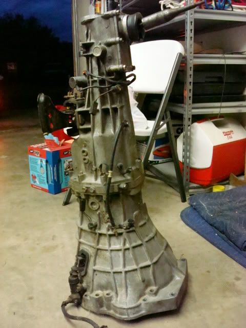

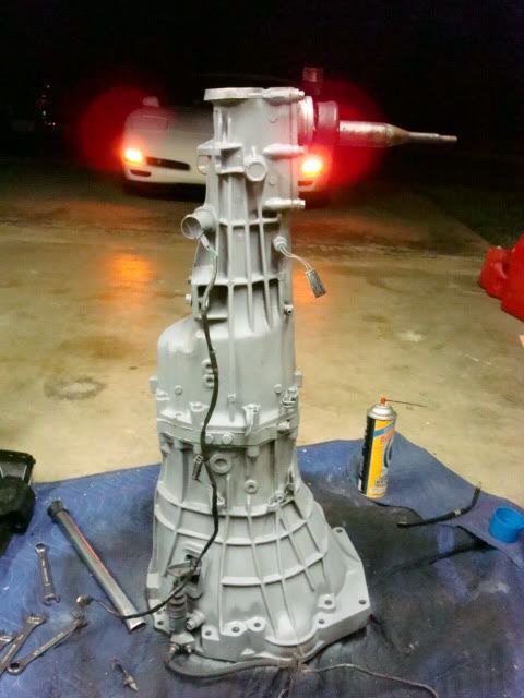

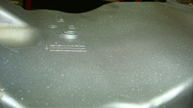

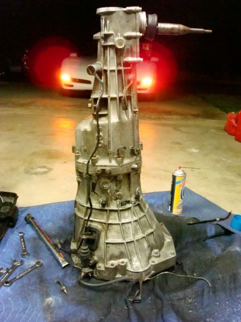

here my durty ass tranny and i had cleaned it before so i went round 2 on its ass
now its clean... sort of :/
i did the same thing as before
primed it up
new paint added
and now looks like this
im very happy the way all of this turned out

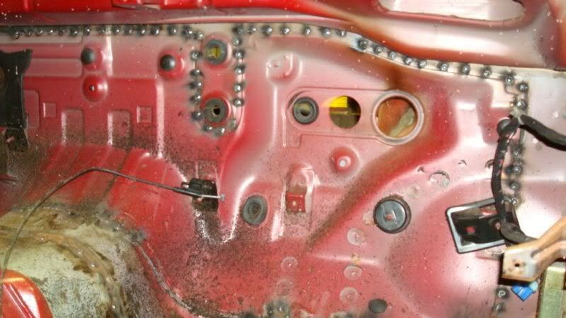

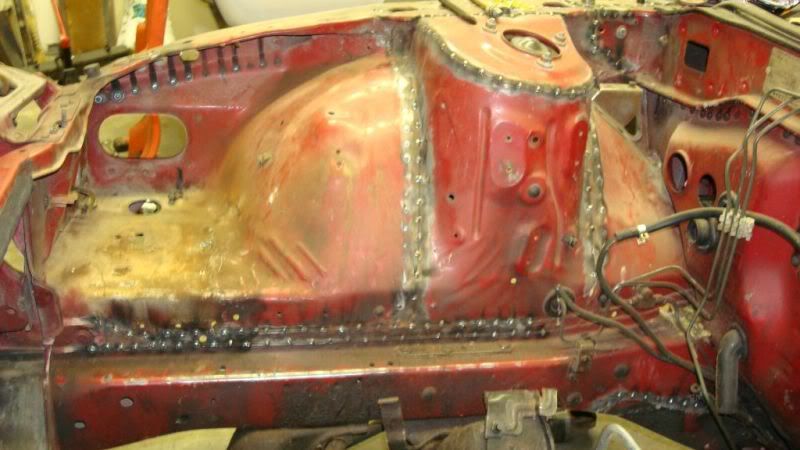

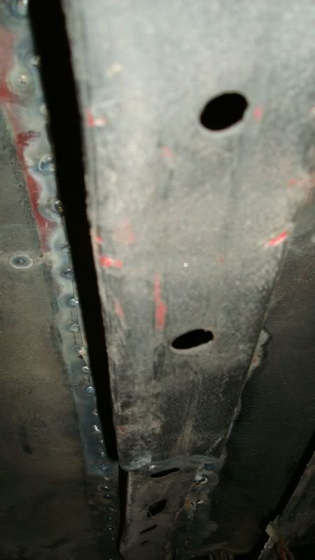

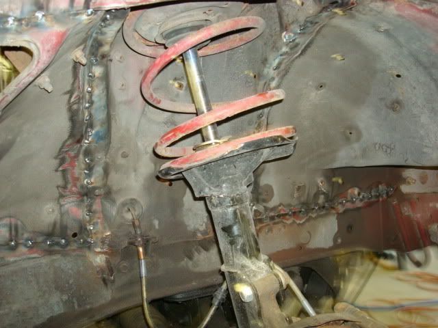

heres the new stuff you cant see much cuz of all the shavings here is more spot welding

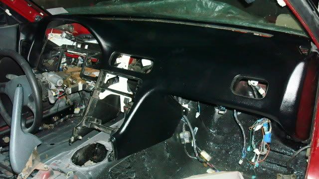

this is the inside of the behind the driver seat
here is the finished product of the strut tower area
under the dash back side of the fire wall
chasi rails
this was a hard pic to take but both sides are spot welded
tranny tunnel

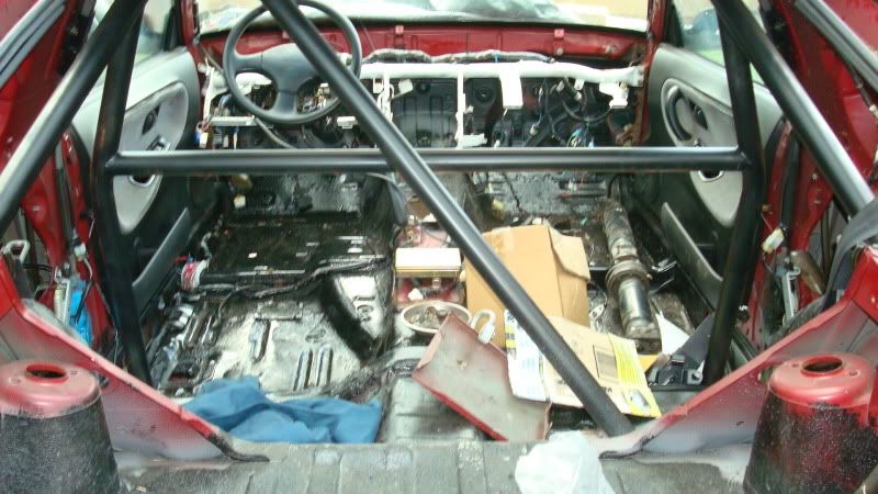

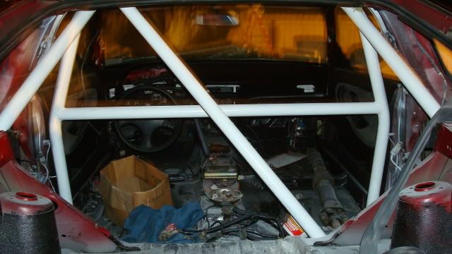

the roll bar
very basic i know

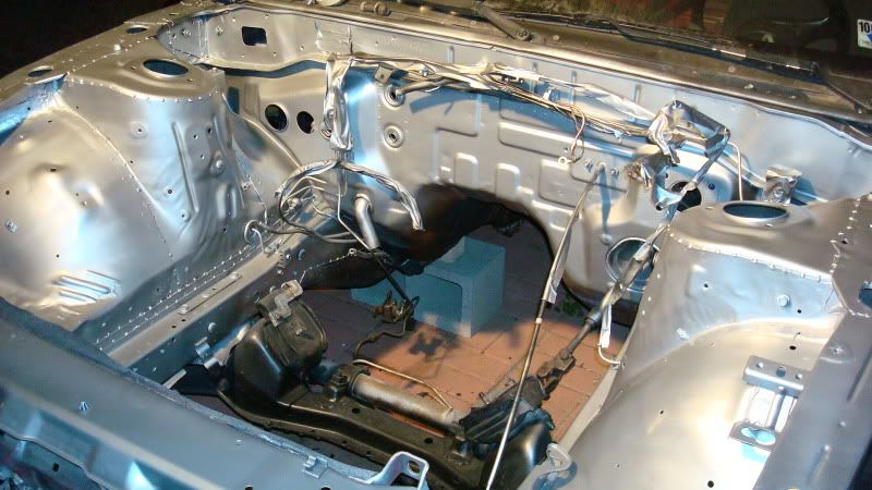

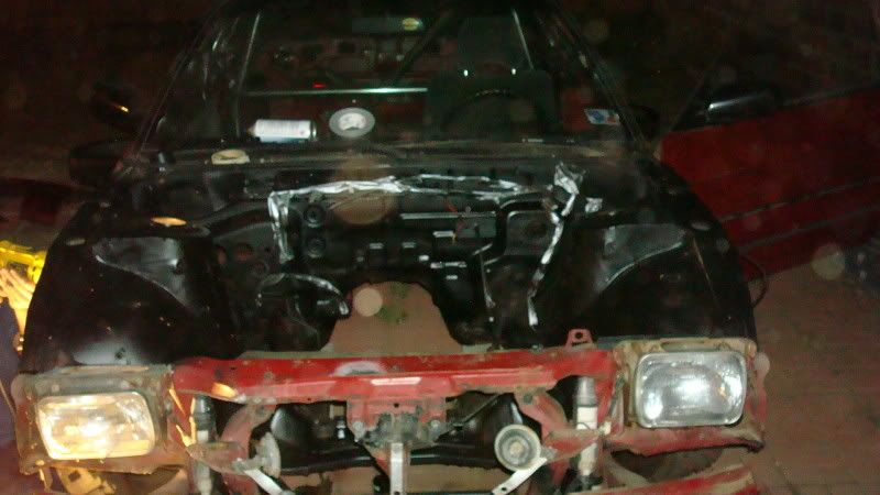

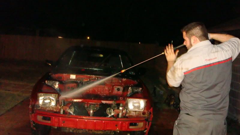

power washed the bay
the undercarriage
started sanding the bay
me still sanding some more
Old 05-27-2009, 12:16 AM   #10
surge s14
surge s14's Avatar
Location: Laredo Texas
Posts: 1,125
surge s14 is not welcome here anymoresurge s14 is not welcome here anymoresurge s14 is not welcome here anymoresurge s14 is not welcome here anymoresurge s14 is not welcome here anymoresurge s14 is not welcome here anymoresurge s14 is not welcome here anymoresurge s14 is not welcome here anymoresurge s14 is not welcome here anymoresurge s14 is not welcome here anymore

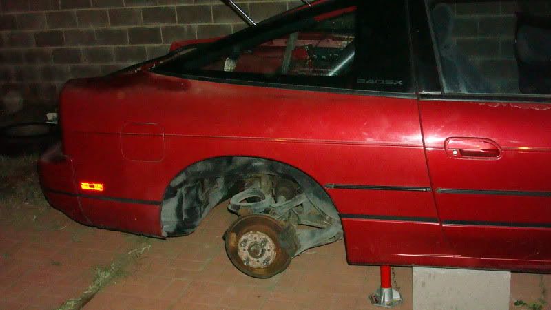

emoved all the suspension
Grinden the wheel wells
Primerd the bay
Wet sanding
Preping paint
Done

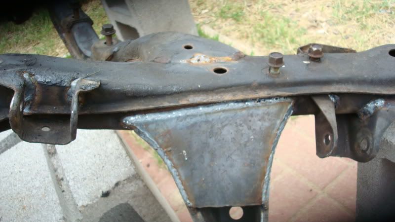

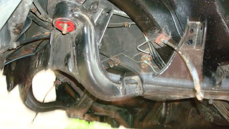

well she is going to back to the place where i got my cage done
(The Chop Shop Speed & Custom) to get some reinforcement

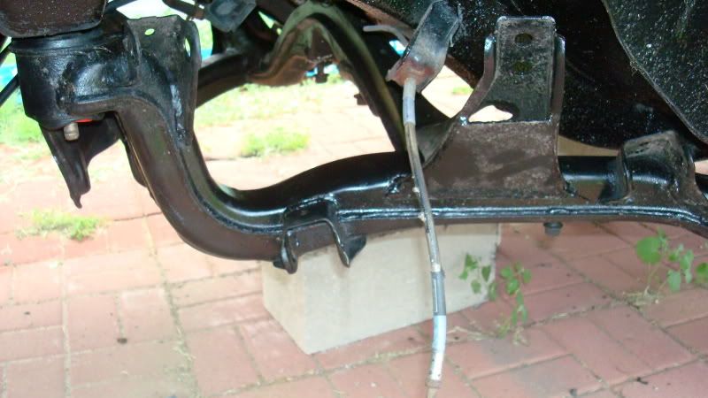

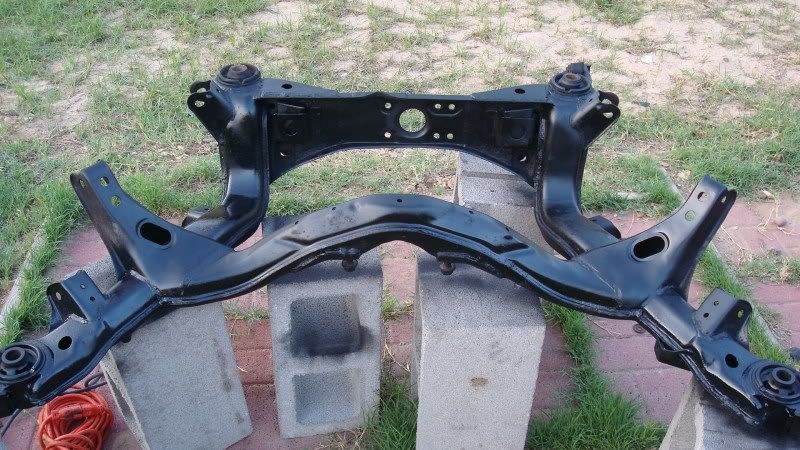

pics of the subframe
driver side
pass side
she should be strong

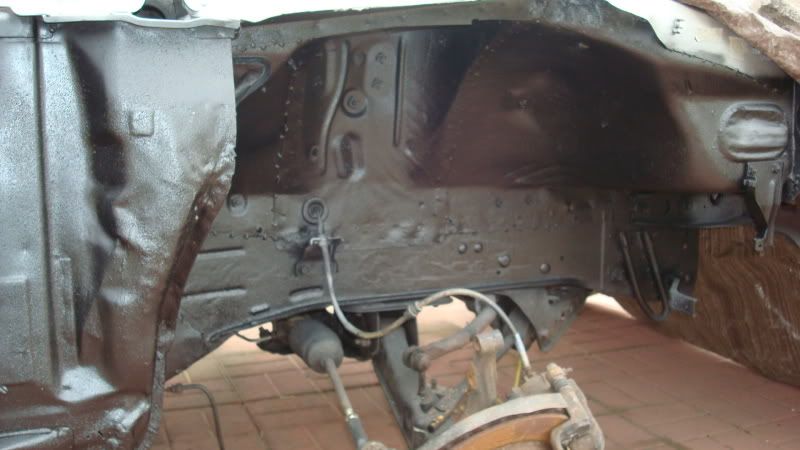

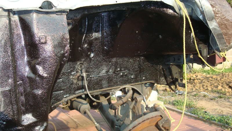

wheel wells
before
after
i used some protecting coating lets see if it lasts
also more stuff got here still waiting on back orders

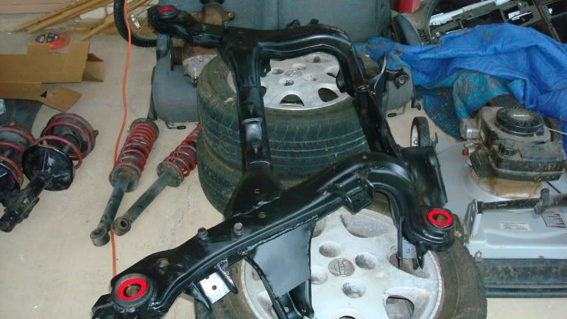

clean and painted

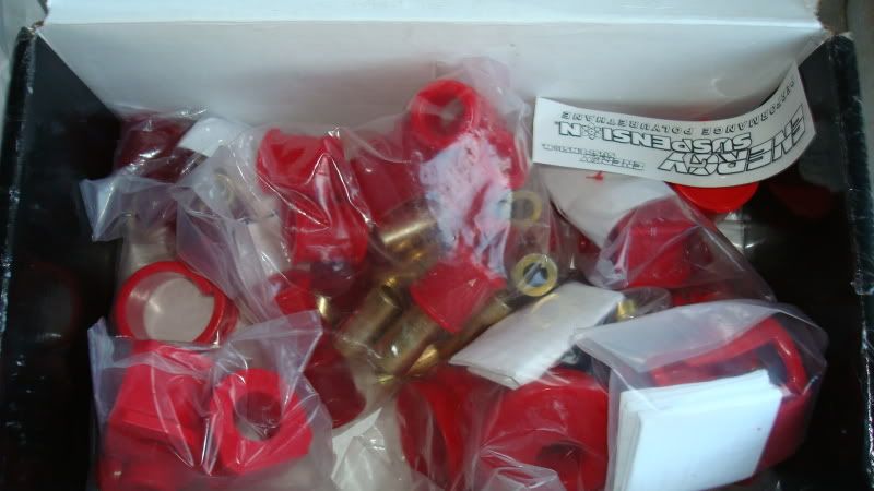

energy master kit ohh yeah!
the subframe is ready to rock

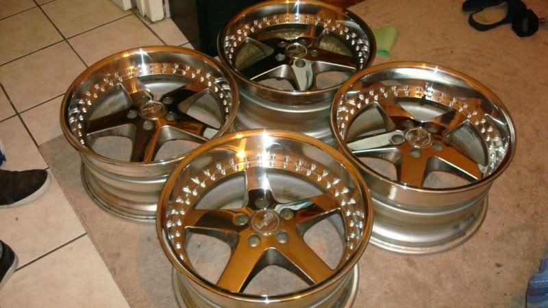

Those wheels look sick!

Sick wheels, everythings gravy.

wow those wheels are sick...cant wait to see the final result. Keep updating!

i would have done more work but rain fucked me up =/
here is the wheel wire tuck i dont want to eat up my harness when i lower my car.
bay wire work going back in
dash wire work going in fucking sucks
heres a batter pic of the bed liner on the floor board
sub frame put back in i ordered new bolts (took 4 weeks to get) since most ether broke or are just plane rusted to hell.
im going to order new collers since they look like shit
heres a better pic of the sub frame reinforcement

this is what ive been up to
i repainted the block and oil pan to give it the fresh look
i gave the oil pan the sparkly look
also my head was painted... oh so nice
my garage is getting full of parts i need to get this shit going lol
i repainted my dash it was a faded gray as you can see the color of the steering wheel
i painted the roll white but i might redo it kidda boring

White cage + maroon car = hot
