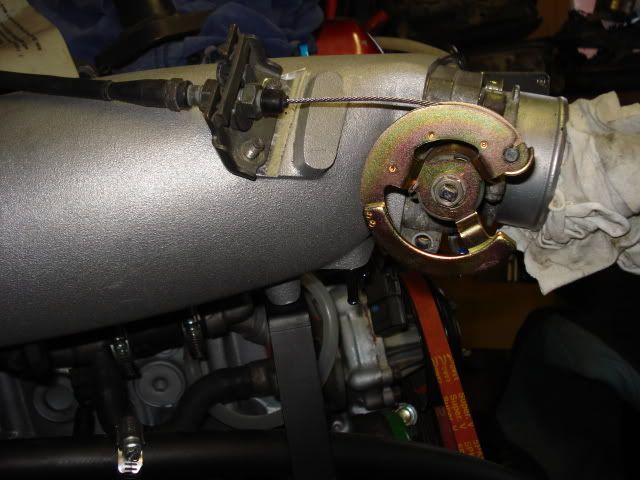

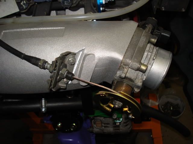

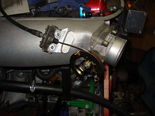

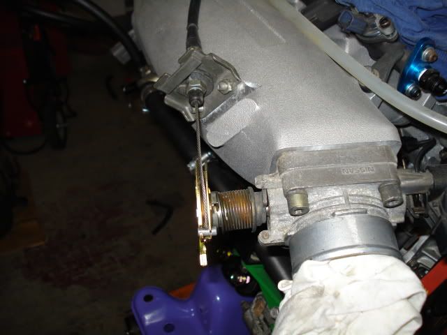

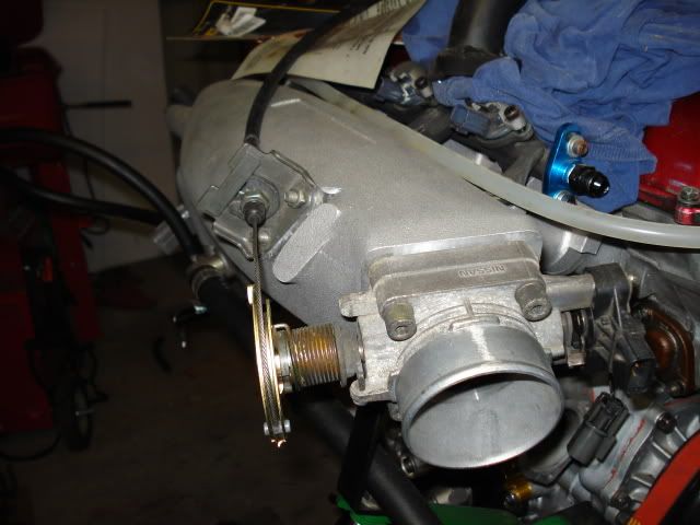

i just used the s-14 SR pully. bolts right on. and i can use the stock SR bracket.

s14 pully mounted. with NO mods to cable or bracket.
throttle body open, had to stuff a rag in there bc my motor is still on the stand but u get the idea
