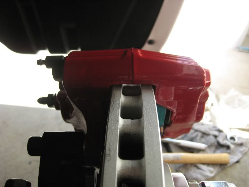

Originally Posted by westly7 View Post
sorry for stealing this but im doing big brake upgrade in my s14 that involved 350z track edition rotors,30mm z32 aluminium calipers,custom lines from enjuku racing,JSK adapter.
the problem is i cant figure out the extra banjo/rings that come if you buy jsk adapter.i know they located somewhere between caliper and adapter or between spindles and caliper in order to get rotors perfectly straight
westly, hopefully this pic should help you with the JSK adapter installation:
if that doesn't get your caliper oriented correctly then you need to space it with whatever method you find applicable to get your caliper to mount like this:
hope that helps you specifically.

fraktal ur awesome.i did it right but i still heard some grinding noises i guess because of the new rotors and pads.
right after installed i try to spin the rotors with my hand and they were only slightly grinded but after i put the wheel that noise start annoy me

Originally Posted by ^fraktal^ View Post
yes a z32 rotor would "work" in the rear with an sti caliper however it is technically undersized and would oversweep the rotor just as a z32 caliper with bracket would not fully sweep a z33 track rotor.
EDIT: I read that wrong. I get what you're saying now. It's a pretty negligible technicality though don't you think?
you're welcome. since you have new rotors and pads make sure you bed the pads in correctly according to the manufacturer, if they require it at all.
haha i think i said it wrong now that i reread it a few times myself?
basically the pad would not fully sweep the z32 rear rotor with an sti caliper. same as the pad on the z32 caliper does not fully sweep the front z33 track rotor. yes i would consider it a negligible technicality but it is something to consider when you mix and match different brake setups.
^fraktal^ is offline   Reply With Quote
