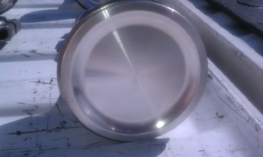

Something really neat. I ran e85 for 3.5-4 years and when I switched over I had recently built an engine and just got done breaking it in on gas so it had maybe 300 miles on it of gas and then the rest was e-85. I just pulled that engine apart and the pistons wiped clean with a shop rag.
I literally WIPED them clean! And they look perfect besides the skirts show that they were in an engine.
