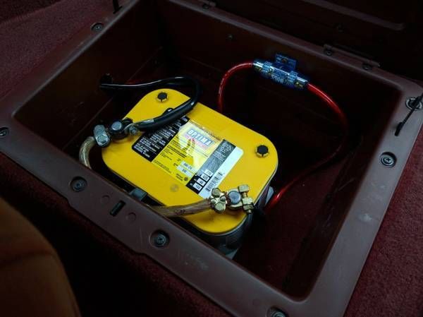

relocated the battery because there was no room in the engine bay, plus it balances out the car better.
