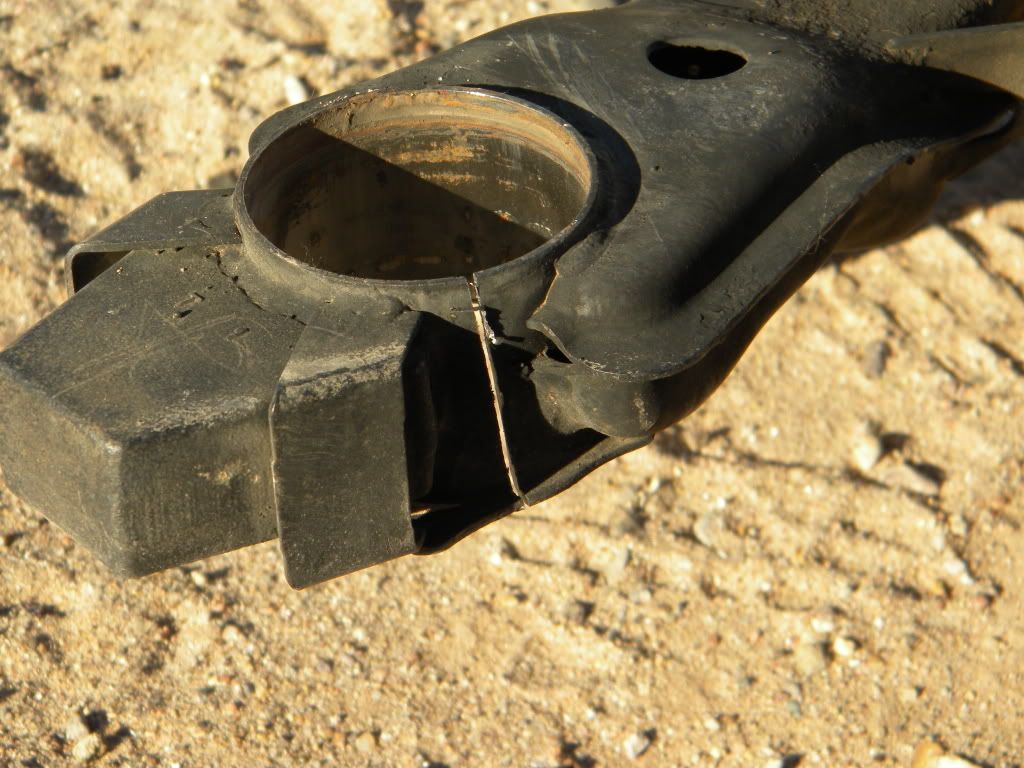

HELP!!!! Is rear subframe still good????
Ok i feel like a retard right about now but im in need of some help. I was cutting the inserts out of my rear subframe and came down to the last one...new blade an all, and well......I accidentally cut through the sleeve. Am i fucked or can i just weld it and still pop in my SPL Aluminum Spacers??? If iam then i guess i just blew $100

You better have a pro weld it. Cast iron is no joke.
If you want to wing it, make sure to really preheat the area before welding.

I should of mentioned that my buddy is a welder my fault but i CAN still use it right??? I dont want to have to get another one but if i HAVE to then i will

I think that would depend on how the sleeve looks. Pretty hard to tell you without pictures.
I'd probably have your buddy try to fix it, you've got nothing to lose.
I think you mean aluminum solid bushings, not spacers???
If you can weld it back, then yeah, no need for a new one.
But pictures would help.
Yeah bushings!! my fault again lol in a hurry typing...thought i was fucked!

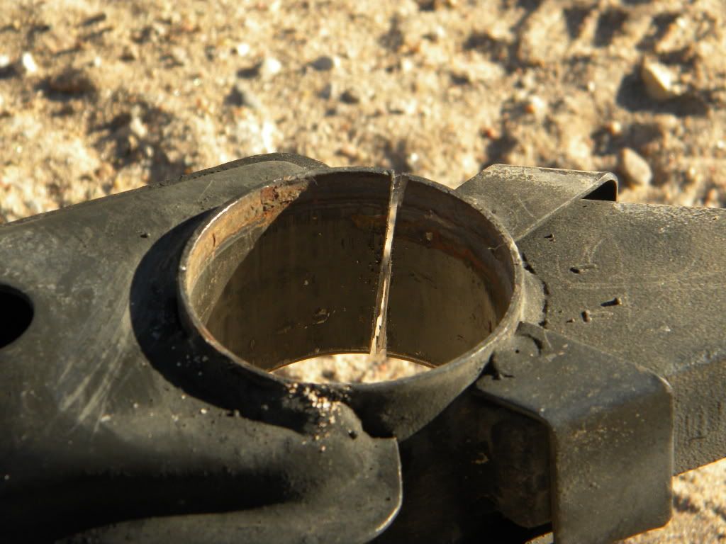

Backintoans13 is offline   Reply With Quote

Your better off with a used subframe

weld it back and reinforce it...if your friend is a welder hell know

if u can weld it do it i had mine rewelded as well but i didnt cut all the way through it. I have had no problem in 3 yrs

junk yard time!!!

I showed it to one of the welders here (I work in a metal shop).
He said, is your life worth $100?
It's possible to weld but hard to say if it will hold.

Hahahah cast iron? WTF? That shit is NOT cast iron LOL.....
Put the ALU Subframe risers in there.... Weld it shut.... then Weld a re-enforcement plate.... Should have been more careful... sounds like you were rushing it....

Totally agree. Thats 100% fixable by any welder. No need to reinforce it, a strong weld will be fine.

any competent welder can fix that

Cast iron.............. what?
Listen to the last 3 comments.
Totally fixable.....

Honestly i wasnt in a hurry till the last one lol but after i put the new blade in i really couldnt see under some rubber that wasnt completely off and before i knew i was cutting air lol believe me i felt like a jack ass cuz i KNEW to be careful. The other 3 came out cherry though

Yeah my buddy is a pretty damn good welder, he did my cage in my other S13 so i know he can do it just wanted to make sure that i could and not worry bout it. Thanks fellas!!!!

OOCH man! i would just weld the cut then reinforce it by welding a plate over it to be on the safe side just my 2 cents.

if i were you i'd just have it tig welded if you friend can do that, it's stronger and a small bead.

Yeah talked to him last night he recommended tig welding also, thanks for the tip
