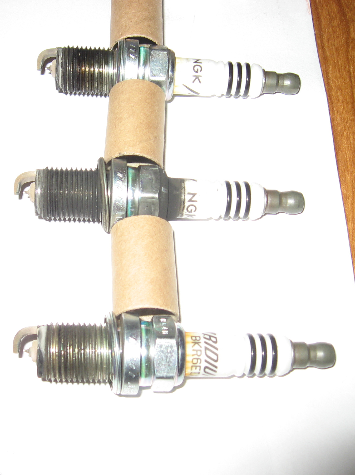

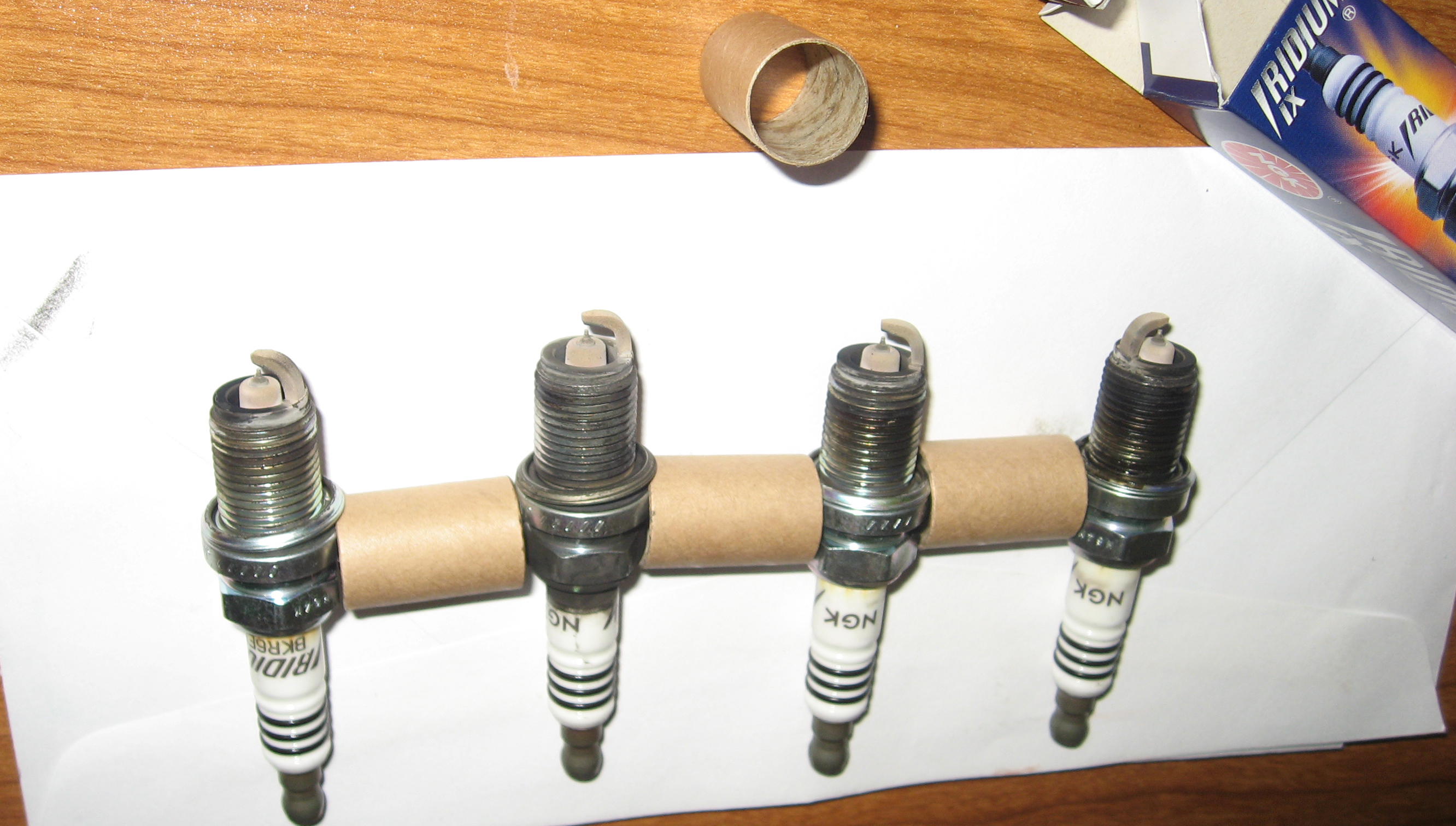

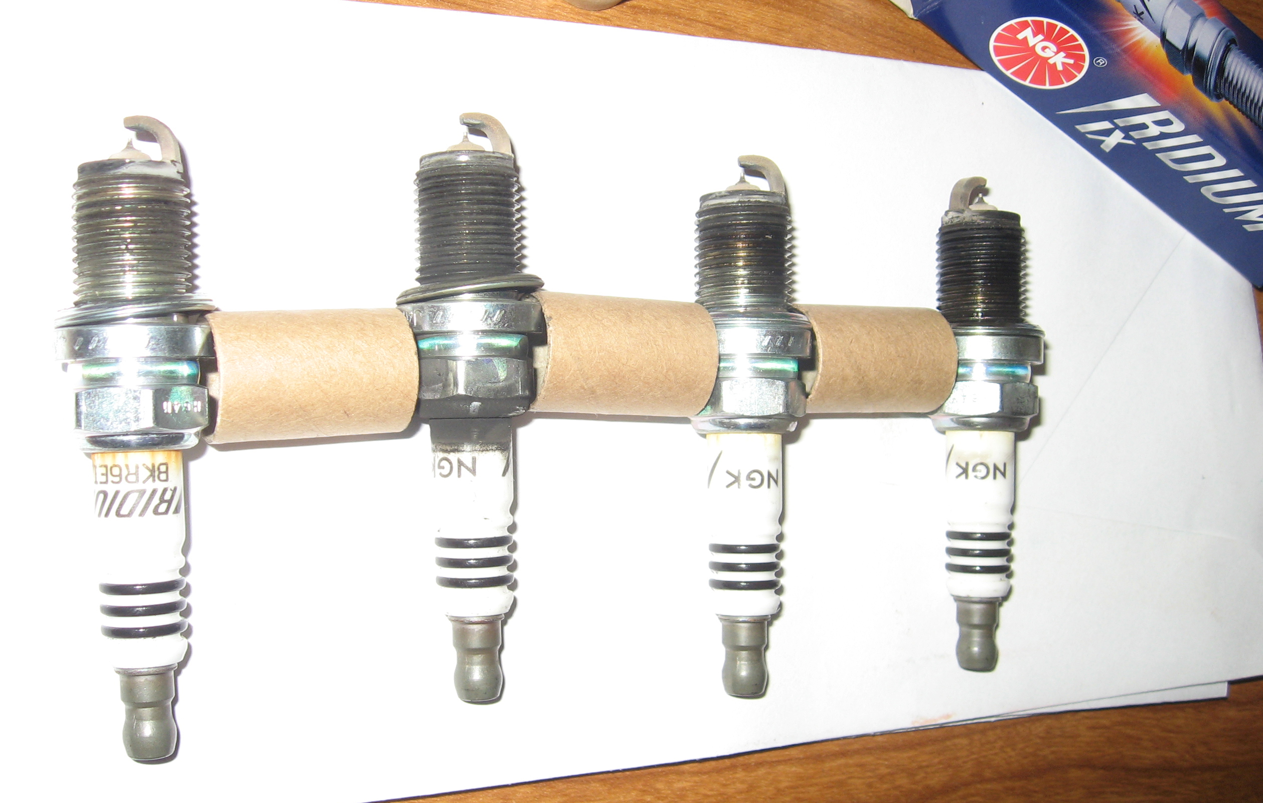

Whats wrong with my Spark Plugs? BKR6EIX.
My Friend wanted to tune his Mazda 3 so I went with him to pick up some NGKs. While I was there, I figured I would get some for my car as well. Picked up BKR6EIX's for my Blacktop S13SR20DET. Its been well over a year and a half since I last put BKR6EIXs on mine. I figured I was well over 30K and should change them.
After doing his car. We decided to see how my spark plugs were doing. The first Opened normally, there was a bit of torque there. So I using the wrenche I got it out without a problem.
2nd was completely loose, 3rd and 4th came off easily as well. I didnt even need a rachet to get those out. Thats not good.
I remember when I put them on. I had this guy I used to know who worked at kragen, he tightened them for me telling me 'this is how u do it'.
My specs are:
Stock S13 Sr20det. (Internals etc.)
Stock S13 T25 Turbo
Greddy RSPL FMIC
Walbro Fuel Pump 255 lph
Greddy Type RS BOV
3 Inch Straight pipe/Test pipe.
Pics are:
Is this due to the plugs being loose? Or does that tell you something bout the engine? Am I running Rich?
I already put on the new plugs. And tightened them more than normal. It seems to be running smoother.
Do I need a tune? Was having a loose Sparkplug bad for the engine? Did I cause damage?

2nd looks bad like water or coolant got in when you pulled it out was it alil wet or grease on it.?

No grease, or water. Just black. Exhaust dust?
Third one or fourth one I dont remmeber had a lil bit of oil on it. maybe a drop.

Those plugs are not cold enough, What boost you running? Id say the plugs are showing the engine is running a tad on the lean side of things. Id go for 7's next time, Im running 8's.

you should run ngk 7's. it does look like you're running a bit lean. how much boost are you running on that t25.if you're around 11psi or so i'd upgrade the spark plugs to 7's.
