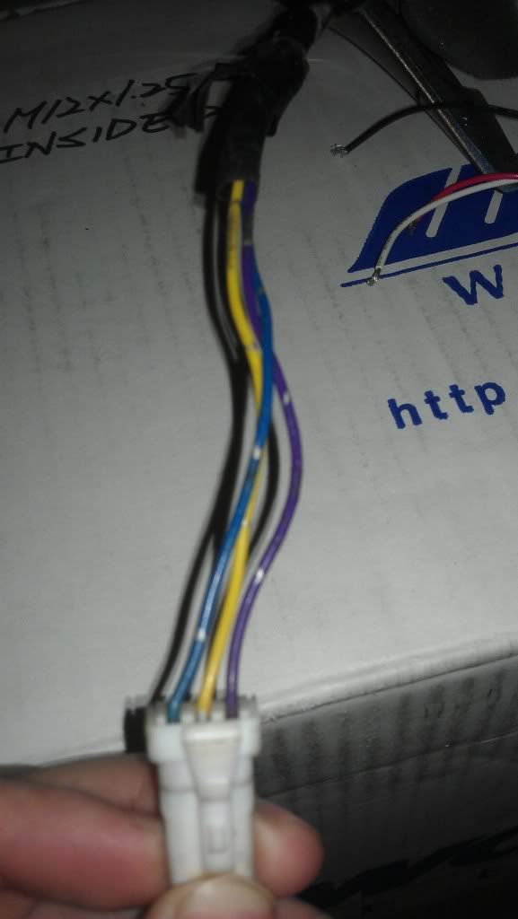

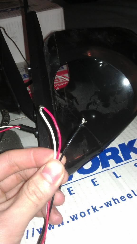

hey guys need help recently got some fake gizzandors i took off my existing side mirrors i think they came off a maxima so heres my question
the current color wires on my side mirrors are blue yellow purple
on the gandors its red white black
what order do i put the gandors wires in the pin thanks so i can plug it up =]

Use a test light your chassis harness first. figure out what does what when u use the mirror adjuster. And then use a battery with a fuse and test ur mirror see what it does.
And just wire it in accordingly to your results.
