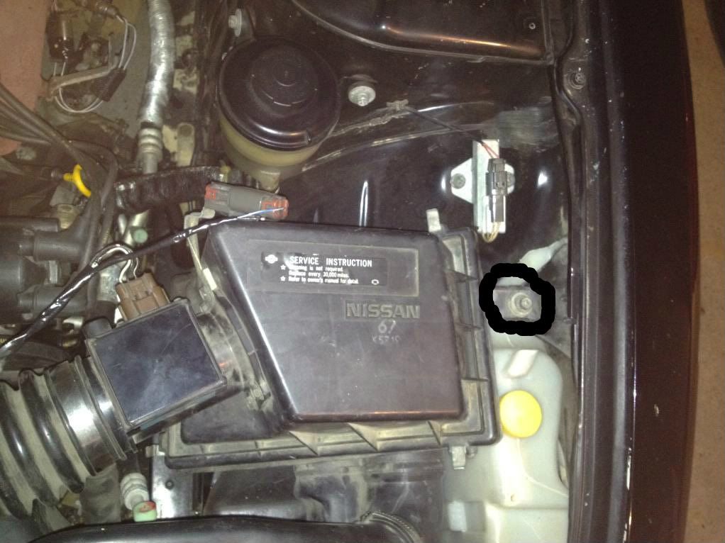

Unclip the sides of the airbox, and then unscrew this screw with the 10mm.

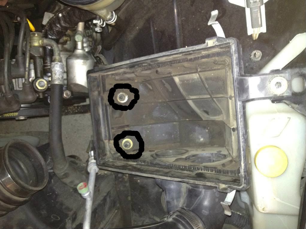

After unscrewing it, take the top of the box and filter and set it aside on top of the engine, or somewhere out of the way. There are two nuts inside the box. Unscrew the nuts and set them aside.

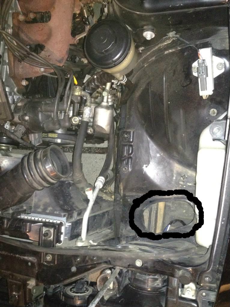

After you remove the nuts, pull the box and intake piping out of the engine bay. In this picture, I already had the silencer out because I forgot to take a picture before I pulled it out. I circled where it would be.

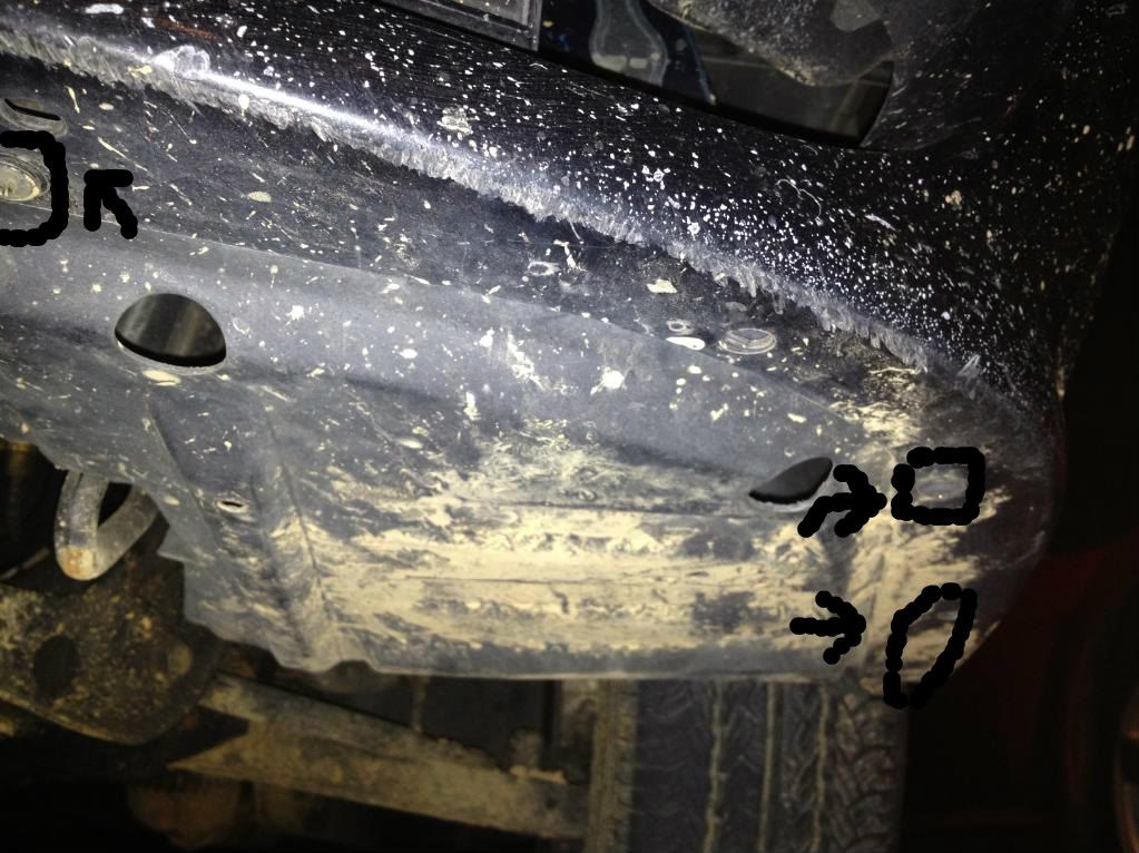

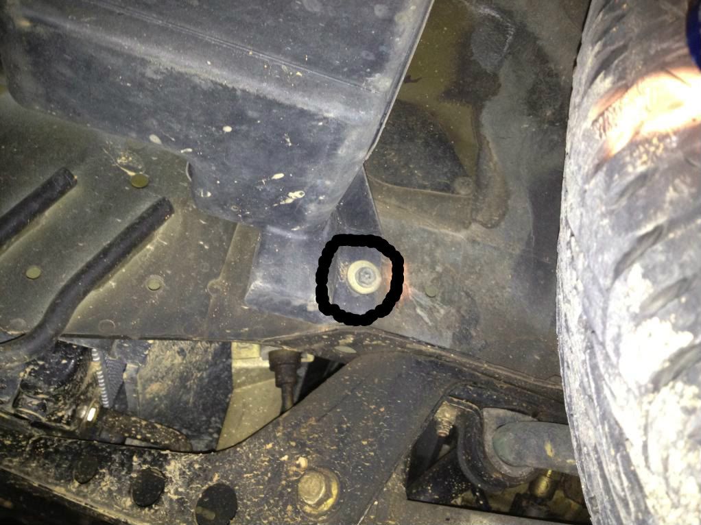

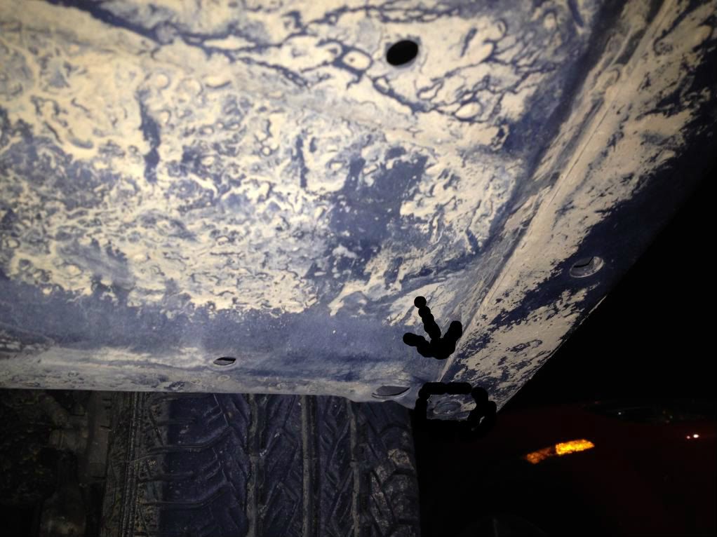

First off, don't mind all of the mud under my car lol. It has been raining all week and havent had the time to do a full clean. But under the bumper holding the rain guard/wheel well, there are 3 screws. Mine had 3, but yours may have more. But I circled where they were on mine. The second picture shows the far back one closest to the wheel.

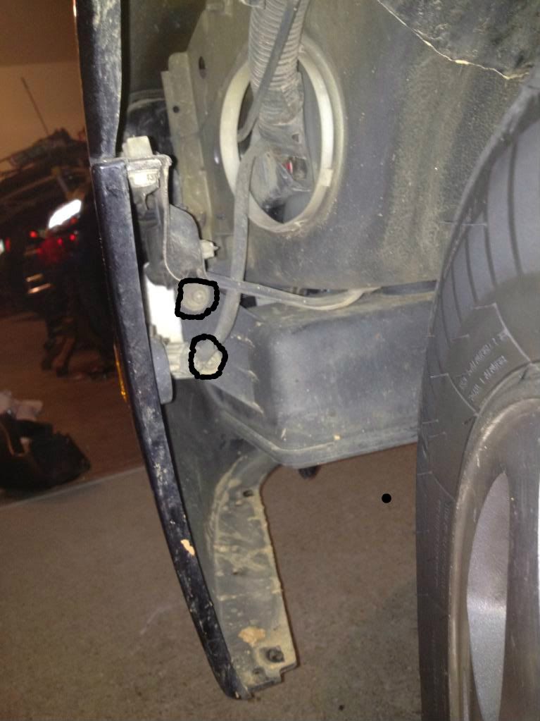

After removing the screws and moving the cover off of the car, turn the wheels to the right so you can see the screws holding the box. There are 3 screws in total. Two are right there when you look forward into the wheel well, and then there is a third one if you look towards the engine bay.
