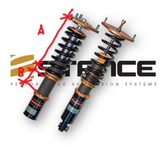

Many answers I have found are people who are saying that just lose the bottom collar (gold color below B), and turn the thread body (B). But in these two days of repeatedly adjusting the height, I found out this way might be a little problematic.
When only adjusting the thread body, it will change the height of the
whole coilver, which it will also change the ride height. However, at the end, you will find out that both rear coilovers are running on different height. It is because the weight distribuation at the back is different. I used the 6kg/mm spring rate and the difference between compressed height verse the uncompressed height to make an calculation, which in the results, the rear passenger side is approx. 800 lbs and the driver side is approx. 600lbs. This will give you a different compression rate when you racing on the track or driving on the street.
Therefore, I thought of another mathematical way to adjust it. Instead of only adjusting the height of the part B, I also adjust the height of A, which it is meant to acheive the same compression rate for both rear coilovers.
From below the camber plate to the silver plate on top of the thinner gold collar, I made couple measurements in A verses the ratio with the measurement in B. Based on the weight distribution, there is my current data:
(recorded when uncompressed, which means lifted up without wheel)
Passenger side A=10in, B=6.75in
Driver Side A=7.75in, B=6.75in
In theory, this should give you the same compression height/rate when the car is lowered, and they will give you the same height of 24.25in on stock rims from the fender wheel well to the group, which is no finger gap for both rear wheels.

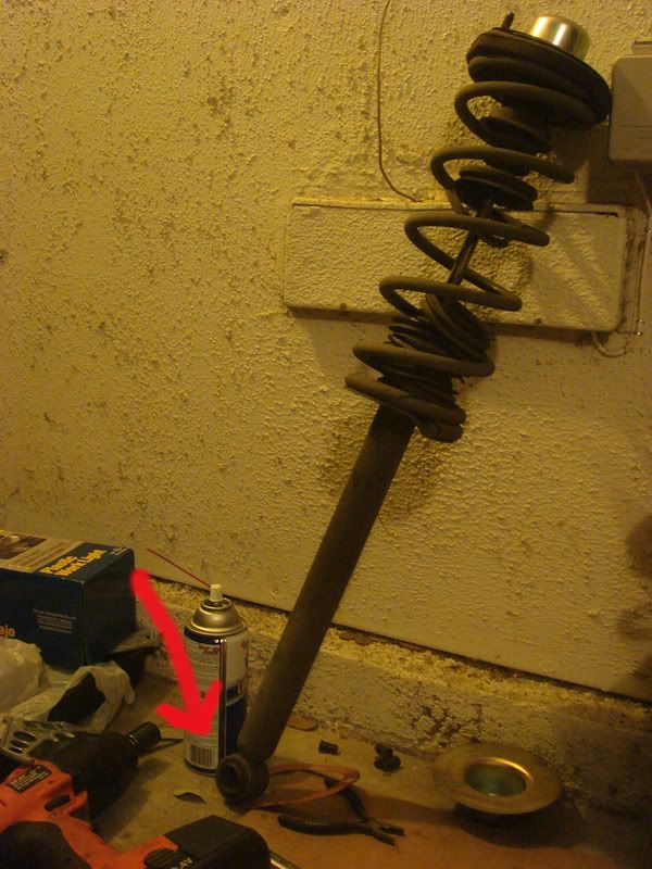

When I remove the original rear damper, I found out the difference at the bottom where it holds the bolt. The stance one is thicker which seems the bolt won't go in as much as the thinner stock damper. Would this lead to an danger of unsecured bolt?
