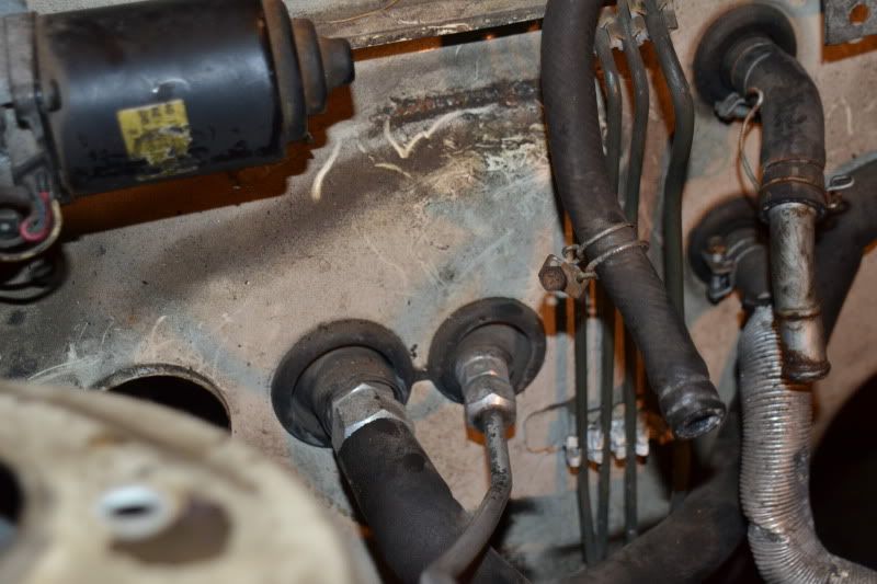

So i know its dangerous to remove the lines of the AC compressor unless youve previously had it discharged
im not sure if the AC has been discharged or not (just bought the car) but i was wondering if its ok to disconnect the lines at the fire wall here whether or not the system has been discharged
any help or guidance..appreciated

either hook up a gauge or locate a charge port and push the shreader valve down with a small screw driver to check.
Be sure to wear safety glasses or look away

Nice Yea you can remove them there, just (as stated above) do it slowly. Imagine it's a preshaken bottle of soda or something...low and slow, and let it come out that way.

those instructions were for checking the system only, Not to discharge the system.
Although R-134 currently have No Known Neg affects to the OZone but yes it is still illegal with fines up to $27,500 per day per violation. The EPA can also award up to $10,000 to the person who notificed them of the violation if the person releasing the refrigerant is convicted.

If it is charged you can install the motor and just secure the compressor in some fashion to the chassis (Zie Ties) then drive it to a shop and they can discharge it.
They can discharge it without it running.
