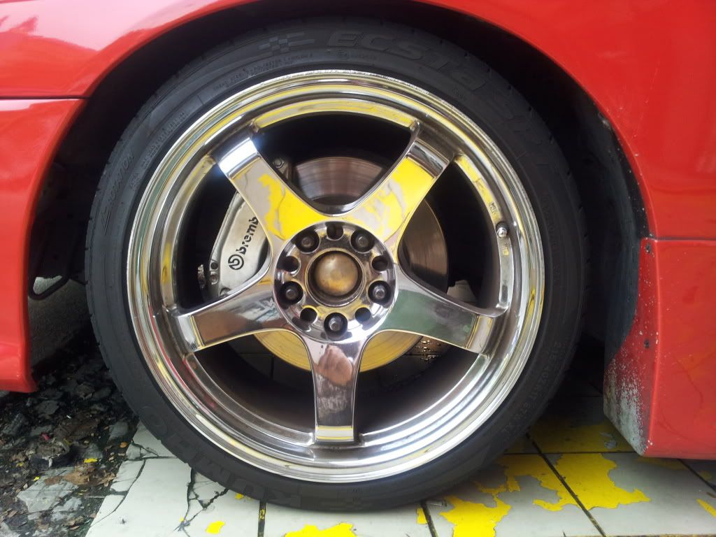

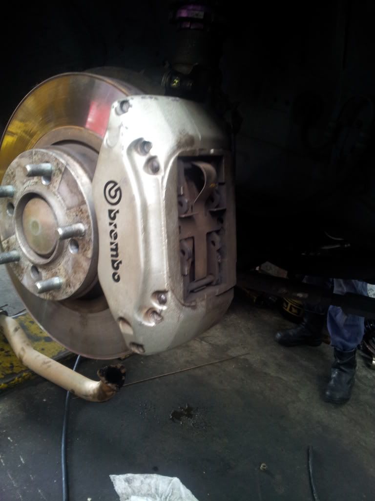

What Brembo's are this?
Hey guys..i got my s14 zenki recently..and it came with some parts. I am wondering what Brembo's are this? R32?300z? Idk. I need to get new brake pads soon. I also wana to change to bigger brake disk , Any recommendations on what brake disk to get? would it come with the appropriate Caliper brakets?. Greatly appreciate your help guys.

and if they are GTR VSPEC : 324mm x 30mm (4 pot brembo caliper)
than you supposedly can use z32 pads and than i doubt you'd need to up your rotor size, i would just look for a slotted rotor with a better pad combination and make sure you have ss lines and that your brakes are properly functioning because those should be pretty bangin

I dont know if thier R32 ones thou, any way to confirm that?. I would love to up a few MM cuz the stock rotor are preety small too . Currenly on SS lines too. Heard alot about DBA rotors. But am i suppose to get S14 zenki Rotors or R32 rotors? Sorry for the Noobness guys..bear with me.lol

The ones you posted, the gold ones, are not from the R32 Vspec.
R32, R33, R34 GT-R Brake Caliper & Rotor Specs | GT-R Canada
The ones you have look like R32 Vspec brakes though, never seen them in silver color.
For your question, you need to get the discs from a R32 Vspec or comparable. The normal 4 pot brakes you find on S14/15's and GTR Vspec are not the same size.
R32 GTR : 296mm x 32mm (4 pot sumitomo caliper)
R32 GTR VSPEC : 324mm x 30mm (4 pot brembo caliper)
You can use the discs from a 350z Brembo package, same size. Saves you some money.

hmm.. You think these are R32 V Spec Calipers?. They look a tad different thou.
I was hoping to get a 330mm Disk pref with the caliper Bracket thou.hmm

Actually looking at them...they do look a little different. best bet, if they fit whatever car you have them on now. Measure them and go with that. They look similar to the normal R32 brakes....

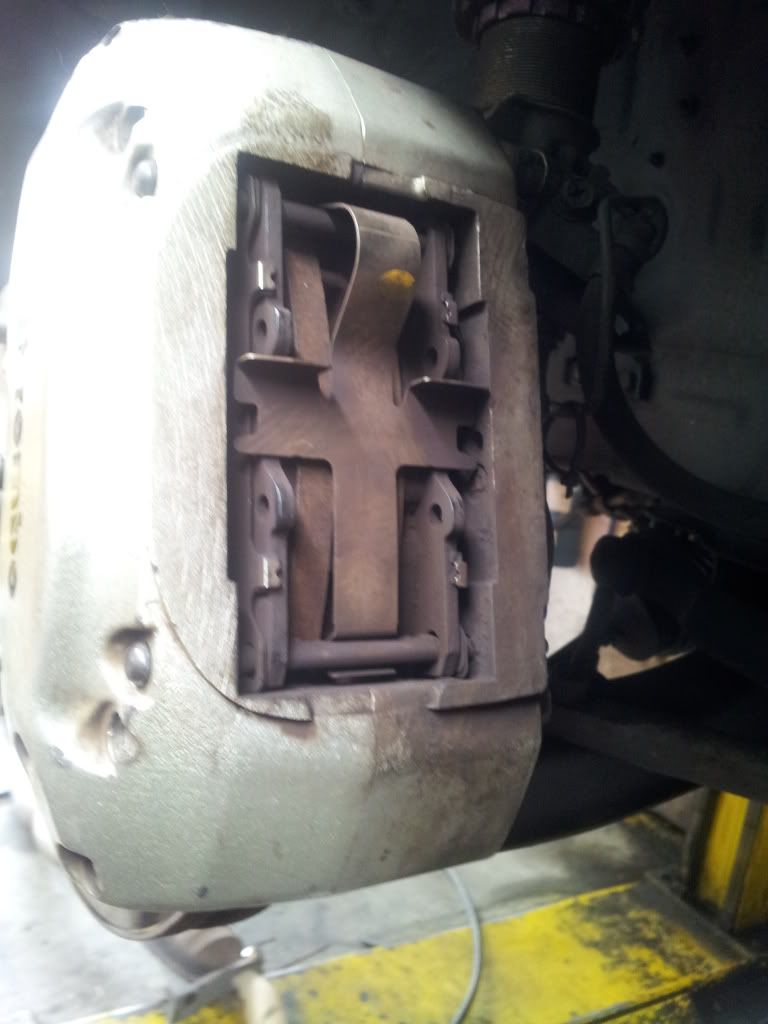

Guys these are NOT Brembos at all. They are R33 stock Sumitomo calipers with shaved off Nissan letters and Brembo stickers.

Aww..Shit i got dupped =(... So what are these worth?.. Worth keeping or Should i upgrade them?..so Im Suppose to get R33 Brake Pads and Enlarged rotors?. Is This from a R33 GTT?
