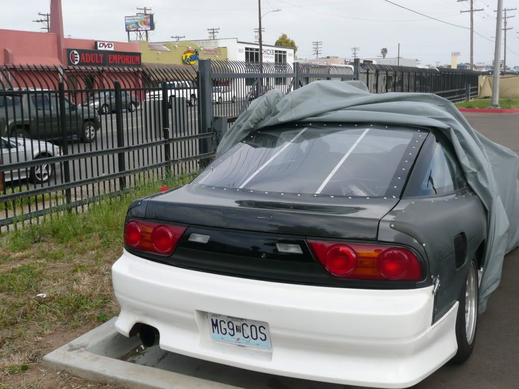

ok.....this was a fun project a while back......
look up a plastics company in your area.....ask them for polycarbonate.... lexan is just a brand name.... this will save you some money..... make a template from your existing windows to trace onto the polycarbonate sheet.... the only way to shape it is by putting the sheet on a clamped mold then putting it in an oven. using a heat gun will work breifly in small areas, but as soon as it cools it straightens back out..... there are several ways to cut the sheet, find out what works best for you. i used a jigsaw, then polished the edges with a torch CARFULLY! for the rear window you will definately need a brace(s) i used 2 1"x1/8" strips to brace. i riveted the window on placing a small bead of silicone to seal it.... if you want it to lokk better, paint the black border on the inside, before mounting..... here is a picture of my rear window before i did the sides.......
it is pretty easy to do....
*edit* if you use a similar brace, make sure you cut it long and bow it into place... it will probably take 2 people to do this.....
hope this helps! good luck!

get hte glass and bend it around your glass rear windsheild.. once its out trace, cut and rivet it on
dont think home depot has the correct stuff.. but as mentioned before fine a plastic company.
and dont wash with windex.. bad news

no problem..... glad i could help....the only difficult part is when you do your front side windows, you have to fabricate window frames for them.....

heating it will bend it temporary.... but as it cools it will straighten back out.... the only way to shape it like your stock windows is to place it on a mold and bake it in a huge oven.....

not at all, i didnt bake mine......but the only way to mount it without baking it is with rivets...... baking is only required if your trying to mount it like stock windows.........
polycarbonate is flexible...long as you support the rear window, when you mount with rivets the window will take the stock curve very nicely
