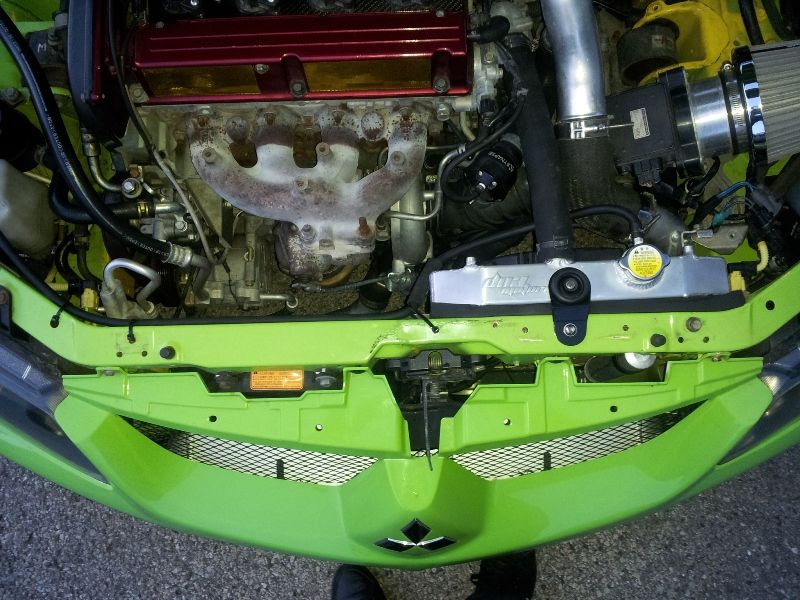

halfsize on evo
INSTALLED: EBAY Civic Half Size Radiator! - evolutionm.net - very tempting
