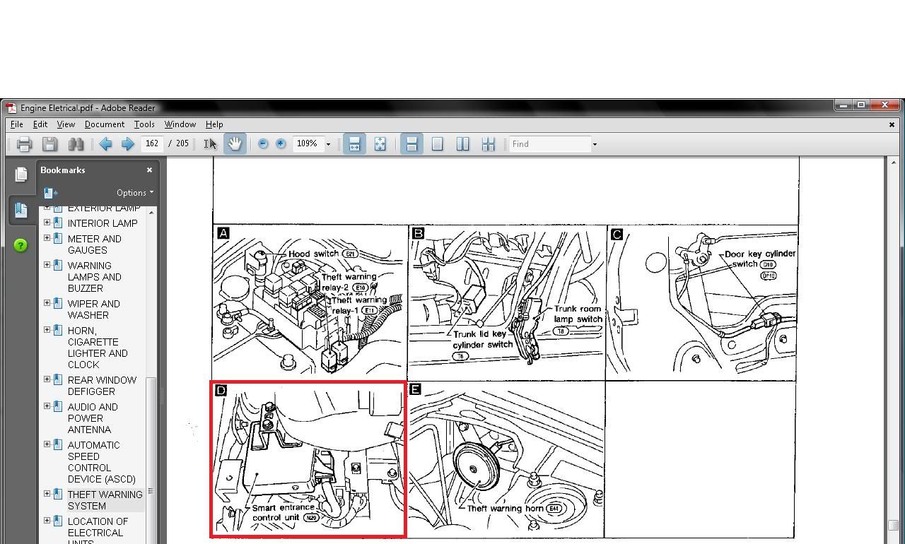

Ok, I was looking at the FSM for something on my car and I stumbled upon this..
I checked my car with this option and that control unit is the one that powers the door locks and has internal relay in the unit. it's right above the driver side kick panel fuse box.
hope this helps
edit: only thing else I can think about if your unit still makes the relay noise when you hit the door lock/unlock, the door lock actuator maybe dead. I ordered mine from amazon and been using it for a while.

Yea that was what I was talking about the secure entrace bs box mine still clicks but it wOnt unlock or lOck

I think if the OP doesn't hear the click at all the issue is at the smart entrance control unit that was were my clicking was coming from!

Ok, I'm back. Sorry, I've been working on a tuning program for my setup.
So, yeah. I don't even hear a clicking sound, so maybe I need to pull this whole box out. But, would my headlight chime be affected by this also or is it just coincidence that they went out about the same time?
