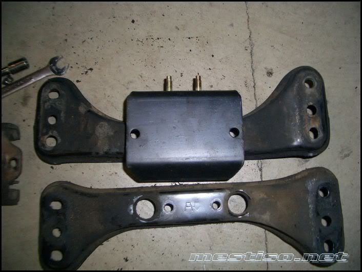

Here is a pic from my buddies web site.
Stealth-Custom-Fab.com

automatic crossmember has the letter A next to the arrow and the manual has a letter B next to the arrow
