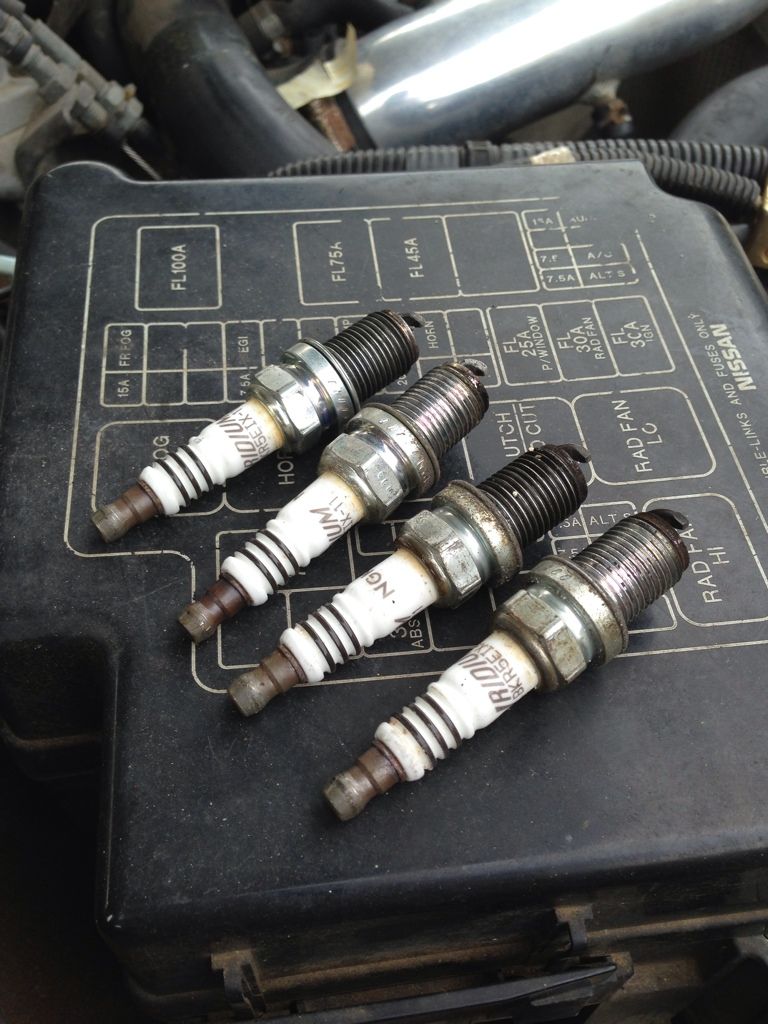

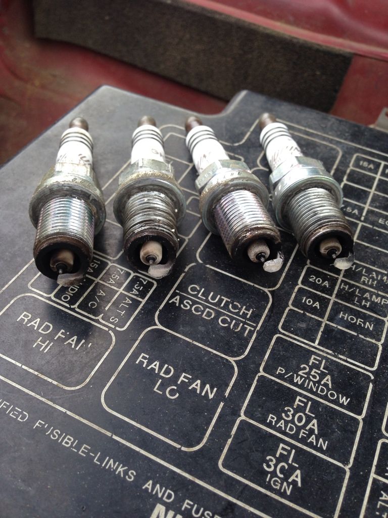

alright so here are pics of the plugs, left to right, they're from cylinders 1,2,3,4. they didnt really smell that strong of gas or oil to me. these plugs are about 2 years old now so maybe i should invest in some new ones? although like i said im not sure if this would be the problem if the car starts getting weird when its warmed up.
also i found out this past summer my cat is completely hollowed out lol. i guess i should look into replacing some sensors
and i compression tested the motor, 180-190-165-180, ive known cylinder 3 has always had slightly lower compression
any other help is greatly appreciated

Looks like youre running lean. Your spark plugs shouldnt be that white/ashy looking.
