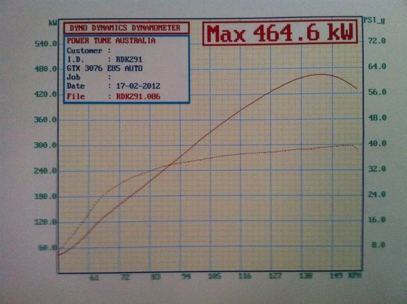

STR8E180 is an unknown quantity at this point
GTX3076
TiAL .63 exhaust housing
Brain crower 272 cams
Brain crower adjustable cam gear
Brain crower spring and retainer kit
GKtech rocker arm stoppers
POWERTUNE twin intank pump kit
POWERTUNE top feed rail kit
E85
blah blah blah blah way to much to list
if u want more info just ask i cant be bothered listing every thing thats done
STANDARD BOTTOM END

That is on stock bottom end? How long has that been holding up?

Ran 450 whp on 91 octane with a stock JDM gear box for 2.5 years...with a GT3076R...

Hell yeah dude! This what I was looking for. 450rwhp on 91 \m/ I hope I can get these numbers on mine. My car put down 637 on Q16 at I think 26-27psi with the GT35R that's on it now. My SR is fully built top and bottom too. Way too much lag for such a small motor so GTX3076R for all the way.
