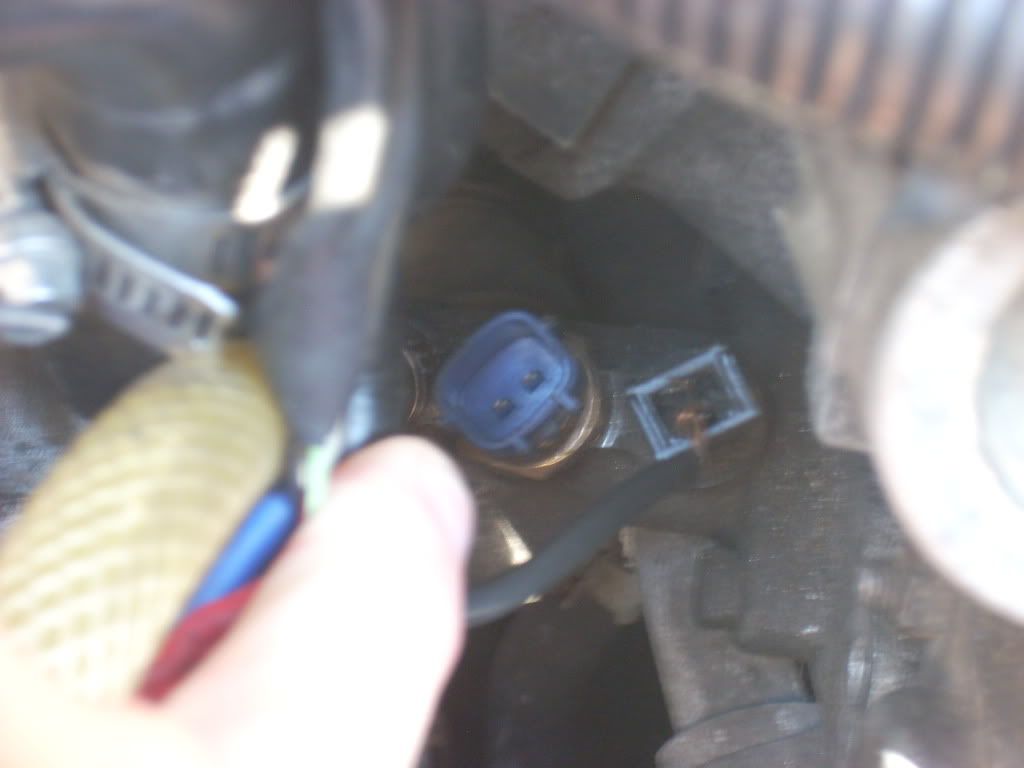

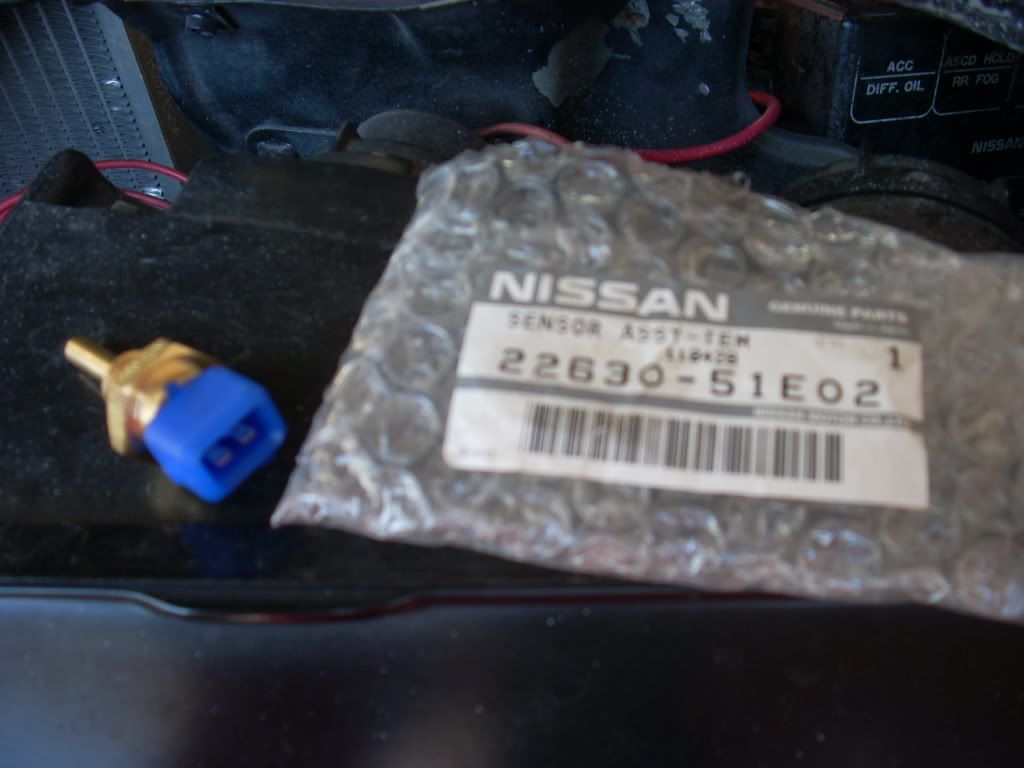

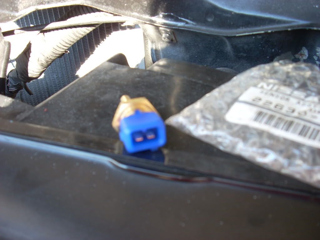

Alright, heres some pics...
Heres the new one i bought...
Heres the one i have...
Heres the plug for it on the harness...
It is very possible that whoever owned the car before me added this plug for some resaon, that could be why the sensor is different?

Actually no. That looks like you have an S14 SR coolant temperature sensor (the one in your car now). The 1991 sentra SE-R has the same as the z32 300zx and s13/s14 240sx.
What I'm assuming is maybe the previous owner of the engine had it swapped into his s14, and maybe he thought he needed to use the s14 sensor, but its really the temperature switch next to it that has to correspond to the gauge cluster you are using (this is all speculation of course).
Or... you have an S14 SR and you don't know it? Is there a notch in the back of the valve cover? lol...

Sorry for bumping old thread but the reason the plug dosent fit is because it's 96-98 s13 blacktop and they did lot little changes on the engines, you can easily use 95-98 240sx sensor.
