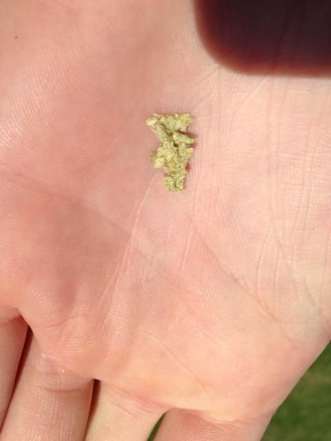

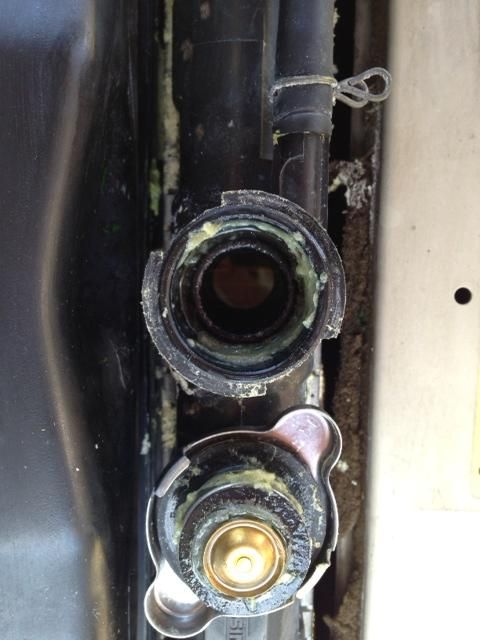

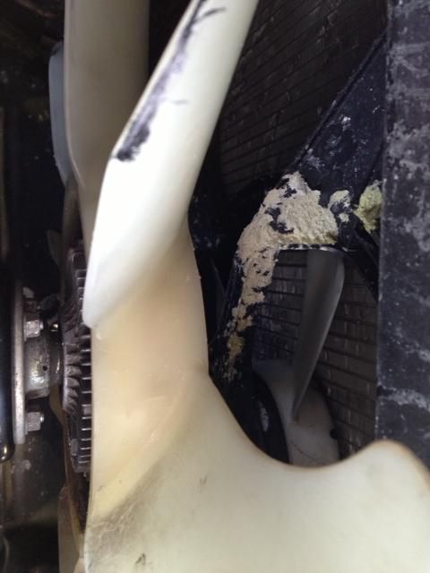

SUp zilvians, i just bought a 240 and i noticed theres some "gunk" around the radiator cap and inside where the cap is. The coolant looks ok, just some "sparkles" in it which seem to also be in the "gunk". The car drives fine and doesnt overheat, although on the way back it did go above the normal level when i pulled up to a toll booth (and prior to that i was going about 85, 3200rpms for a while, but it wasn't hot or anything). I was just wondering if this is some sort of "headgasket repair" crap or what? I researched it a bit and there was some mention of the incorrect antifreeze being used and it reacts with something and turns to sludge... Should i be worried?

Looks like a radiator repair with stuff along the lines of barrs leak. It doesn't look like barrs leak but a non aluminized kind of sealant.

The radiator seems to be leaking. The previous owner was too cheap to fix it so he put stop leak in. That's what you're seeing. Replace the radiator, cap, and thermostat and flush the system out. With the thermostat removed you can just run a garden hose to there and flush out the block.

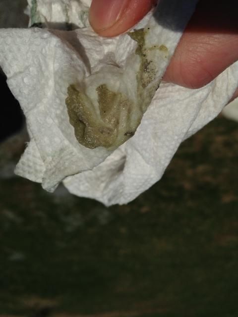

lots of speculation, anybody know for a fact what this stuff is? a coolant flush is a must, i think thats how i will proceed, hopefully it doesnt cause any problems

It is definetely a sealant. Might be stop leak. Never saw that stuff. But do like he said and flush everything and change the parts out.

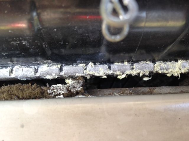

Could be really old coolant, could be stop leak.
Either way, looks like the tank and radiator core are separating.

you ARE in denial. that radiator is trash. there are certain tell-tale symptoms of when a radiator is going bad. you can attempt to have it boiled out but from the looks of it, its time to go. your being cheap attempting to hold onto a plastic radiator that isnt worth a damn. clearly, you dont have a good understanding as to how vital changing these components are - and how detrimental it can be when it fails.
you need to understand the cooling system as a whole. the coolant must be clean, the internals of the cooling system must be clean. all of that shit must be serviced. if you've got a gunked up system, its time to be serviced - or shall i say PAST DUE. and this is evident from your pictures.
