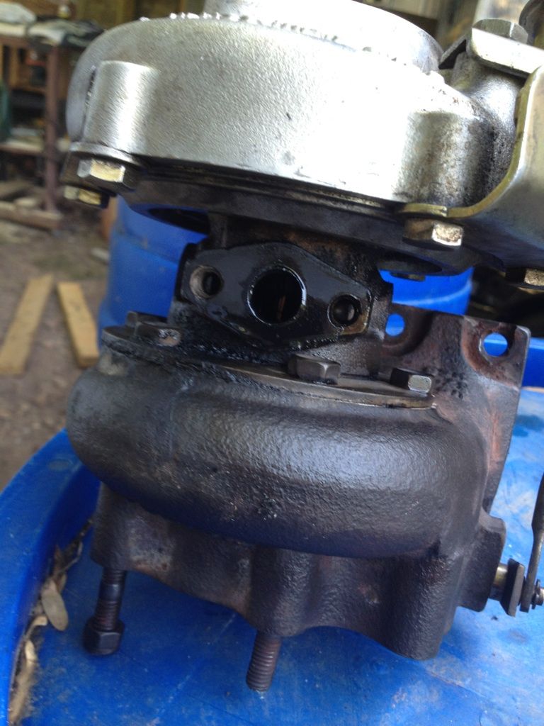

What happened to your Turbo? It it is genuine Garret, they have a housing program. You send them your old turbo center cartridge and they send you a new center cartridge. I think it is like $300-350. But then you have your brand new s15 turbo again.
nieko is offline   Reply With Quote
Old 06-10-2012, 12:10 PM   #21
TAP240
TAP240's Avatar
Join Date: Jun 2010
Location: South Carolina
Posts: 166
TAP240 is an unknown quantity at this point
previous owner only ran oil lines and neglected to run coolant lines to it and on top of that didn't use the correct oil feed line. The turbine fins look like a small rock got sucked in, it doesn't spin freely, and there is burnt, caked oil around the back of the turbo. It started clicking beginning of last week, then started making a scratching-like sound under the slightest load, so I pulled it off the day after that started happening.
