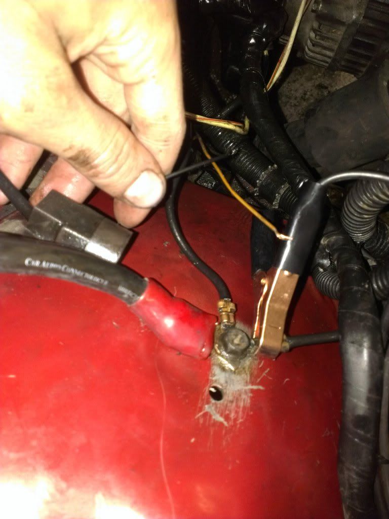

I have a maybe 8 gauge ground in the lower harness going to the block, one coming out near the injectors to the intake manifold, one on the exhaust side of the head, and one that's an uncovered strap with a connector, connecting to a tab on the firewall. does that sound correct as far as grounds go?
heres one by the injectors, what Is the sensor with the yellow ziptie around it? looks like coolant temp but I thought that's what the red connector was for
I feel like its a grounding issue, but I cant find a ground to blame it on.

Your grounds sound fine going off of memory. Do you have the ECU bolted down?
The sensor with the ziptie is one of the coolant temp sensors. It goes to the cluster for the temp gauge. The red sensor next to it is also a coolant temp sensor that's used by the ECU.

Any idea what this orange wire and black wire in the lower harness does? I've since moved the heavy ground wire from the chassis to the intake.
