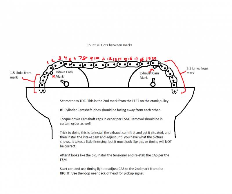

You need to ensure your mechanical timing is set dead on. Your cam angle sensor should be roughly in the center of the adjustment. I made this picture after fighting with the timing on my car after doing it like 20 times for the first time, now its super easy. Good Luck.
