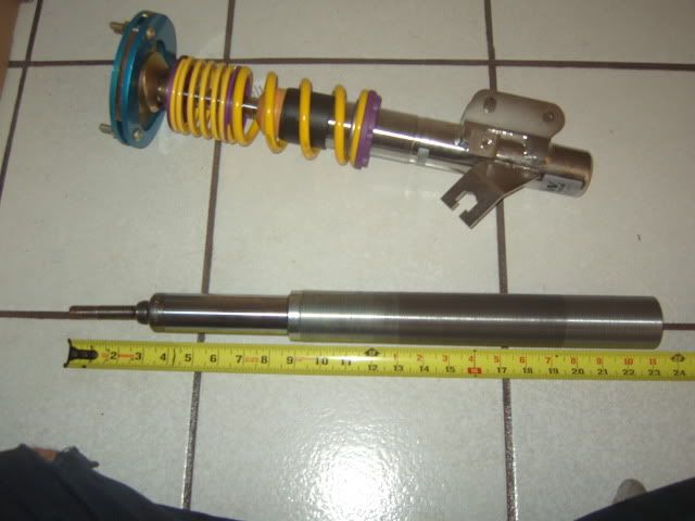

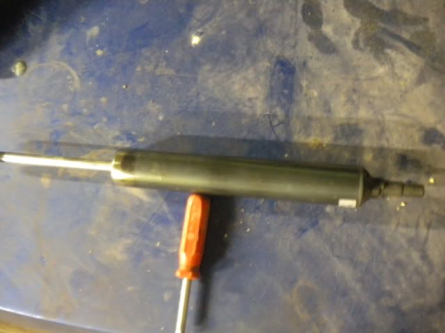

Now onto the usable info for the OP, i'm going to start with the fronts, and give you a breakdown on what you're looking at with the damper, some modified ones I've worked on, and what does and doesn't work. Some of this you may already know, some you may not, the stuff i'll assume you already know I'm still going to post for others that want to learn.
These are OEM Evo9 front Bilstein struts, they actually make a good usable option if you're willing to do a little work. A few things for those who are learning here, the chrome "shaft" that goes up to the strut plate is not a "shaft" it is actually the shock "body" it is hollow, the shaft is actually pointing down into the yellow housing and the piston is bolted to the end of the shaft, the hard chromed body slides up and down into the housing, between the housing and the outside of the body are a pair of dry slide bushings, these are spaced around 5" apart, at full extension the bottom of the body is ideally right at the bottom of the lower bushing. The outside diameter of the chromed body is 40mm, often shock manufacturers (you know those crappy chinamade,taiwanmade, etc junk dampers) will often quote the OD of the body as the "piston" diameter, know now, this is wrong and they're FOS. The inside bore of the body is 36mm and corresponds with the actual 36mm piston, inside is a dividing piston, some oil and some gas, at the top of the strut is where the gas is, then the dividing piston, then the area below the dividing piston is full of oil and the piston is in there moving back and forth in the oil.
Now that you know what you're looking at, i'll get on to key points of using these, the lower portion where it bolts to the spindle, of course we don't get lucky here and it isn't the same as an schassis, what you want to do is cut off the stock mounts, and weld on some ears to get a strut that will bolt to an schassis.
OMG, NO, YOU CANT DO THAT IT WILL BLOW UP, you say ?
No silly don't just go hacking and melting metal without doing things properly. See the picture below the Evo Strut, while no it isn't a Bilstein, its an inverted monotube insert removed from an S13 coilover (Silkroad), for a lot of things its essentially the same, you can see the small chrome actual shock shaft poking out, what you want to do is remove the insert from the evo housing, to do this you remove the locknut on the bottom which is threaded on the shock shaft, then there is a hex cut into the end of the shock shaft turn this to unthread the insert, once the threads clear the hole, you can pull the entire insert out. At that point you are freeeee, cut off the evo bracketry, and weld on mounting ears for your schassis spindles, bonus points for having the housings turned in a lathe to completely clean them up, though for all intents and purposes you can do just fine with an angle grinder here.
Bilstein EvoX strut after cutting off the bracketry and turning it clean in a lathe, with metal plates cut and drilled for the Schassis spindle
After welding on the ears and slipping on a coilover sleeve
A Porsche Bilstein PSS9, after cutting off the bracketry and then having the threads finished on a lathe, while these particular ones are too long to be ideal as-is for an schassis, this shows you what you can do if you start out with an appropriate length set, the thread is M52x1.5, pbm's finer thread coilovers use this so you could just get lower brackets from them, this is what I intended to do with this set, however errors on their part resulted in a lot of waiting on my end, a good bit of profit on their end, and a lot of useless parts on my end. You cant just take other Bilstein struts and have the threads cut like this because the OEM stuff are typically 50MM OD, I don't remember now what the Evo9's were but for some reason I think they may have actually been 52mm, which could be cut for threads, the X's were 50mm.
Another option is to start with certain coilovers that fit the schassis and modify the body to fit the bilstein inserts, they have to be big enough to fit the dry slide bushings into, and then most of them are so short that you'll need specifically modified strut bodys to use them, ideally with remote reservoirs, both of those features are what i'm using on the sets i'm putting together.

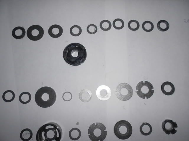

What is inside and what goes into a rebuild ?
Pistons:
Complete Bilstein PSS9 shimstack and normal digressive piston, none of this do you have to disassemble to do a basic rebuild.
Not going to go to far into rears tonight, maybe tomorrow if theres interest, heres some pics of the Evo9 Bilsteins on the rear, not ideal for super slammed height, but a great choice at reasonable heights.
Some random other bilsteins that I cut the lower mounts off of and welded on mounts from Q45/Z32 oem shocks.
