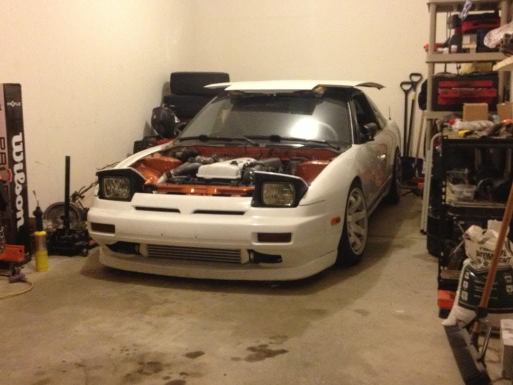

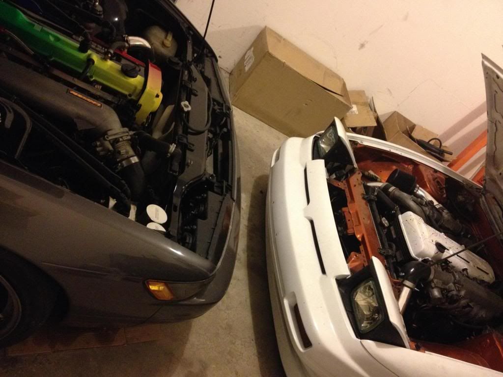

heres a few pictures of the car in question along with my built rb car haha.
thanks for any help
