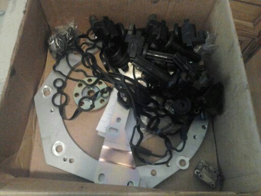

-For trading him that I recieved: Complete '95 Vh45de all accesories and coil packs, engine harness, ecu, maf, Xcessive motor mounts with trans mount and one piece driveshaft for s13, Xcessive alternator relocation bracket and Xcessive trans adapter plate. Also came with new valve cover gaskets and new rear main.

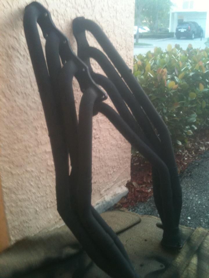

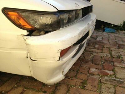

I then traded what was left of the beatup Silvia front for some headers and exhaust. The headers arent Mazworks or anything like that, they are some fabbed up ones by a previous 450sx owner, but they work and Ive heard them on the n/a Vh they were on and it didnt sound too bad. The exhaust is also home-made by the same fabricator.
So I traded this...
For these...
Again remeber I only paid $680 for the car running with the damaged Silvia front end. So far my only costs have been paying for the car, everything Ive recieved Ive traded for things I currently have... Now Im waiting on a buyer to (hopefully) buy my blown head gasket S14 Sr20det for $400, and I will use that money for a 300zx trans.

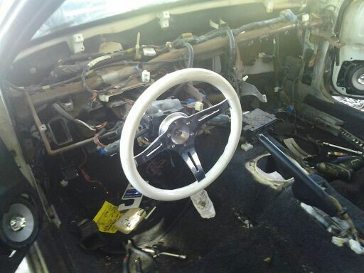

Got some free time.... My good friend Paul helped me out, we took the dash out and removed all the stupid ass a/c ****. Also took out the main body harness, Im going to relocate it under the dash so I have a neat and tidy engine bay :bigthumbu
Some pics...
BEFORE harness was removed...
AFTER--Still needs somethings removed and to be cleaned up
A litte shot of the inside as it currently sits...
Game plan is to finish installing body harness under dash and get wires extended/hooked up, put dash back on, and pressure wash the engine bay and start preping for paint.

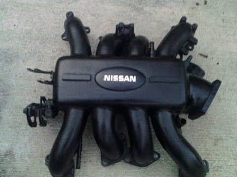

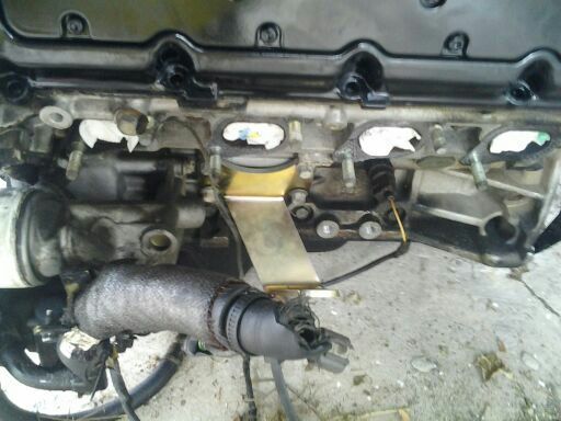

Intake with Nissan emblem I found...

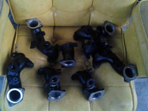

Intake Runners, hot tanked and lookin nice!

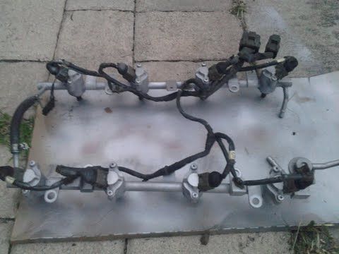

Fuel Rail sprayed aluminum (ran out of black)

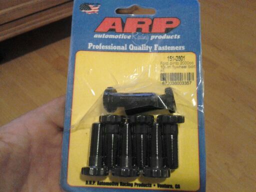

Been buying the last bit of parts I needed. I got these things in the mail.

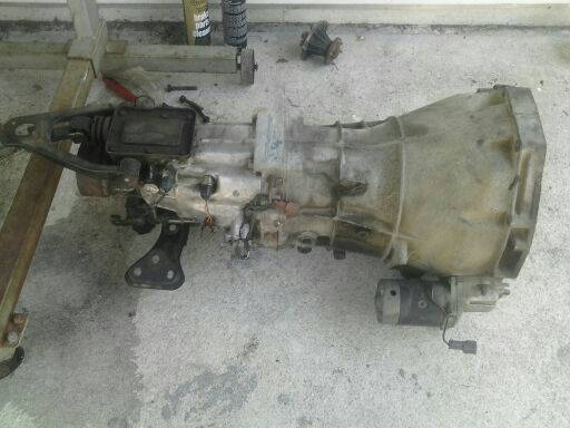

Also cleaned up the trans and alt with the wire wheel. Trans still needs a little touching up but looks way better already.

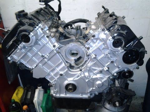

Little shot of the basic color of the engine, black top black pulleys and aluminum everything else.

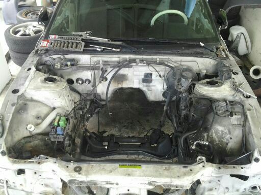

And Im starting to prep the engine bay. Removed battery tray and any other useless ****. Pressure washed it. About to wash it a little more and start sanding...

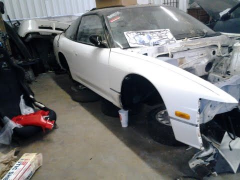

And a little car pic, I realized there were no pics in here of the actual car so here ya go...

I got a clean white pop-up front end locally for a great price

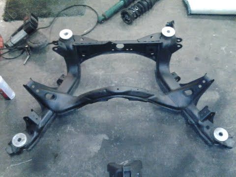

I pulled my subframe from my old chassis, hit it with the wire wheel and some undercoating to clean it up.

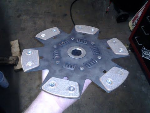

Got my clutch repucked

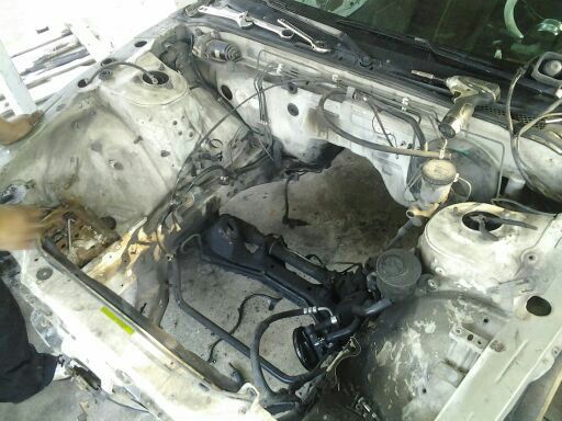

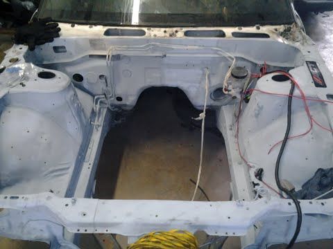

Almost finished prepping my engine bay

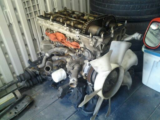

Took the engine apart, put new S2 chain guides, and wire wheeled the front covers and painted them. Oh and put new gaskets and seals ofcourse

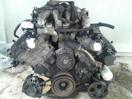

I got another vh out of a q45 that my friend wanted me to help him partout. Car was running great! I drove it around for a week before pulling it out!
Engine with Z32 trans and headers going on

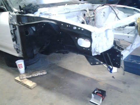

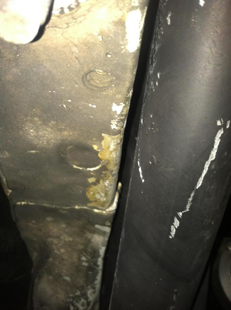

I pulled the engine back out to give the frame rail some loving to fit the headers. So I put it in and pulled it out a few times today. Here are some pics of how it looked when I left the shop today...
It still needs a little hammering but its very very close! I will be finishing it up tomorrow.

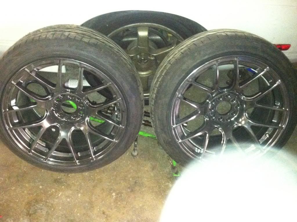

Installed rear 5 lug and the rear R.Y.O coilovers. And slapped on the set of xxr's I have tires mounted on. The R.Y.O's are soooo much better than my old Teins and go wayyy lower too! I can still go like 4 inches lower than this. And keep in mind the whole front half of the car is on jackstands in this pic...

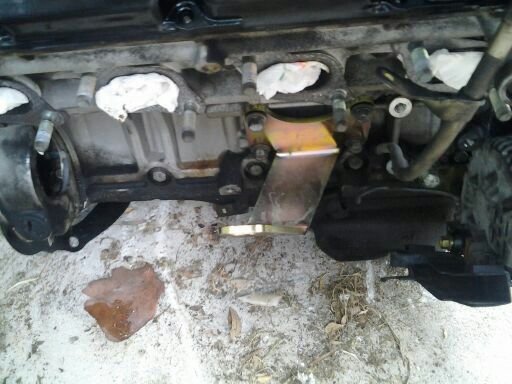

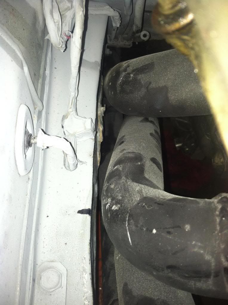

Also had to do some slight modification to the headers... Being that they came off of Abe's RHD Vh setup the LHD steering shaft came into contact with these headers slightly... But nothing a little metal work cant fix. These should be pretty much done tomorrow. I will have a lot more pics of the final product... For now heres a little teaser shot.

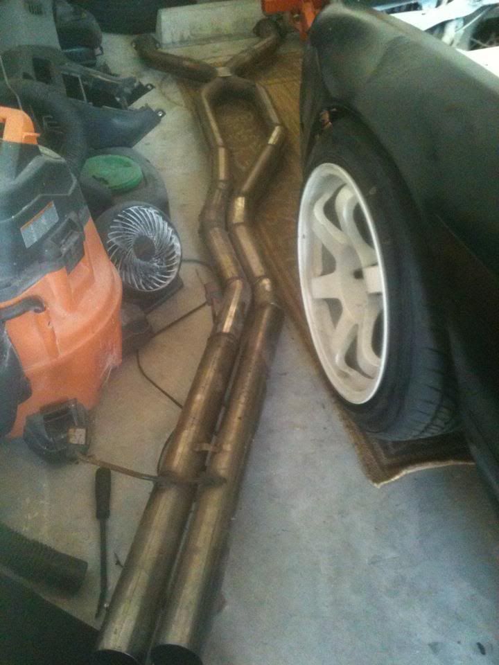

Almost finished on the headers. My welder went on a little vacation so it took a little longer than expected. Still wasn't as bad as waiting on Mazworx headers tho lol.
A shot of this beast of an exhaust bolted on, just to be sure that the collectors were in the perfect spot before they get welded up.
I cannot wait to drive my car! As soon as the headers get finished up tomorrow we will be doing the final test fit (thank God!) pulling it all back out and painting the bay! I was trying to have my car done by the end of this month, that was before the little set back with the headers.

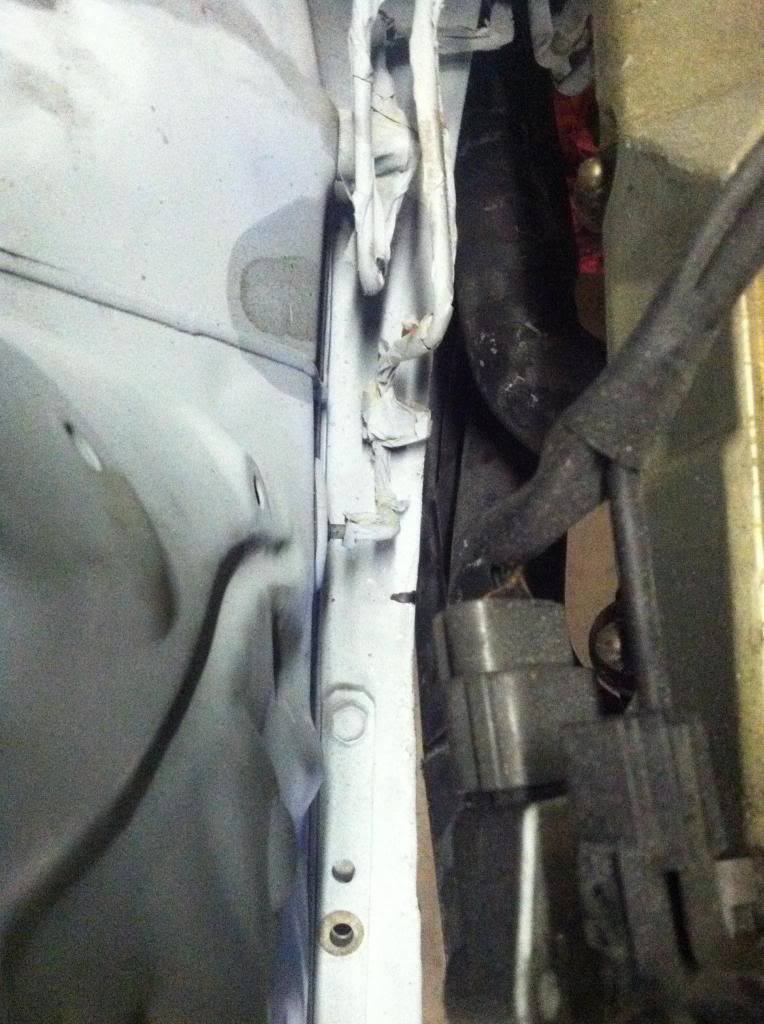

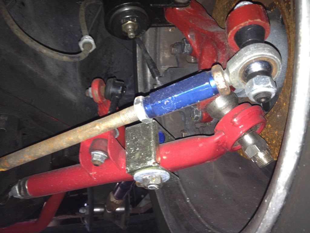

I threw her up on the lift to install some sway bar spacers so the sway bar will clear the oil pan.
I didn't realize how close the Cusco sway bar and the SPL tension rods would be tho. Both of them are quite thicker than stock parts so I guess they didn't plan on that combo. Either way this is just a temporary solution to clear the sway bar and oil pan for now.

Since the header was hitting on the pass side I had to grind a chunk out of the crossmember, so some grinding was in order... It took about another day or two or working on it here and there but the engine was eventually bolted in all the way and the car was on the ground holding her own weight!

Bought some Varrstoen es2's. 18x9.5 & 18x10.5. Nothing crazy but better than the xxr's, and now they can be added to the pile of drift spares.
Heres a pic of how it sits now after putting on the rims and lowering it a little...

Any pictures of how low off the floor the headers sit?
Thanks in advance
